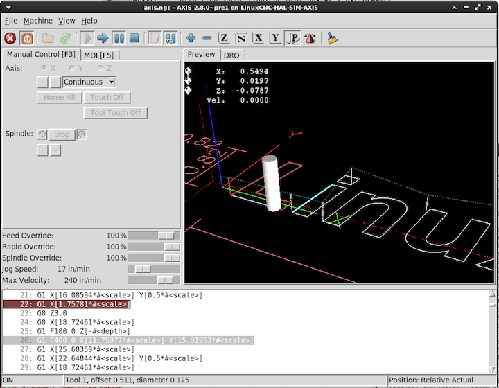

AXIS is a graphical front-end for LinuxCNC which features a live preview and backplot. It is written in Python and uses Tk and OpenGL to display its user interface.
AXIS main window

When AXIS starts, a window like the one in the figure [fig:axis-window] above opens.

3. AXIS Window
The AXIS window contains the following elements:
  • A display area that shows one of the following:
    • A preview of the loaded file (in this case, axis.ngc), as well as the current location of the CNC machine’s controlled point. Later, this area will display the path the CNC machine has moved through, called the backplot.
    • A large readout showing the current position and all offsets.
  • A menu bar and toolbar that allow you to perform various actions
  • Manual Control Tab - which allows you to make the machine move, turn the spindle on or off, and turn the coolant on or off if included in the INI file.

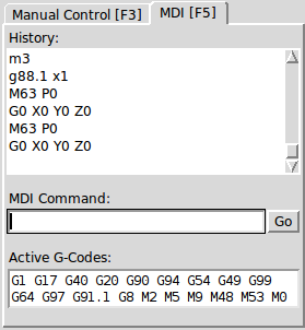

  • MDI Tab - where G-code programs can be entered manually, one line at a time. This also shows the Active G-codes which shows which modal G-codes are in effect.
  • Feed Override - which allows you to scale the speed of programmed motions. The default maximum is 120% and can be set to a different value in the INI file. See the Display Section of the INI file for more information.
  • Spindle Override - which allows you to scale the spindle speed up or down.
  • Jog Speed - which allows you to set the jog speed within the limits set in the INI file. See the Display Section of the INI file for more information.
  • Max Velocity - which allows you to restrict the maximum velocity of all programmed motions (except spindle synchronized motion).
  • A text display area that shows the loaded G-code.
  • A status bar which shows the state of the machine. In this screen shot, the machine is turned on, does not have a tool inserted, and the displayed position is Relative (showing all offsets), and Actual (showing feedback position).

  • Clear MDI history - Clears the MDI history window.
  • Copy from MDI history - Copies the MDI history to the clipboard
  • Paste to MDI history - Paste from the clipboard to the MDI history window

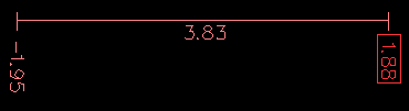

Program Extents
The extents of the program in each axis are shown. At the ends, the least and greatest coordinate values are indicated. In the middle, the difference between the coordinates is shown.
When some coordinates exceed the soft limits in the INI file, the relevant dimension is shown in a different color and enclosed by a box. In figure below the maximum soft limit is exceeded on the X axis as indicated by the box surrounding the coordinate value. The minimum X travel of the program is -1.95, the maximum X travel is 1.88, and the program requires 3.83 inches of X travel. To move the program so it’s within the machine’s travel in this case, jog to the left and Touch Off X again.

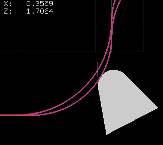

Tool Cone
When no tool is loaded, the location of the tip of the tool is indicated by the tool cone. The tool cone does not provide guidance on the form, length, or radius of the tool.
When a tool is loaded (for instance, with the MDI command T1 M6 ), the cone changes to a cylinder which shows the diameter of the tool given in the tool table file.

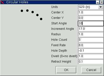

In this way, any Python script can be opened, and its output is treated as G-code. One such example script is available at nc_files/holecircle.py. This script creates G-code for drilling a series of holes along the circumference of a circle.
Circular Holes
If the environment variable AXIS_PROGRESS_BAR is set, then lines written to stderr of the form
FILTER_PROGRESS=%d
will set the AXIS progress bar to the given percentage. This feature should be used by any filter that runs for a long time.
