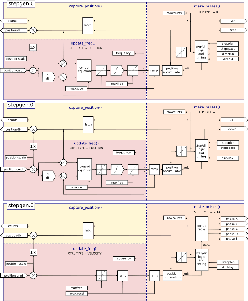

1. StepGen
This component provides software based generation of step pulses in response to position or velocity commands. In position mode, it has a built in pre-tuned position loop, so PID tuning is not required. In velocity mode, it drives a motor at the commanded speed, while obeying velocity and acceleration limits. It is a realtime component only, and depending on CPU speed, etc., is capable of maximum step rates of 10 kHz to perhaps 50 kHz. The step pulse generator block diagram shows three block diagrams, each is a single step pulse generator. The first diagram is for step type 0, (step and direction). The second is for step type 1 (up/down, or pseudo-PWM), and the third is for step types 2 through 14 (various stepping patterns). The first two diagrams show position mode control, and the third one shows velocity mode. Control mode and step type are set independently, and any combination can be selected.
images/stepgen-block-diag.png
Figure 1. Step Pulse Generator Block Diagram position mode

1.1. Pins
On the step type and control type selected.
  • (float) stepgen.`__<chan>__.position-cmd` - Desired motor position, in position units (position mode only).
  • (float) stepgen.`__<chan>__.velocity-cmd` - Desired motor velocity, in position units per second (velocity mode only).
  • s32) stepgen.`__<chan>__.counts` - Feedback position in counts, updated by capture_position().
  • (float) stepgen.`__<chan>__.position-fb` - Feedback position in position units, updated by capture_position().
  • (bit) stepgen.`__<chan>__.enable` - Enables output steps - when false, no steps are generated.
  • (bit) stepgen.`__<chan>__.step` - Step pulse output (step type 0 only).
  • (bit) stepgen.`__<chan>__.dir` - Direction output (step type 0 only).
  • (bit) stepgen.`__<chan>__.up` - UP pseudo-PWM output (step type 1 only).
  • (bit) stepgen.`__<chan>__.down` - DOWN pseudo-PWM output (step type 1 only).
  • (bit) stepgen.`__<chan>__.phase-A` - Phase A output (step types 2-14 only).
  • (bit) stepgen.`__<chan>__.phase-B` - Phase B output (step types 2-14 only).
  • (bit) stepgen.`__<chan>__.phase-C` - Phase C output (step types 3-14 only).
  • (bit) stepgen.`__<chan>__.phase-D` - Phase D output (step types 5-14 only).
  • (bit) stepgen.`__<chan>__.phase-E` - Phase E output (step types 11-14 only).

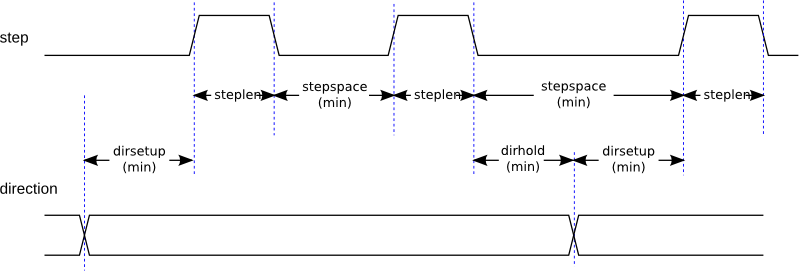

Step type 0 is the standard step and direction type. When configured for step type 0, there are four extra parameters that determine the exact timing of the step and direction signals. In the following figure the meaning of these parameters is shown. The parameters are in nanoseconds, but will be rounded up to an integer multiple of the thread period for the threaed that calls make_pulses(). For example, if make_pulses() is called every 16 µs, and steplen is 20000, then the step pulses will be 2 x 16 = 32 µs long. The default value for all four of the parameters is 1 ns, but the automatic rounding takes effect the first time the code runs. Since one step requires steplen ns high and stepspace ns low, the maximum frequency is 1,000,000,000 divided by (steplen + stepspace)'. If maxfreq is set higher than that limit, it will be lowered automatically. If maxfreq is zero, it will remain zero, but the output frequency will still be limited.
When using the parallel port driver the step frequency can be doubled using the parport reset function together with StepGen’s doublefreq setting.
images/stepgen-type0.png
Figure 2. Step and Direction Timing

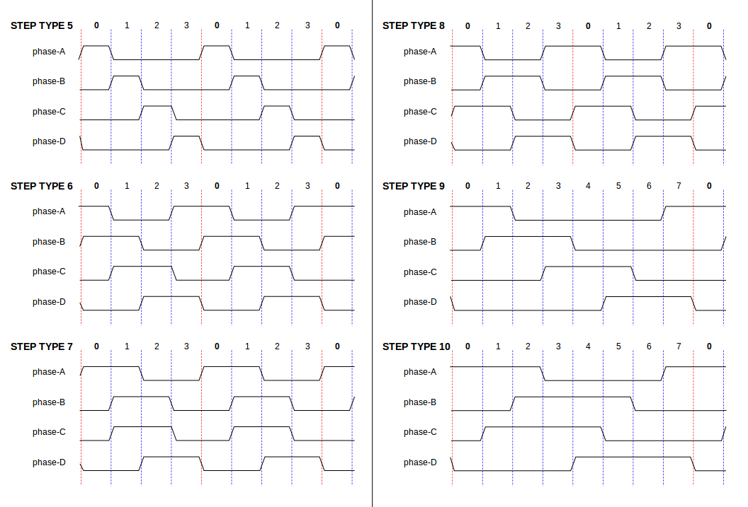

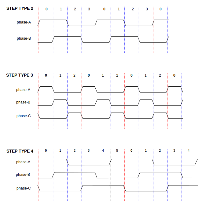

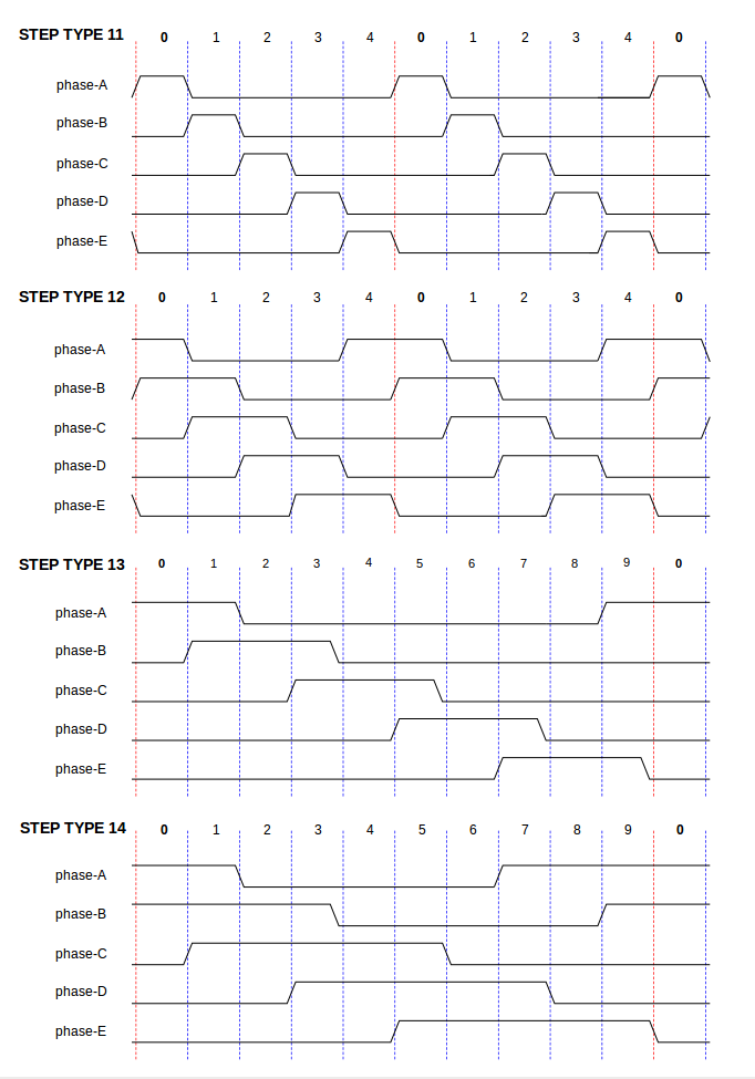

Step Type 2 - 14
Step types 2 through 14 are state based, and have from two to five outputs. On each step, a state counter is incremented or decremented. The Two-and-Three-Phase, Four-Phase, and Five-Phase show the output patterns as a function of the state counter. The maximum frequency is 1,000,000,000 divided by steplen, and as in the other modes, maxfreq will be lowered if it is above the limit.
.Two-and-Three-Phase Step Types Step Types: Two-and-Three-Phase
.Four-Phase Step Types Step Types: Four-Phase
.Five-Phase Step Types Step Types: Five-Phase
1.4. Functions
The component exports three functions. Each function acts on all of the step pulse generators - running different generators in different threads is not supported.
  • (funct) stepgen.make-pulses - High speed function to generate and count pulses (no floating point).
  • (funct) stepgen.update-freq - Low speed function does position to velocity conversion, scaling and limiting.
  • (funct) stepgen.capture-position - Low speed function for feedback, updates latches and scales position.
The high speed function stepgen.make-pulses should be run in a very fast thread, from 10 to 50 µs depending on the capabilities of the computer. That thread’s period determines the maximum step frequency, since steplen, stepspace, dirsetup, dirhold, and dirdelay are all rounded up to a integer multiple of the thread periond in nanoseconds. The other two functions can be called at a much lower rate.

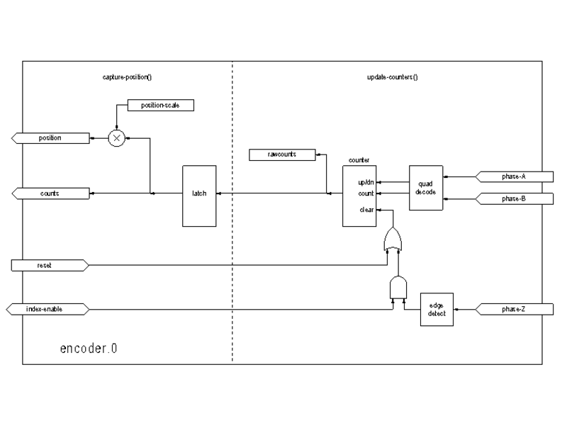

3. Encoder
This component provides software based counting of signals from quadrature (or single-pulse) encoders. It is a realtime component only, and depending on CPU speed, latency, etc., is capable of maximum count rates of 10 kHz to perhaps up to 50 kHz.
The base thread should be 1/2 count speed to allow for noise and timing variation. For example if you have a 100 pulse per revolution encoder on the spindle and your maximum RPM is 3000 the maximum base thread should be 25 µs. A 100 pulse per revolution encoder will have 400 counts. The spindle speed of 3000 RPM = 50 RPS (revolutions per second). 400 * 50 = 20,000 counts per second or 50 µs between counts.
The Encoder Counter Block Diagram is a block diagram of one channel of an encoder counter.
images/encoder-block-diag.png
Figure 3. Encoder Counter Block Diagram

3.1. Pins
  • encoder._<chan>_.counter-mode (bit, I/O) (default: FALSE) - Enables counter mode. When true, the counter counts each rising edge of the phase-A input, ignoring the value on phase-B. This is useful for counting the output of a single channel (non-quadrature) sensor. When false, it counts in quadrature mode.
  • encoder._<chan>_.missing-teeth (s32, In) (default: 0) - Enables the use of missing-tooth index. This allows a single IO pin to provide both position and index information. If the encoder wheel has 58 teeth with two missing, spaced as if there were 60(common for automotive crank sensors) then the position-scale should be set to 60 and missing-teeth to 2. To use this mode counter-mode should be set true. This mode will work for lathe threading but not for rigid tapping.
  • encoder._<chan>_.counts (s32, Out) - Position in encoder counts.
  • encoder._<chan>_.counts-latched (s32, Out) - Not used at this time.
  • encoder._<chan>_.index-enable (bit, I/O) - When True, counts and position are reset to zero on next rising edge of Phase Z.
    At the same time, index-enable is reset to zero to indicate that the rising edge has occurred. The index-enable pin is bi-directional. If index-enable is False, the Phase Z channel of the encoder will be ignored, and the counter will count normally. The encoder driver will never set index-enable True. However, some other component may do so.
  • encoder._<chan>_.latch-falling (bit, In) (default: TRUE) - Not used at this time.
  • encoder._<chan>_.latch-input (bit, In) (default: TRUE) - Not used at this time.
  • encoder._<chan>_.latch-rising (bit, In) - Not used at this time.
  • encoder._<chan>_.min-speed-estimate (float, in) - Determine the minimum true velocity magnitude, at which velocity will be estimated as nonzero and position-interpolated will be interpolated. The units of min-speed-estimate are the same as the units of velocity. Scale factor, in counts per length unit. Setting this parameter too low will cause it to take a long time for velocity to go to 0 after encoder pulses have stopped arriving.
  • encoder._<chan>_.phase-A (bit, In) - Phase A of the quadrature encoder signal.
  • encoder._<chan>_.phase-B (bit, In) - Phase B of the quadrature encoder signal.
  • encoder._<chan>_.phase-Z (bit, In) - Phase Z (index pulse) of the quadrature encoder signal.
  • encoder._<chan>_.position (float, Out) - Position in scaled units (see position-scale).
  • encoder._<chan>_.position-interpolated (float, Out) - Position in scaled units, interpolated between encoder counts.
    The position-interpolated attempts to interpolate between encoder counts, based on the most recently measured velocity. Only valid when velocity is approximately constant and above min-speed-estimate. Do not use for position control, since its value is incorrect at low speeds, during direction reversals, and during speed changes.
    However, it allows a low ppr encoder (including a one pulse per revolution encoder) to be used for lathe threading, and may have other uses as well.
  • encoder._<chan>_.position-latched (float, Out) - Not used at this time.
  • encoder._<chan>_.position-scale (float, I/O) - Scale factor, in counts per length unit. For example, if position-scale is 500, then 1000 counts of the encoder will be reported as a position of 2.0 units.
  • encoder._<chan>_.rawcounts (s32, In) - The raw count, as determined by update-counters. This value is updated more frequently than counts and position. It is also unaffected by reset or the index pulse.
  • encoder._<chan>_.reset (bit, In) - When True, force counts and position to zero immediately.
  • encoder._<chan>_.velocity (float, Out) - Velocity in scaled units per second. encoder uses an algorithm that greatly reduces quantization noise as compared to simply differentiating the position output. When the magnitude of the true velocity is below min-speed-estimate, the velocity output is 0.
  • encoder._<chan>_.x4-mode (bit, I/O) (default: TRUE) - Enables times-4 mode. When true, the counter counts each edge of the quadrature waveform (four counts per full cycle). When false, it only counts once per full cycle. In counter-mode, this parameter is ignored. The 1x mode is useful for some jogwheels.
3.2. Parameters
  • encoder._<chan>_.capture-position.time (s32, RO)
  • encoder._<chan>_.capture-position.tmax (s32, RW)
  • encoder._<chan>_.update-counters.time (s32, RO)
  • encoder._<chan>_.update-counter.tmax (s32, RW)
3.3. Functions
The component exports two functions. Each function acts on all of the encoder counters - running different counters in different threads is not supported.
  • (funct) encoder.update-counters - High speed function to count pulses (no floating point).
  • (funct) encoder.capture-position - Low speed function to update latches and scale position.

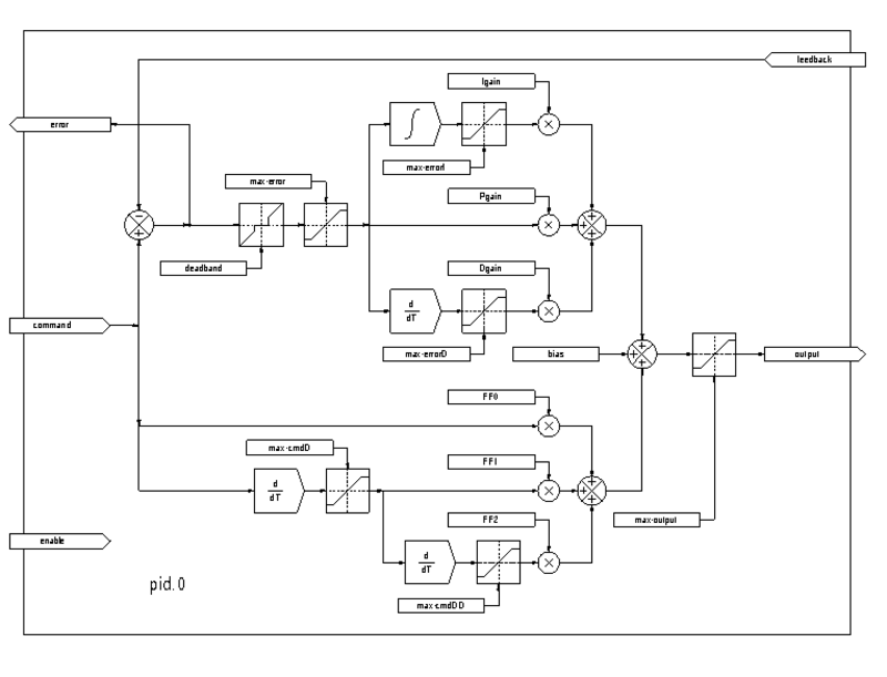

4. PID
This component provides Proportional/Integral/Derivative control loops. It is a realtime component only. For simplicity, this discussion assumes that we are talking about position loops, however this component can be used to implement other feedback loops such as speed, torch height, temperature, etc. The PID Loop Block Diagram is a block diagram of a single PID loop.
images/pid-block-diag.png
Figure 4. PID Loop Block Diagram

4.1. Pins
The three most important pins are
  • (float) pid.`__<loopnum>__.command` - The desired position, as commanded by another system component.
  • (float) pid.`__<loopnum>__.feedback` - The present position, as measured by a feedback device such as an encoder.
  • (float) pid.`__<loopnum>__.output` - A velocity command that attempts to move from the present position to the desired position.
For a position loop, .command and .feedback are in position units. For a linear axis, this could be inches, mm, meters, or whatever is relevant. Likewise, for an angular axis, it could be degrees, radians, etc. The units of the .output pin represent the change needed to make the feedback match the command. As such, for a position loop .output is a velocity, in inches/s, mm/s, degrees/s, etc. Time units are always seconds, and the velocity units match the position units. If command and feedback are in meters, then output is in meters per second.
Each loop has two pins which are used to monitor or control the general operation of the component.
  • (float) pid.<loopnum>.error - Equals .command minus .feedback.
  • (bit) pid.<loopnum>.enable - A bit that enables the loop. If .enable is false, all integrators are reset, and the output is forced to zero. If .enable is true, the loop operates normally.
Pins used to report saturation. Saturation occurs when the output of the PID block is at its maximum or minimum limit.
  • (bit) pid.<loopnum>.saturated - True when output is saturated.
  • (float) pid.<loopnum>.saturated_s - The time the output has been saturated.
  • (s32) pid.<loopnum>.saturated_count - The time the output has been saturated.
