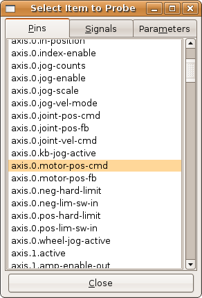

2. Halmeter
Halmeter is a voltmeter for the HAL. It lets you look at a pin, signal, or parameter, and displays the current value of that item. It is pretty simple to use. Start it by typing halmeter in an X windows shell. Halmeter is a GUI application. It will pop up a small window, with two buttons labeled "Select" and "Exit". Exit is easy - it shuts down the program. Select pops up a larger window, with three tabs. One tab lists all the pins currently defined in the HAL. The next lists all the signals, and the last tab lists all the parameters. Click on a tab, then click on a pin/signal/parameter. Then click on "OK". The lists will disappear, and the small window will display the name and value of the selected item. The display is updated approximately 10 times per second. If you click "Accept" instead of "OK", the small window will display the name and value of the selected item, but the large window will remain on the screen. This is convenient if you want to look at a number of different items quickly.
You can have many halmeters running at the same time, if you want to monitor several items. If you want to launch a halmeter without tying up a shell window, type halmeter & to run it in the background. You can also make halmeter start displaying a specific item immediately, by adding pin|sig|par[am] _<name>_ to the command line. It will display the pin, signal, or parameter <name> as soon as it starts - if there is no such item, it will simply start normally. And finally, if you specify an item to display, you can add -s before the pin|sig|param to tell halmeter to use a small window. The item name will be displayed in the title bar instead of under the value, and there will be no buttons. Useful when you want a lot of meters in a small amount of screen space.
Weitere Informationen finden Sie im Abschnitt Halmeter Tutorial.
halmeter can be loaded from a terminal or from AXIS. halmeter is faster than halshow at displaying values. halmeter has two windows, one to pick the pin, signal, or parameter to monitor and one that displays the value. Multiple ``halmeter``s can be open at the same time. If you use a script to open multiple ``halmeter``s you can set the position of each one with -g X Y relative to the upper left corner of your screen. For example:
loadusr halmeter pin hm2.0.stepgen.00.velocity-fb -g 0 500
Siehe die Manpage für weitere Optionen und den Abschnitt Halmeter.
Halmeter-Auswahlfenster
Abbildung 1. Halmeter-Auswahlfenster
Halmeter-Watch Fenster
Abbildung 2. Halmeter-Watch Fenster

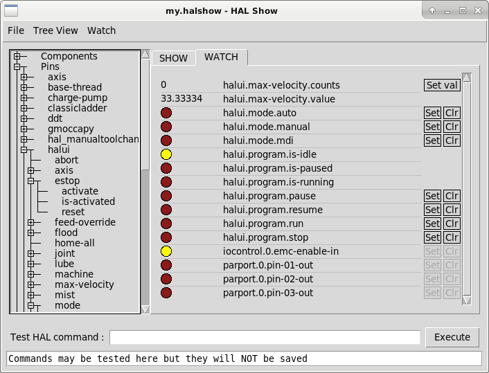

Halshow Watch Tab
Abbildung 3. Halshow Watch Tab
A watchfile created using the File/Save Watch List menu item is formatted as a single line with tokens "pin+", "param+", "sig=+", followed by the appropriate pin, param, or signal name. The token-name pairs are separated by a space character.
Einzeiliges Watchfile-Beispiel
pin+joint.0.pos-hard-limit pin+joint.1.pos-hard-limit sig+estop-loop
Eine Überwachungsdatei, die mit dem Menüpunkt Datei/Beobachtungsliste speichern (mehrzeilig) erstellt wurde, wird mit separaten Zeilen für jedes Element formatiert, das wie oben beschrieben mit Token-Name-Paaren identifiziert wird.

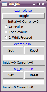

5. Sim-Pin
sim_pin ist ein Kommandozeilenprogramm zur Anzeige und Aktualisierung einer beliebigen Anzahl von beschreibbaren Pins, Parametern oder Signalen.
sim_pin Usage
Usage:
        sim_pin [Options] name1 [name2 ...] &
Options:
        --help                (this text)
        --title title_string  (window title, default: sim_pin)
Note:  LinuxCNC (or a standalone HAL application) must be running
        A named item can specify a pin, param, or signal
        The item must be writable, e.g.:
          pin:    IN or I/O (and not connected to a signal with a writer)
          param:  RW
          signal: connected to a writable pin
        HAL item types bit,s32,u32,float are supported.
        When a bit item is specified, a pushbutton is created
        to manage the item in one of three manners specified
        by radio buttons:
            toggle: Toggle value when button pressed
            pulse:  Pulse item to 1 once when button pressed
            hold:   Set to 1 while button pressed
        The bit pushbutton mode can be specified on the command
        line by formatting the item name:
            namei/mode=[toggle | pulse | hold]
        If the mode begins with an uppercase letter, the radio
        buttons for selecting other modes are not shown
Vollständige Informationen finden Sie in der Manpage:
man sim_pin
sim_pin Example (with LinuxCNC running)
halcmd loadrt mux2 names=example; halcmd net sig_example example.in0
sim_pin example.sel example.in1 sig_example &
sim_pin Fenster
Abbildung 4. sim_pin Fenster

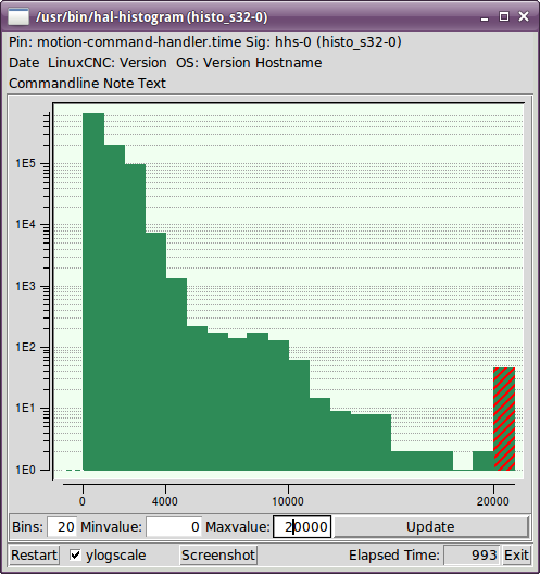

7. HAL Histogramm
hal-histogram ist ein Kommandozeilenprogramm zur Anzeige von Histogrammen für HAL-Pins.
Nutzung:
   hal-histogram --help | -?
or
   hal-histogram [Optionen] [Pinname]
Tabelle 1. Optionen:
Option Wert Beschreibung
--minvalue
minvalue
minimum bin, Voreinstellung: 0
--binsize
binsize
binsize, Voreinstellung: 100
--nbins
nbins
Anzahl der Bins, Standard: 50
--logscale
0/1
y-Achse logarithmische Skala, Voreintellung: 1
--text
Hinweis
Textanzeige, Standard: ""
-show
Anzahl der nicht angezeigten nbins anzeigen, Voreinstellung aus
--verbose
Fortschritt und Fehlersuche, standardmäßig aus
Anmerkungen:
  1. LinuxCNC (oder eine andere HAL-Anwendung) muss laufen.
  2. If no pinname is specified, default is: motion-command-handler.time.
  3. Diese App kann für 5 Pins geöffnet werden.
  4. Unterstützt werden die Pintypen float, s32, u32, bit.
  5. The pin must be associated with a thread supporting floating point. For a base thread, this may require using loadrt motmod ... base_thread_fp=1 .
hal-histogram Fenster
Abbildung 6. hal-histogram Fenster
