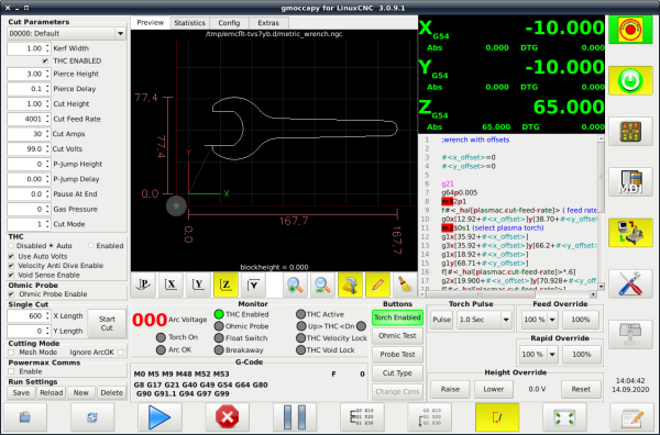

PlasmaC is a plasma cutting configuration that is loaded on top of LinuxCNC v2.8 or later. It includes a HAL component plus GUI configurations for both Axis and Gmoccapy. There is also an option to have the Axis GUI display in portrait mode, see Axis <machine_name>.ini file.
The desired LinuxCNC GUI (Axis or Gmoccapy) with PlasmaC component loaded should be chosen prior to starting the LinuxCNC installation process as switching between Axis and Gmoccapy requires a fresh configuration to be created.
Screenshot examples of PlasmaC loaded on top of both the Axis and Gmoccapy GUIs are below:
AXIS:
width=100%
GMOCCAPY:
width=100%

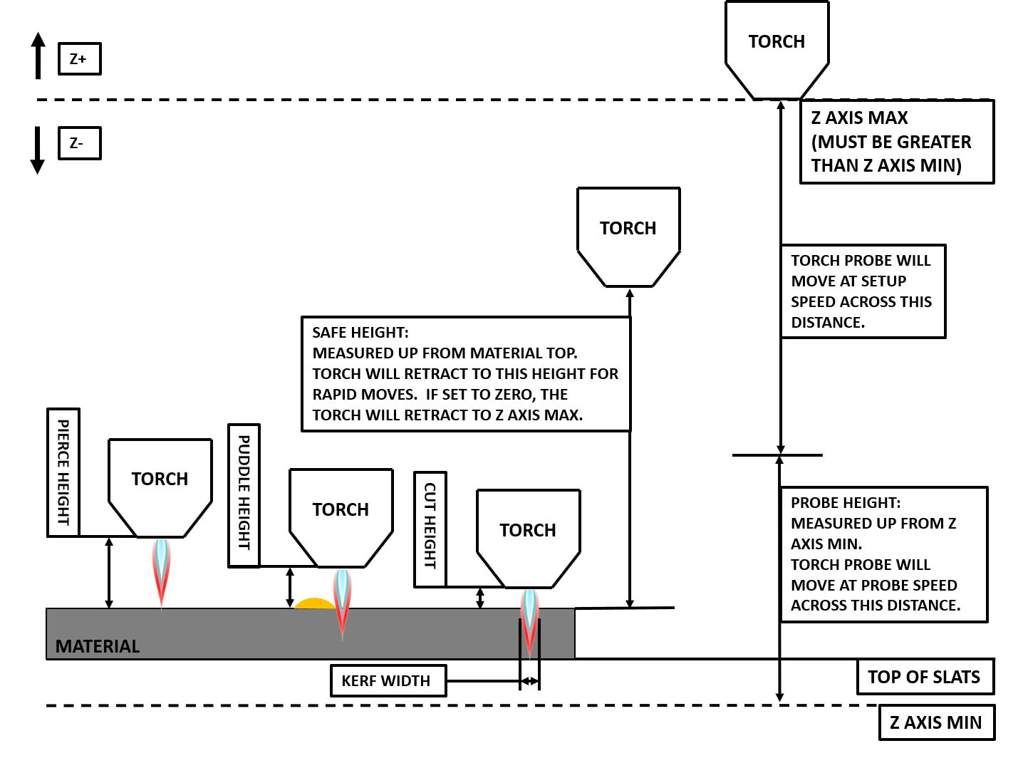

Some recommended settings:
  • Z MINIMUM_LIMIT should be just below top of the slats with allowances for float_switch_travel and over travel tolerance. For example, if the user’s float switch takes 4mm (0.157") to activate then set the Z minimum to 5mm (0.197") plus an allowance for overrun (as calculated using the equation below) below the lowest slat.
  • Z MAXIMUM_LIMIT should be the highest the user wants the Z axis to travel (it must not be lower than Z HOME_OFFSET).
  • Z HOME should be set to be approximately 5mm (0.196") below the maximum limit.
  • Floating Head - it is recommended that a floating head be used and that it has enough movement to allow for overrun during probing. Overrun can be calculated using the following formula:
o = 0.5 × a × (v ÷ a)^2
where: o = overrun, a = acceleration in units/sec2 and v = velocity in units/sec.
Metric example: given a Z axis MAX_ACCELERATION of 600mm/s2 and MAX_VELOCITY of 60mm/s, the overrun would be 3mm.
Imperial example: given a Z axis MAX_ACCELERATION of 24in/s2 and MAX_VELOCITY of 2.4in/s, the overrun would be 0.12in.
On machines that will utilize an ohmic probe as the primary method of probing, it is highly recommended to install a switch on the floating head as a backup means of stopping Z motion in the event of ohmic probe failure due to dirty surfaces.

Only one of either Float Switch or Ohmic Probe is required. If both are used then Float Switch will be a fallback if Ohmic Probe is not sensed.
If Ohmic Probe is used then Ohmic Probe Enable is required to be checked on the PlasmaC GUI.
Breakaway Switch is not mandatory because Float Switch is treated the same as a breakaway when not probing. If they are two separate switches, and there are not enough inputs on the breakout board, they could be combined and connected as a Float Switch.

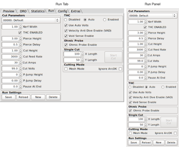

Run Panel
Run Tab - Selecting this option places the PlasmaC run frame in a tab behind the preview tab.
Run Panel - Selecting this option places the PlasmaC run frame in a panel at the side of the GUI.
See Run Panel for an example of each.

5.2. Initial Setup
The following heights diagram will help the user visualize the different heights involved in plasma cutting and how they are measured:
images/plasmac_heights_diagram.png
After running the command at the end of section 5.1, LinuxCNC should be running with the PlasmaC panels visible.
Click on the Config tab to open the Config Panel and ensure every one of these settings is tailored to the machine.
To set the Z axis DRO relative to the Z axis MINIMUM_LIMIT, the user should perform the following steps. It is important to understand that in PlasmaC, touching off the Z axis DRO has no effect on the Z axis position while running a G-Code program. These steps simply allow the user to more easily set the probe height as after performing the steps, the displayed Z axis DRO value will be relative to Z axis MINIMUM_LIMIT.
  1. The user should be familiar with the recommended Z Axis Settings
  2. Home the Z axis.
  3. Ensure there is nothing below the torch then jog the Z axis down until it stops at the Z axis MINIMUM_LIMIT then click Touch Off with the Z axis selected to set the Z axis at zero offset.
  4. Home the Z axis again.
If the machine is equipped with a float switch then the user will need to set the offset in the Config Panel. This will be done by running a "Probe Test" cycle.
  1. Check that the Probe Speed and the Probe Height in the Config Panel are correct. PlasmaC can probe at the full Z axis velocity so long as the machine has enough movement in the float switch to absorb any overrun. If the machine is suitable, the user could set the Probe Height to a value near the Z axis minimum and do all probing at full speed.
  2. If the machine is not already homed and in the home position, Home the machine.
  3. Place some material on the slats under the torch.
  4. Press the Probe Test button.
  5. The Z axis will probe down, find the material then move up to the specified Pierce Height as set by the currently selected material. The torch will wait in this position for the time set in the <machine_name>.ini file. The default probe test hold time is 30 seconds, this value may be edited in the <machine_name>.ini file. After this the torch will return to the starting height.
  6. Measure the distance between the material and the tip of the torch while the torch is waiting at Pierce Height.
  7. If the measurement is greater than the Pierce Height of the currently selected material, then reduce the "Float Travel" on the Config Panel by the difference between the measured value and the specified value. If the measurement is less than Pierce Height of the currently selected material, then increase the "Float Travel" on the Config Panel by the difference between the specified value and the measured value.
  8. After the adjustments to the "Float Travel" have been made, repeat the process from #4 above until the measured distance between the material and the torch tip matches the Pierce Height of the currently selected material.

6.5.3. Gmoccapy GUI Specific
[DISPLAY] section
EMBED_TAB_NAME     = plasmac_buttons
EMBED_TAB_LOCATION = box_cooling
EMBED_TAB_COMMAND  = gladevcp -c plasmac_buttons -x <XID> -u ./plasmac/plasmac_buttons.py -H ./plasmac/plasmac_buttons.hal ./plasmac/plasmac_buttons.glade
EMBED_TAB_NAME     = plasmac_control
EMBED_TAB_LOCATION = box_spindle
EMBED_TAB_COMMAND  = gladevcp -c plasmac_control -x <XID> -u ./plasmac/plasmac_control.py -H ./plasmac/plasmac_control.hal ./plasmac/plasmac_control.glade
EMBED_TAB_NAME     = Statistics
EMBED_TAB_COMMAND  = gladevcp -c plasmac_stats -x <XID> -u ./plasmac/plasmac_stats.py -H ./plasmac/plasmac_stats.hal ./plasmac/plasmac_stats.glade
EMBED_TAB_NAME     = Plasma Run
#use one of the next two
#run panel in tab behind preview
EMBED_TAB_LOCATION  = ntb_preview
EMBED_TAB_COMMAND   = gladevcp -c plasmac_run -x <XID> -u ./plasmac/plasmac_run.py -H ./plasmac/plasmac_run.hal ./plasmac/plasmac_run_tab.glade
#run panel in panel on left side
#EMBED_TAB_LOCATION = box_left
#EMBED_TAB_COMMAND  = gladevcp -c plasmac_run -x <XID> -u ./plasmac/plasmac_run.py -H ./plasmac/plasmac_run.hal ./plasmac/plasmac_run_panel.glade
EMBED_TAB_NAME     = Plasma Config
EMBED_TAB_COMMAND  = gladevcp -c plasmac_config -x <XID> -u ./plasmac/plasmac_config.py -H ./plasmac/plasmac_config.hal ./plasmac/plasmac_config.glade
EMBED_TAB_NAME     = plasmac_monitor
EMBED_TAB_LOCATION = box_tool_and_code_info
EMBED_TAB_COMMAND  = gladevcp -c plasmac_monitor -x <XID> -u ./plasmac/plasmac_monitor.py -H ./plasmac/plasmac_monitor.hal ./plasmac/plasmac_monitor.glade
EMBED_TAB_NAME     = Extras
EMBED_TAB_COMMAND  = gladevcp -c plasmac_wizards -x {XID} -u ./plasmac/plasmac_wizards.py ./plasmac/plasmac_wizards.glade
The Run Window can be displayed as either:
  1. A panel on the left side of the Gmoccapy GUI which is suitable for widescreen displays.
  2. A tab behind the Preview tab which is suitable for 4:3 ratio displays.

7.1.2. Run Panel
This panel shows the parameters which are active for the current cut.
There are two formats for this panel, a tab that sits behind the preview tab or a panel at the right side of the GUI. The formats are different but both provide the same functionality for controlling cut parameters.
width=70%
See Axis [DISPLAY] Section or Gmoccapy [DISPLAY] section for information on how to change between the two formats in the <machine_name>.ini files. Alternatively, the user could run the configurator again to select a different option.
Cut Parameters
Name
Description
Material
The top drop down menu is used to manually select the current material cut parameters. If there are no materials in the material file then only the default material will be displayed.
Kerf Width
This sets the kerf width for the currently selected material.

Cut Mode
This sets the cut mode for the currently selected material.
This setting is only valid if PowerMax communications are being used.
1 = Normal

Run Settings
Name
Description

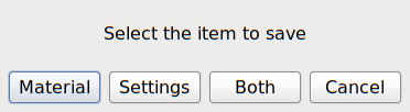

Save
This button will bring up a dialog box with the following options:
Material - This button will save the Cut Parameters for the material currently displayed.
Settings - This button will save the THC, Ohmic Probe, Single Cut, Cutting Mode, and PowerMax Communications settings. It will not save the settings in the Cut Parameters section.
Both - This button will save all of the settings displayed in the Run Panel.
Cancel - This button will close the dialog box without saving.
Reload
This button will reload all of the displayed settings in the Run Panel, and will re-display the currently selected material. Regardless of the previously saved settings, if PowerMax communications are enabled before pressing Reload, they will remain enabled after.
New
This button will allow a new material to be added to the material file. The user will be prompted for a material number and a material name, all other parameters will be read from the currently selected material. Once entered, PlasmaC will reload the material file and display the new material. The Cut Parameters for the new material will then need to be adjusted and saved.
Delete
This button is used to delete a material. After pressing it, the user will be prompted for a material number to be deleted, and prompted again to ensure the user is sure. After deletion, the material file will be reloaded and the drop down list will display the default material.
An example of the Save dialog box is below:

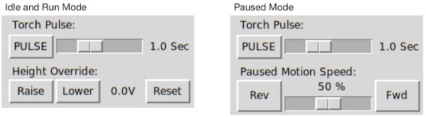

7.1.5. Control Panel
The Control Panel allows the user to pulse the torch for a desired period of time, manually override the height control, and manipulate the machine during paused motion at a desired speed. Both Axis and Gmoccapy are similar except the Gmoccapy Control Panel is integrated into the existing frame containing feed and rapid overrides.
Once the machine is homed, Torch Pulse and Height Override are shown permanently in Idle and Run Modes. Paused Motion Speed will be enabled if the machine enters Paused Mode. Examples of the different states are shown below.
Axis Control Panel:
width=40%
Gmoccapy Control Panel:
width=40%
Torch Pulse
Name
Description
Pulse
This button will pulse the torch.
Pulse Time Slider
This slider will set the amount of time (in seconds) that the torch remains on when pulsed.
Height Override
Name
Description
Raise
Each press of this button will raise the height of the torch by the value set by the Height Per Volt field in the Arc frame of the Config Panel.
Lower
Each press of this button will lower the height of the torch by the value set by the Height Per Volt field in the Arc frame of the Config Panel.
Reset
This button will cancel any manual height override.
Paused Motion Speed
In the event of a paused program, this interface allows X/Y motion to follow the programmed path in the reverse or forward direction.
Name
Description
Rev
In the event of a paused program, this button will move the machine in reverse along the programmed path until it reaches the last M3 command that was either executed or that PlasmaC was attempting to execute before the program became paused.
Motion Speed Slider
This slider will set the percentage of the current Cut Feed Rate shown in the Run Panel’s Cut Parameters section for the currently selected material.
Fwd
In the event of a paused program, this button will move the machine forward along the programmed path indefinitely until the program’s end, skipping over M3 commands.
For advanced recovery from a failed cut see cut recovery.

The THC can be controlled from the THC frame of the Run Panel.
The THC can also be enabled or disabled directly from the G-Code program provided that THC is not disabled in the THC section of the Run Panel.

Probing may be done with either ohmic sensing or a float switch. It is also possible to combine the two methods, in which case the float switch will provide a fallback to ohmic probing.
If the machine’s torch does not support ohmic probing, the user could have a separate probe next to the torch. In this case the user would extend the probe below the torch. The probe must NOT extend more than the minimum Cut Height below the torch and the Z axis offset distance needs to be entered as the ohmic-probe-offset in the Config Panel.
Probing setup is done in the Probing frame of the Config Panel. Probing speed is controlled in the Motion frame of the Config Panel.
PlasmaC can probe at the full Z axis velocity so long as the machine has enough movement in the float switch to absorb any overrun. If the machine’s float switch travel is suitable, the user could set the Probe Height to near the Z axis MINIMUM_LIMIT and do all probing at full speed.
Some float switches can exhibit a large switching hysteresis which shows up in the probing sequence as an excessive time to complete the final probe up.
  • This time may be decreased by changing the speed of the final probe up.
  • This speed defaults to 0.001mm (0.000039") per servo cycle.
  • It is possible to increase this speed by up to a factor of 10 by adding the following line to the <machine_name>_connections.hal file:
setp plasmac.probe-final-speed n
where n is a value from 1-10. It is recommended to keep this value as low as possible.
Using this feature will change the final height slightly and will require thorough probe testing to confirm the final height.
This speed value affects ALL probing so if the user uses ohmic probing and the user changes this speed value then the user will need to probe test to set the require offset to compensate for this speed change as well as the float travel.
The reliability of this feature will only be as good as the repeatability of the float switch.
Note
Probe Height refers to the height above the Z axis MINIMUM_LIMIT.

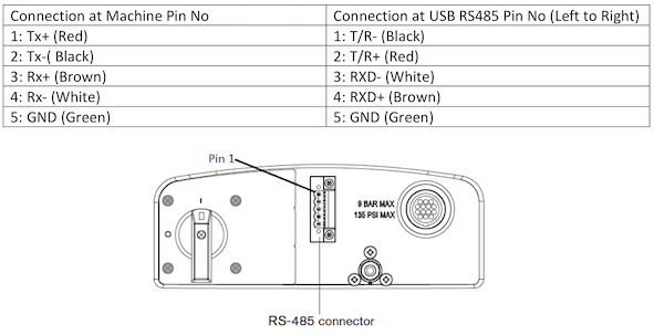

If the machine has RS485 communications enabled with a Hypertherm PowerMax plasma cutter, selecting Mesh Mode will disable the Cut Mode spinbutton in the Cut Parameters section of the Run Panel and it will select cut mode 2 (CPA). When Mesh Mode is disabled, the Cut Mode spinbutton will be re-enabled and the original cut mode will be restored.

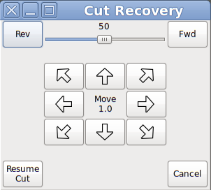

7.21. Cut Recovery
width=40%
This feature will produce a dialog box that will allow the torch to be moved away from the cut path during a paused motion event in order to position the torch over a scrap portion of the material being cut so that the cut restarts with a minimized arc-divot. This feature is only available from a user-programmed button (named Cut-Recovery by default) in the Extras panel and may only be clicked while motion is paused.
It is preferable to make torch position adjustments from the point at which paused motion occurred, however if moving along the cut path is necessary prior to setting the new start point, the user may use the paused motion controls (Rev, Fwd, and a jog-speed slider) at the top of the dialog box. Once the user is satisfied with the positioning of the torch along the cut path, moving off the cut path is achieved by pressing the direction buttons. Each press of the direction button will move the torch a distance equivalent to the Kerf Width parameter of the currently selected material.
The moment the torch has been moved off the cut path, the paused motion controls (Rev, Fwd, and a jog-speed slider) at the top of the dialog box will become disabled.
Once the torch position is satisfactory, press Resume Cut or the GUI’s Resume button (Pause symbol) and the cut will resume from the new position and travel the shortest distance to the original paused motion location. The dialog box will close when the torch returns to the original paused motion location.

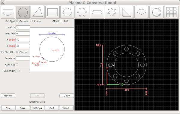

7.22. Conversational Shape Library
width=40%
The Conversational Shape Library consists of several basic shapes and functions to assist the user with generating quick G-Code at the machine to cut simple shapes quickly. This feature is started by clicking the Conversational button found in the Extras tab.
Note
The Conversational Library is not meant to be a CAD/CAM replacement as there are limitations to what can be achieved.
Blank entries in the shape input boxes will use the current setting at the time the G-Code was generated. For example, if X start was left blank then the current X axis position would be used.
All lead-ins and lead-outs are arcs except for:
  • Small holes
  • Stars
The cut order will occur in the same order as the shape was built.
Pressing Return on the keyboard while editing parameters will automatically show the preview of the shape if there are enough parameters entered to create the shape. Clicking any of the available check boxes will do the same.
The button functions are as follows:
Name
Description
New
Removes the current G-Code file and load a blank G-Code file.
Save
Opens a dialog allowing the current shape to be saved as a G-Code file.
Settings
Allows the changing of the global settings.
Quit
Closes the Conversational Panel. All edits will be discarded.
Send
Closes the Conversational Panel and load the current shape into LinuxCNC (PlasmaC). If the last edit was not added then it will be discarded.
Preview
Displays a preview of the current shape provided the required information is present.
Continue
This button is used for lines and arcs only. Allows another segment to be added to the current segment/segments.
Add
Stores the current shape into the current job.
Undo
Reverts to the previously stored state. If there have been no edits since the last store, it will stay at the current state.
If there is a G-Code file loaded in LinuxCNC (PlasmaC) when the Conversational Panel is opened, that code will be imported into the conversational as the first shape of the job. If this code is not required then it can be removed by pressing the New button.
Note
All distances are in machine units relative to the current User Coordinate System and all angles are in degrees.
7.22.1. Settings
Global settings for the shape library can be set by pressing the Settings button in the Conversational Panel. This will display all of the available settings parameters that are used for G-Code program creation. These include:
  • Preamble
  • Postamble
  • Origin (Center or Bottom Left)
  • Lead-in length
  • Lead-out length
  • Small hole diameter
  • Small hole speed
  • Window Size
Any internal circle that has a diameter less than Small hole diameter is classified as a small hole and will have a straight lead-in with a length that is the lesser of either the radius of the hole or the specified lead-in length. It will also have its feed rate set to Small hole speed.
Pressing the Save button will save all the settings as displayed and will change the window size to the displayed size.
After saving the user may press Quit or they may click on any shape to start the Conversational process.

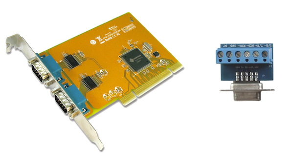

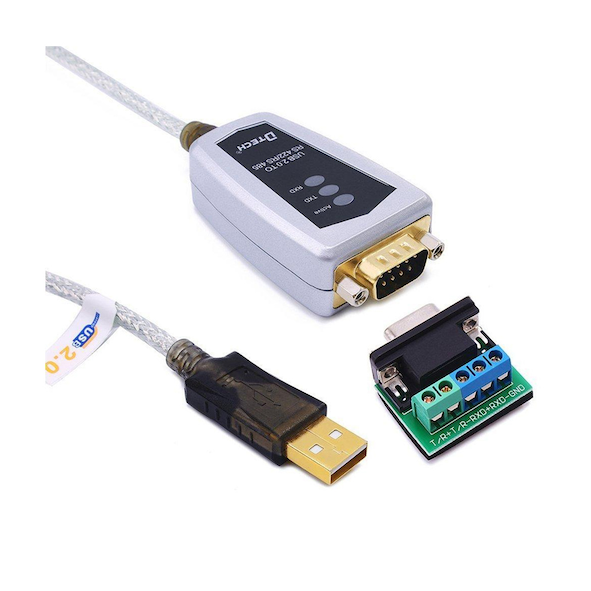

7.25. Hypertherm PowerMax Communications
Communications can be established with a Hypertherm PowerMax plasma cutter that has a RS485 port. This feature enables the setting of Cut Mode, Cutting Amperage and Gas Pressure automatically from the Cut Parameters of the material file.
If Gas Pressure is set to Zero then the PowerMax will automatically calculate the required pressure from the Cut Mode, Cut Current, torch type, and torch length.
Changing the cutting mode will set the gas pressure to zero causing the machine to use its automatic gas pressure mode.
The maximum and minimum values of these parameters are read from the plasma cutter and the related spin-buttons in the Cut Parameters are then limited by these values. Gas pressure can not be changed from zero until communications have been established.
This feature is enabled by setting the correct port name for the PM_PORT variable in the [PLASMAC] section of the <machine_name>.ini file. If the PM_PORT variable is not set in the <machine_name>.ini file then the widgets associated with this feature will not be visible.
Example showing enabling the Hypertherm PowerMax Communications on USB0:
[PLASMAC]
PM_PORT = /dev/ttyusb0
If the user is unsure of the name of the port, there is a python script in the configuration directory that will show all available ports and can also be used to test communications with the plasma unit prior to enabling this feature in the PlasmaC GUI.
To use the test script enter the following command into a terminal window:
python ~/<user_name>/linuxcnc/configs/<the_user_config>/pmx_test.py
The gas pressure units display (psi or bar) is determined by the data received during initial setup of the communication link and is then shown next to the Gas Pressure spinbutton on the Run Panel.
The PowerMax machine will go into remote mode after communications have been established and may only be controlled remotely (via the PlasmaC GUI) at this point. The connection can be validated by observing the PowerMax display.
To switch the PowerMax back to local mode the user can either:
  1. Disable PowerMax Comms from the Run panel
  2. Close LinuxCNC which will put the PowerMax into local mode during shutdown.
  3. Turn the PowerMax off for 30 seconds and then power it back on.
Tip
If PowerMax communications is active then selecting Mesh Mode will automatically select CPA mode on the PowerMax unit.
Note
To use the PowerMax communications feature it is necessary to have the python pyserial module installed.
If pyserial is not installed an error message will be displayed.
To install pyserial, enter the following command into a terminal window:
sudo apt install python-serial
A typical connection diagram is shown in the appendix of this document as well as confirmed working interfaces.

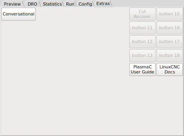

8.1. Custom User Buttons
There are buttons available in the PlasmaC GUI that are programmable by adding commands in the <machine_name>.ini file. The number of buttons varies by whether the user chose to use PlasmaC with Axis or Gmoccapy.
Five buttons are available in the main window of the Axis GUI, numbered 1-5 from left to right.
Four buttons are available in the main window of the Gmoccapy GUI, numbered 1-4 from top to bottom.
There are an additional ten buttons available in the Extras panel, numbered 10-19 from top left to bottom right.
All <machine_name>.ini file settings for the buttons are found in the [PLASMAC] section.

Cut Recovery
Pressing this button brings up the cut recovery dialog which will allow the user to move the torch off of the cut path to find a suitable piece of material to restart the cut from. This function is only available from the Extras panel and the button is only valid while paused.
BUTTON_n_CODE = cut-recovery

Buttons 10-19 in the Extras Panel are able to display an image instead of text. If an image is specified then this will take precedence and the image will be displayed instead of the button name.
BUTTON_n_IMAGE = path/to/image.png
The path is relative to the configuration directory, so if the image was in a sub-directory of the configuration directory named images then the entry would be images/image.png.
All images are displayed in a 60 x 60 format.

Hypertherm RS485 Wiring Diagram (wire colors inside the Hypertherm in parentheses):
Connection at Machine Pin #
Connection at Breakout Board
1 - Tx+ (Red)
->RXD+
2 - Tx- (Black)
->RXD-
3 - Rx+ (Brown)
->T/R+
4 - Rx- (White)
->T/R-
5 - GND (Green)
->GND
images/plasmac_rs485_pmx.png

DTECH DT-5019 USB to RS485 converter adapter:
images/plasmac_rs485_dtech.png
The following is necessary to convert a motherboard Serial connection or Serial card (RS232) to RS485:
DTECH RS232 to RS485 converter:
images/plasmac_rs485_converter.png
Serial card example (Sunnix SER5037A PCI Card shown with Breakout Board):
images/plasmac_rs485_sunnix.png
