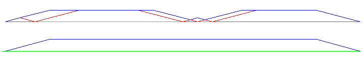

In the following figure the blue line represents the actual machine velocity. The red lines are the acceleration capability of the machine. The horizontal lines below each plot is the planned move. The upper plot shows how the trajectory planner will slow the machine down when short moves are encountered to stay within the limits of the machines acceleration setting to be able to come to an exact stop at the end of the next move. The bottom plot shows the effect of the Naive Cam Detector to combine the moves and do a better job of keeping the velocity as planned.
![images/naive-cam.png](images/naive-cam.png)

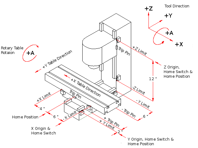

6. Machine Configurations
The following diagram shows a typical mill showing direction of travel of the tool and the mill table and limit switches. Notice how the mill table moves in the opposite direction of the Cartesian coordinate system arrows shown by the Tool Direction image. This makes the tool move in the correct direction in relation to the material.
![images/mill-diagram.png](images/mill-diagram.png)

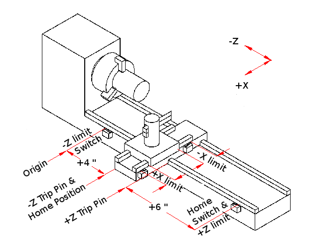

The following diagram shows a typical lathe showing direction of travel of the tool and limit switches.
![images/lathe-diagram.png](images/lathe-diagram.png)
