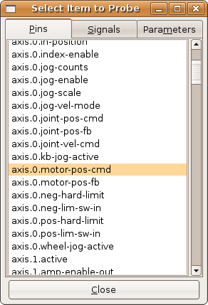

2. Halmeter
Halmeter is a voltmeter for the HAL. It lets you look at a pin, signal, or parameter, and displays the current value of that item. It is pretty simple to use. Start it by typing halmeter in an X windows shell. Halmeter is a GUI application. It will pop up a small window, with two buttons labeled Select and Exit. Exit is easy - it shuts down the program. Select pops up a larger window, with three tabs. One tab lists all the pins currently defined in the HAL. The next lists all the signals, and the last tab lists all the parameters. Click on a tab, then click on a pin/signal/parameter. Then click on OK. The lists will disappear, and the small window will display the name and value of the selected item. The display is updated approximately 10 times per second. If you click Accept instead of OK, the small window will display the name and value of the selected item, but the large window will remain on the screen. This is convenient if you want to look at a number of different items quickly.
You can have many halmeters running at the same time, if you want to monitor several items. If you want to launch a halmeter without tying up a shell window, type halmeter & to run it in the background. You can also make halmeter start displaying a specific item immediately, by adding pin|sig|par[am] <name> to the command line. It will display the pin, signal, or parameter <name> as soon as it starts. (If there is no such item, it will simply start normally.) And finally, if you specify an item to display, you can add -s before the pin|sig|param to tell halmeter to use a small window. The item name will be displayed in the title bar instead of under the value, and there will be no buttons. Useful when you want a lot of meters in a small amount of screen space.
Refer to Halmeter Tutorial section for more information.

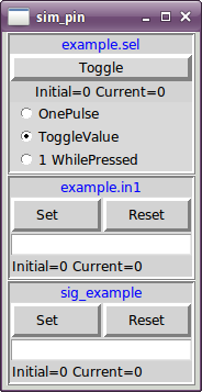

5. Sim Pin
sim_pin is a command line utility to display and update any number of writable pins, parameters or signals. Usage:
sim_pin Usage: sim_pin name1 [name2 ...] & Note: linuxcnc must be running A named item can specify a pin, param, or signal The item must be writable, e.g.: pin: IN or I/O (and not connected to a signal with a writer) param: RW signal: connected to a writable pin
For complete information, see the man page:
man sim_pin
Example (with LinuxCNC running):
halcmd loadrt mux2 names=example; halcmd net sig_example example.in0 sim_pin example.sel example.in1 sig_example &

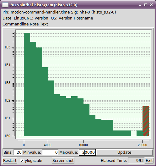

7. Hal Histogram
hal-histogram is a command line utility to display histograms for hal pins.
Usage: hal-histogram --help | -? or hal-histogram [Options] [pinname] Options: --minvalue minvalue (minimum bin, default: 0) --binsize binsize (binsize, default: 100) --nbins nbins (number of bins, default: 50) --logscale 0|1 (y axis log scale, default: 1) --text note (text display, default: "" ) --show (show count of undisplayed nbins, default off) --verbose (progress and debug, default off) Notes: 1) LinuxCNC (or another Hal application) must be running 2) If no pinname is specified, default is: motion-command-handler.time 3) This app may be opened for 5 pins 4) pintypes float, s32, u32, bit are supported 5) The pin must be associated with a thread supporting floating point For a base thread, this may require using: loadrt motmod ... base_thread_fp=1
