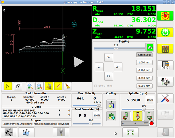

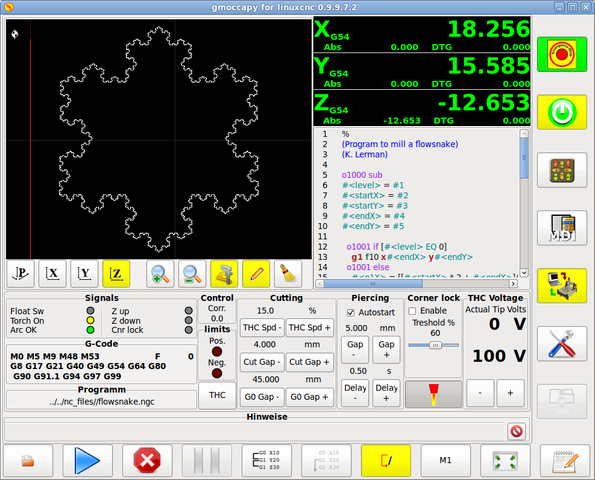

GMOCCAPY is a GUI for LinuxCNC, designed to be used with a touch screen, but can also be used on normal screens with a mouse or hardware buttons and MPG wheels, as it presents HAL Pins for the most common needs. Please find more information in the following.
It offers the possibility to display up to 4 axis, support a lathe mode for normal and back tool lathe and can be adapted to nearly every need, because gmoccapy supports embedded tabs and side panels. As a good example for that see gmoccapy_plasma

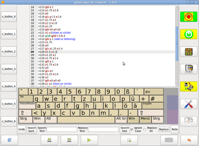

It has support for integrated virtual keyboard (onboard or matchbox-keyboard), so there is no need for a hardware keyboard or mouse, but it can also be used with that hardware. Gmoccapy offers a separate settings page to configure most settings of the GUI without editing files.

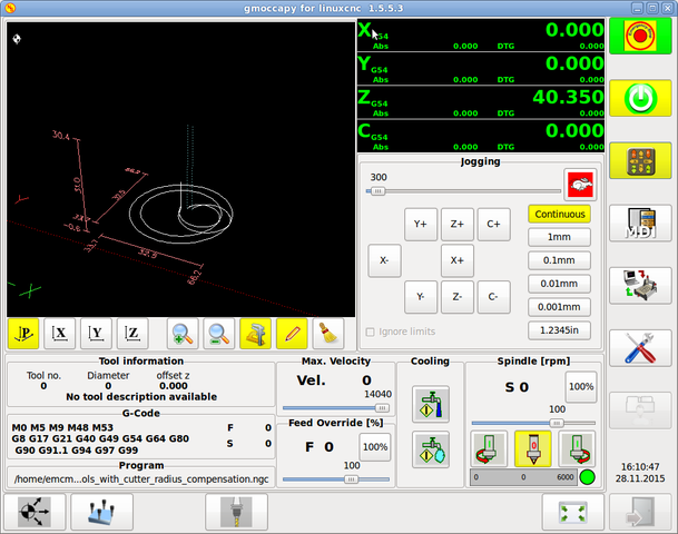

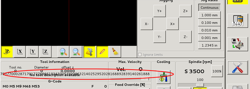

You will get a similar screen to the following: The design may variate depending on your config.

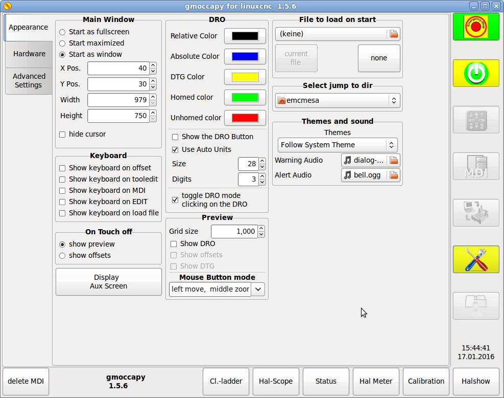

4. Basic Configuration
There is really not to much to configure just to run gmoccapy, but there are some points you should take care off if you want to use all the features of the GUI.
You will find the following INI files included, just to show the basics:

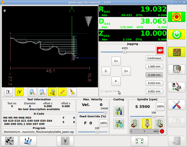

LATHE = 1 BACK_TOOL_LATHE = 1
The first line set the screen layout to control a lathe.
The second line is optional and will switch the X axis in a way you need for a back tool lathe. Also the keyboard shortcuts will react in a different way.
Tip
See also the Lathe Specific Section |

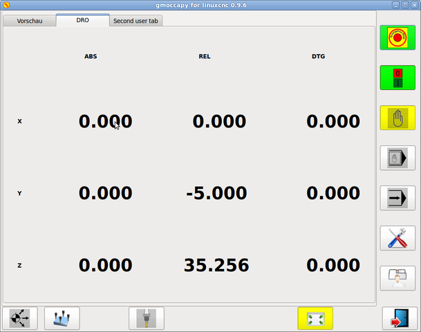

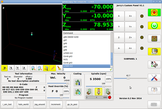

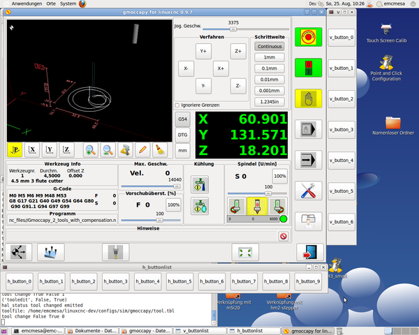

You can add embedded programs to gmoccapy like you can do in axis, touchy and gscreen. All is done by gmoccapy automatically if you include a few lines in your INI file in the DISPLAY section.
If you never used a glade panel, I recommend to read the excellent documentation. Glade VCP
EMBED_TAB_NAME = DRO EMBED_TAB_LOCATION = ntb_user_tabs EMBED_TAB_COMMAND = gladevcp -x {XID} dro.glade EMBED_TAB_NAME = Second user tab EMBED_TAB_LOCATION = ntb_preview EMBED_TAB_COMMAND = gladevcp -x {XID} vcp_box.glade
All you have to take care off, is that you include for every tab or side panel the mentioned three lines,
EMBED_TAB_NAME = Represents the name of the tab or side panel, it is up to you what name you use, but it must be present!
EMBED_TAB_LOCATION = Is the place where your program will be placed in the GUI.
ntb_user_tabs (as main tab, covering the complete screen)'
ntb_preview (as tab on the preview side)'
box_left (on the left, complete high of the screen)
box_right (on the right, in between the normal screen and the button list)
box_coolant_and_spindle (will hide the coolant and spindle frames and introduce your glade file here)
box_cooling (will hide the cooling frame and introduce your glade file)
box_spindle (will hide the spindle frame and introduce your glade file)
box_vel_info (will hide the velocity frames and introduce your glade file)
box_custom_1 (will introduce your glade file left of vel_frame)
box_custom_2 (will introduce your glade file left of cooling_frame)
box_custom_3 (will introduce your glade file left of spindle_frame)
box_custom_4 (will introduce your glade file right of spindle_frame)
See the different INI files included to see the differences
EMBED_TAB_COMMAND = the command to execute, i.e.
Includes a custom glade file called dro.glade in the mentioned location The file must be placed in the config folder of your machine.
gladevcp h_buttonlist.glade
Will just open a new user window called h_buttonlist.glade note the difference, this one is stand alone, and can be moved around independent from gmoccapy window.

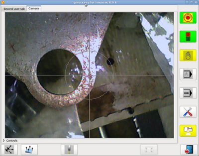

camview-emc -w {XID}
Will add a live image from a web cam to the location you specified. Take care that camview-emc is installed, as it is not by default. Detailed information for camview and linuxcnc at: cam view
gladevcp -c gladevcp -u hitcounter.py -H manual-example.hal manual-example.ui
Will add a the panel manual-example.ui, include a custom python handler, hitcounter.py and make all connections after realizing the panel according to manual-example.hal.

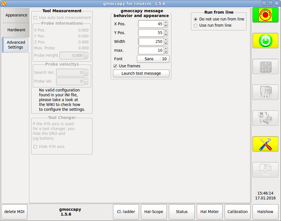

Gmoccapy has the ability to create hal driven user messages. To use them you need to introduce some lines in the [DISPLAY] section of the INI file.
Here is how to set up 3 user pop up message dialogs the messages support pango markup language. Detailed information about the markup language can be found at Pango Markup
MESSAGE_TEXT = The text to be displayed, may be pango markup formatted MESSAGE_TYPE = "status" , "okdialog" , "yesnodialog" MESSAGE_PINNAME = is the name of the hal pin group to be created
status : Will just display a message as pop up window, using the messaging system of gmoccapy
okdialog : Will hold focus on the message dialog and will activate a "-waiting" Hal_Pin OUT. Closing the message will reset the waiting pin
yesnodialog : Will hold focus on the message dialog and will activate a "-waiting" Hal_Pin bit OUT it will also give access to an "-response" Hal_Pin Bit Out, this pin will hold 1 if the user clicks OK, and in all other states it will be 0 Closing the message will reset the waiting pin The response Hal Pin will remain 1 until the dialog is called again
MESSAGE_TEXT = This is a <span background="#ff0000" foreground="#ffffff"> info-message</span> test MESSAGE_TYPE = status MESSAGE_PINNAME = statustest MESSAGE_TEXT = This is a yes no dialog test MESSAGE_TYPE = yesnodialog MESSAGE_PINNAME = yesnodialog MESSAGE_TEXT = Text can be <small>small</small>, <big>big</big>, <b>bold</b <i>italic</i>, and even be <span color="red">colored</span>. MESSAGE_TYPE = okdialog MESSAGE_PINNAME = okdialog
The specific hal pin conventions for these can be found under the User Messages hal pin section.

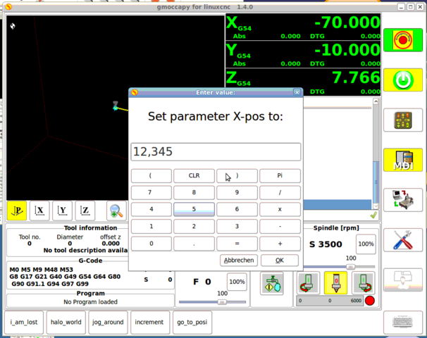

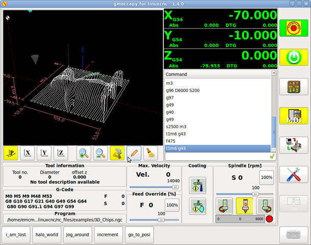

You can add macros to gmoccapy, similar to touchy’s way. A macro is nothing else than a ngc-file. You are able to execute complete CNC programs in MDI mode, by just pushing one button. To do so, you have to add a section like so:
[MACROS] MACRO = i_am_lost MACRO = hello_world MACRO = jog_around MACRO = increment xinc yinc MACRO = go_to_position X-pos Y-pos Z-pos
This will add 5 macros to the MDI button list. Please note, that maximal 9 macros will appear in the GUI, due to place reasons. But it is no error placing more in your INI file.
The name of the file must be exactly the same as the name given in the MACRO line. So the macro i_am_lost will call the file i_am_lost.ngc.
the name of the file need to be the same as the name mentioned in the macro line, just with the ngc extension
The file must contain a subroutine like so: O<i_am_lost> sub, the name of the sub must match exactly (case sensitive) the name of the macro
the file must end with an endsub O<i_am_lost> endsub followed by an M2 command
the files need to be placed in a folder specified in your INI file in the RS274NGC section (see RS274NGC)
The code in between sub and endsub will be executed by pushing the corresponding macro button.
Note
You will find the sample macros in macros folder placed in the gmoccapy sim folder. |
Gmoccapy will also accept macros asking for parameters like:
The parameters must be separated by spaces. This calls a file go_to_position.ngc with the following content:
; Test file go to position ; will jog the machine to a given position O<go_to_position> sub G17 G21 G54 G61 G40 G49 G80 G90 ;#1 = <X-Pos> ;#2 = <Y-Pos> ;#3 = <Z-Pos> (DBG, Will now move machine to X = #1 , Y = #2 , Z = #3) G0 X #1 Y #2 Z #3 O<go_to_position> endsub M2
After pushing the execute macro button, you will be asked to enter the values for X-pos Y-pos Z-pos and the macro will only run if all values have been given.

5.1. Right And Bottom Button Lists
The screen has two main button lists, one on the right side an one on the bottom. The right handed buttons will not change during operation, but the bottom button list will change very often. The buttons are count from up to down and from left to right beginning with "0".
In hal_show you will see the right (vertical) buttons are:
gmoccapy.v-button-0
gmoccapy.v-button-1
gmoccapy.v-button-2
gmoccapy.v-button-3
gmoccapy.v-button-4
gmoccapy.v-button-5
gmoccapy.v-button-6
and the bottom (horizontal) buttons are:
gmoccapy.h-button-0
gmoccapy.h-button-1
gmoccapy.h-button-2
gmoccapy.h-button-3
gmoccapy.h-button-4
gmoccapy.h-button-5
gmoccapy.h-button-6
gmoccapy.h-button-7
gmoccapy.h-button-8
gmoccapy.h-button-9
As the buttons in the bottom list will change according the mode and other influences, the hardware buttons will activate different functions, and you don’t have to take care about switching functions around in hal, because that is done completely by gmoccapy!

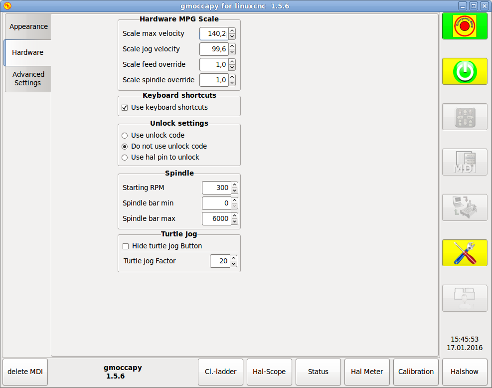

All sliders from gmoccapy can be connected to hardware encoder or hardware potentiometers.
To connect encoders the following pin are exported:
gmoccapy.max-vel-counts = HAL_S32 (Maximal Velocity of the machine)
gmoccapy.jog-speed-counts = HAL_S32 (Jog velocity)
gmoccapy.spindle-override-counts = HAL_S32 (spindle override)
gmoccapy.feed-override-counts = HAL_S32 (feed override)
gmoccapy.reset-feed-override = HAL_BIT (reset the feed override to 100 %)
gmoccapy.reset-spindle-override = HAL_BIT (reset the spindle override to 100 %)
To connect potentiometers, use the following hal pin:
gmoccapy.analog-enable = HAL_BIT Must be True, to allow analog inputs
gmoccapy.jog-vel-value = HAL_FLOAT To adjust the jog velocity slider
gmoccapy.max-vel-value = HAL_FLOAT To adjust the max velocity slider
gmoccapy.feed-override-value = HAL_FLOAT To adjust the feed override slider
gmoccapy.spindle-override-value = HAL_FLOAT To adjust the spindle override slider
The float pin do accept values from 0.0 to 1.0, being the percentage value you want to set the slider value.
[WARNING] If you use both connection types, do not connect the same slider to both pin, as the influences between the two has not been tested! Different sliders may be connected to the one or other hal connection type.
[IMPORTANT] Please be aware, that for the jog velocity depends on the turtle button state, it will lead to different slider scales depending on the mode (turtle or rabbit). Please take also a look to jog velocities and turtle-jog hal pin for more details.
Spindle Override Min Value = 20 % Spindle Override Max Value = 120 % gmoccapy.analog-enable = 1 gmoccapy.spindle-override-value = 0.25 value to set = Min Value + (Max Value - Min Value) * gmoccapy.spindle-override-value value to set = 20 + (120 - 20) * 0.25 value to set = 45 %

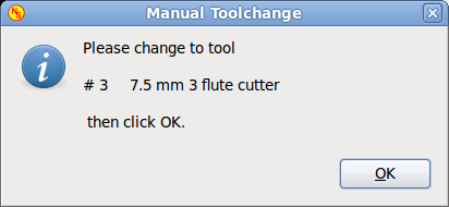

This pin are provided to use gmoccapy’s internal tool change dialog, similar to the one known from axis, but with several modifications, so you will not only get the message to change to tool number 3, but also the description of that tool like 7.5 mm 3 flute cutter. The information is taken from the tool table, so it is up to you what to display.
gmoccapy.toolchange-number HAL_S32 The number of the tool to be changed
gmoccapy.toolchange-change HAL_BIT Indicate that a tool has to be changed
gmoccapy.toolchange-changed HAL_BIT Indicate toll has been changed
Usually they are connected like this for a manual tool change:
net tool-change gmoccapy.toolchange-change <= iocontrol.0.tool-change net tool-changed gmoccapy.toolchange-changed <= iocontrol.0.tool-changed net tool-prep-number gmoccapy.toolchange-number <= iocontrol.0.tool-prep-number net tool-prep-loop iocontrol.0.tool-prepare <= iocontrol.0.tool-prepared

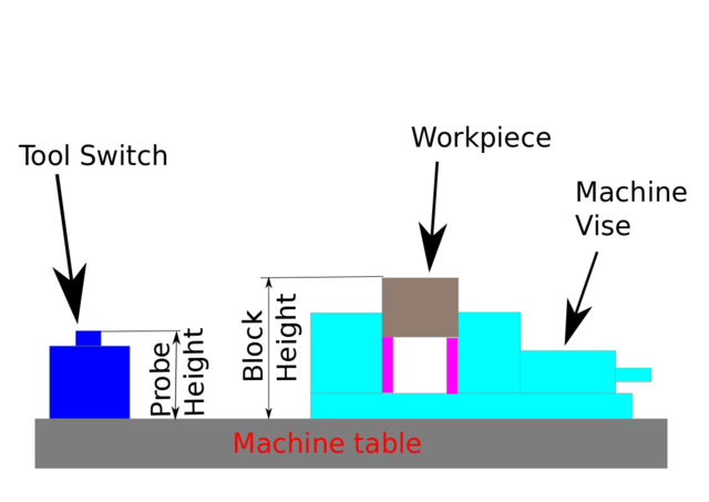

6. Auto Tool Measurement
Gmoccapy offers an integrated auto tool measurement. To use this feature, you will need to do some additional settings and you may want to use the offered hal pin to get values in your own ngc remap procedure.
[IMPORTANT] Before starting the first test, do not forget to enter the probe height and probe velocities on the settings page! See Settings Page Tool Measurement
It might be also a good idea to take a look at the tool measurement video: see tool measurement related videos
Tool Measurement in gmoccapy is done a little bit different to many other GUI. You should follow these steps:
touch of you workpiece in X and Y
measure the hight of your block from the base where your tool switch is located, to the upper face of the block (including chuck etc.)
Push the button block height and enter the measured value
Go to auto mode and start your program
here is a small sketch:
With the first given tool change the tool will be measured and the offset will be set automatically to fit the block height. The advantage of the gmoccapy way is, that you do not need a reference tool.
Note
Your program must contain a tool change at the beginning! The tool will be measured, even it has been used before, so there is no danger, if the block height has changed. There are several videos showing the way to do that on you tube. |

7. The Settings Page
To enter the page you will have to click on
and give an unlock code, witch is 123 as default. If you want to change it
at this time you will have to edit the hidden preference file, see
the display section for details.
The page looks at the moment like so:
The page is separated in three main tabs:
7.1. Appearance
On this tab you will find the following options:
- Main Window
Here you can select how you wish the GUI to start. The main reason for this was the wish to get an easy
way for the user to set the starting options without the need to touch code.
You have three options:
start as full screen
start maximized
start as window
If you select start as window the spinboxes to set the position and size will get active.
One time set, the GUI will start every time on the place and with the size selected.
Nevertheless the user can change the size and position using the mouse, but that will
not have any influence on the settings.
hide the cursor does allow to hide the cursor, what is very useful if you use a touch screen.
- Keyboard
The check-boxes allows the user to select if he want the on board keyboard to be shown immediately,
when entering the MDI Mode, when entering the offset page, the tooledit widget or when open a program
in the EDIT mode. The keyboard button on the bottom button list will not been affected by this settings,
so you be able to show or hide the keyboard by pressing the button. The default behavior will be set by
the check-boxes.
Default are :
show keyboard on offset = True
show keyboard on tooledit = False
show keyboard on MDI = True
show keyboard on EDIT = True
show keyboard on load file = False
If the keyboard layout is not correct, i.e. clicking X gives Z, than the layout has not been set properly, related to your locale settings. For onboard it can be solved with a small batch file with the following content:
Note
If this section is not sensitive, you have not installed a virtual keyboard, + supported are onboard and matchbox-keyboard. |
#!/bin/bash setxkbmap -model pc105 -layout de -variant basic
The letters "de" are for German, you will have to set them according to your locale settings. Just execute this file before starting LinuxCNC, it can be done also adding a starter to your local folder.
./config/autostart
So that the layout is set automatically on starting.
For matchbox-keyboard you will have to make your own layout, for a German layout ask in the forum.
Note
If this section is not sensitive, you have not installed a virtual keyboard, supported are onboard and matchbox-keyboard. |
- On Touch Off
give the option to show the preview tab or the offset page tab if you enter the touch off mode by clicking the corresponding bottom button.
show preview
show offsets
As the notebook tabs are shown, you are able to switch between both views in any case.
- Show Aux Display
By clicking this button a additional window will be opened. This button is only sensitive, if a file named gmoccapy2.glade is located in your config folder. You can build the Aux Screen using Glade.
Warning
The main window of the aux screen must be named window2 |
- DRO Options
You have the option to select the background colors of the different DRO states. So users suffering from protanopia (red/green weakness) are able to select proper colors
By default the backgrounds are:
Relative mode = black
Absolute mode = blue
Distance to go = yellow
The foreground color of the DRO can be selected with:
homed color = green
unhomed color = red
show dro in preview
the DRO will be shown in the preview window +
show offsets+
the Offsets will be shown in the preview window +
show DTG
the distance to go will be shown in the preview window +
show DRO Button
will allow you to display additional buttons on the left side of the DRO.
It will display:
* one button to switch from relative to absolute coordinates,
* one button to toggle between distance to go and the other states
* and one button to toggle the units from metric to imperial and vice versa.
[WARNING] It is not recommended to use this option, because the user will loose the auto unit option, which will toggle the units according to the active gcode G20 / G21.
[NOTE] You can change through the DRO modes (absolute, relative, distance to go) by clicking on the DRO!
Use Auto Units
allows to disable the auto units option of the display, so you can run a program in inches and watch the DRO in mm. +
size
allows to set the size of the DRO font, default is 28, if you use a bigger screen you may want to increase the size up to 56.
If you do use 4 axis, the DRO font size will be 3/4 of the value, because of space reason. +
digits
sets the number of digits of the DRO from 1 to 5.
Note
Imperial will show one digit more that metric. So if you are in imperial machine units and set the digit value to 1, you will get no digit at all in metric. |
toggle DRO mode
if not active, a mouse click on the DRO will not take any action.
By default this checkbox is active, so every click on any DRO will toogle the DRO readout from actual to relative to DTG (distance to go). +
- Preview
Grid Size Sets the grid size of the preview window. Unfortunately the size has to be set in inches, even if your machine units are metric. We do hope to fix that in a future release.
[NOTE] The grid will not be shown in perspective view.
Show DRO
Will show the a DRO also in the preview window, it will be shown automatically in fullsize preview
Show DTG will show also the DTG (direct distance to end point) in the preview, only if Show DRO is active and not full size preview.
Show Offsets will show the offsets in the preview window.
[NOTE] If you only check this option and leave the others unchecked, you will get in full size preview a offset page
Mouse Button Mode this combobox you can select the button behavior of the mouse to rotate, move or zoom within the preview.
left rotate, middle move, right zoom
left zoom, middle move, right rotate
left move, middle rotate, right zoom
left zoom, middle rotate, right move
left move, middle zoom, right rotate
left rotate, middle zoom, right move
Default is left move, middle zoom, right rotate.
The mouse wheel will still zoom the preview in every mode.
Tip
If you select an element in the preview, the selected element will be taken as rotation center point. |
- File to load on start up
Select the file you want to be loaded on start up. In other GUI changing this was very cumbersome, because the users where forced to edit the INI File.
Select the file you want to be loaded on start up. If a file is loaded, it can be set by pressing the current button to avoid that any program is loaded at start up, just press the None button.
The file selection screen will use the filters you have set in the INI File, if there aren’t any filters given, you will only see ngc files. The path will be set according to the INI settings in [DISPLAY] PROGRAM_PREFIX
- Jump to dir
you can set here the directory to jump to if you press the corresponding button in the file selection dialog.
- Themes and Sounds
This lets the user select what desktop theme to apply and what error and messages sounds should be played. By default "Follow System Theme" is set.
7.2. Hardware
- Hardware MPG Scales
For the different Hal Pin to connect MPG Wheels to, you may select individual scales to be applied. The main reason for this was my own test to solve this through hal connections, resulting in a very complex hal file. Imagine a user having an MPG Wheel with 100 ipr and he wants to slow down the max vel from 14000 to 2000 mm/min, that needs 12000 impulses, resulting in 120 turns of the wheel! Or an other user having a MPG Wheel with 500 ipr and he wants to set the spindle override witch has limits from 50 to 120 % so he goes from min to max within 70 impulses, meaning not even 1/4 turn.
By default all scales are set using the calculation:
(MAX - MIN)/100
- Keyboard shortcuts
Some users want to jog there machine using the keyboard buttons and there are others that will never allow this. So everybody can select whether to use them or not.
Default is to use keyboard shortcuts.
Please take care if you use a lathe, than the shortcuts will be different. See the Lathe section
Arrow Left or NumPad_Left = X minus
Arrow Right or NumPad_Right = X plus
Arrow up NumPad_Up = Y plus
Arrow Down NumPad_Down = Y minus
Page Up NumPad_Page_Up = Z plus
Page Down NumPad_Page_Down = Z minus
F1 = Estop (will work even if keyboard shortcuts are disabled)
F2 = Machine on
ESC = Abort
There are additional keys for message handling, see Message behavior and appearance
WINDOWS = Delete last message
<STRG><SPACE> = Delete all messages
- Unlock options
There are three options to unlock the settings page:
use unlock code (the user must give a code to get in)
Do not use unlock code (There will be no security check)
Use hal pin to unlock (hardware pin must be high to unlock the settings, see hardware unlock pin
Default is use unlock code (default = 123)
- Spindle
The start RPM sets the rpm to be used if the spindle is started and no S value has been set.
With the MIN and MAX settings you set the limits of the spindle bar shown in the INFO frame on the main screen. It is no error giving wrong values. If you give a maximum of 2000 and your spindle makes 4000 rpm, only the bar level will be wrong on higher speeds than 2000 rpm.
default values are MIN = 0 MAX = 6000
- Turtle Jog
This settings will have influence on the jog velocities.
hide turtle jog button will hide the button right of the jog velocity slider, if you hide this button, please take care that it shows the rabbit icon, otherwise you will not be able to jog faster than the turtle jog velocity, which is calculated using the turtle jog factor.
Turtle jog factor sets the scale to apply for turtle jog mode. If you set a factor of 20, the max jog velocity will be 1/20 of max velocity of the machine if in turtle mode (button pressed, showing the turtle)
Note
This button can be activated using the turtle-jog hal pin. |
7.3. Advanced Settings
If this part is not sensitive, you do not have a valid INI file configuration to use tool measurement.
Please check Auto Tool Measurement
Use auto tool measurement : If checked, after each tool change, a tool measurement will be done, the result will be stored in the tool table and an G43 will be executed after the change.
The following informations are taken from your INI file and must be given in absolute coordinates
X Pos. = The X position of the tool switch
Y Pos. = The Y position of the tool switch
Z Pos. = The Z position of the tool switch, we will go as rapid move to this coordinate
Max. Probe = is the distance to search for contact, an error will be launched, if no contact is given. The distance has to be given in relative coordinates, beginning the move from Z Pos., so you have to give a negative value to go down!
Probe Height = is the height of your probe switch, you can measure it. Just touch off the base where the probe switch is located and set that to zero. Then make a tool change and watch the tool_offset_z value, that is the hight you must enter here.
Search Vel. = The velocity to search for the tool switch, after contact the tool will go up again and then goes toward the probe again with probe vel, so you will get better results.
Probe Vel. = Is the velocity for the second movement to the switch, it should be slower to get better touch results.(In sim mode, this is commented out in macros/change.ngc, otherwise the user would have to click twice on the probe button)
If your 4’th axis is used in a tool changer, you may want to hide the DRO and all the other buttons related to that axis.
You can do that by checking the checkbox, that will hide:
4’th axis DRO
4’th axis Jog button
4’th axis home button
column of 4’th axis in the offsetpage
column of 4’th axis in the tolleditor
This will display small pop up windows displaying the message or error text, the behavior is very similar to the one axis uses. You can delete a specific message, by clicking on it’s close button, if you want to delete the last one, just hit the WINDOWS key on your keyboard, or delete all messages at ones with <STRG><SPACE>.
You are able to set some options:
X Pos = The position of the top left corner of the message in X counted in pixel from the top left corner of the screen.
Y Pos = The position of the top left corner of the message in Y counted in pixel from the top left corner of the screen.
Width = The width of the message box
max = The maximum messages you want to see at ones, if you set this to 10, the 11th message will delete the first one, so you will only see the last 10 ones.
Font = The font and size you want to use to display the messages
use frames = If you activate the checkbox, each message will be displayed in a frame, so it is much easier to distinguish the messages. But you will need a little bit more space.
The button launch test message will just do what it is supposed to, it will show a message, so you can see the changes of your settings without the need to generate an error.
You can allow or disallow the run from line. This will set the corresponding button insensitive (grayed out), so the user will not be able to use this option. The default is disable run from line.
Warning
It is not recommend to use run from line, as LinuxCNC will not take care of any previous lines in the code before the starting line. So errors or crashes are very probable. |
If this button is active, nearly every button press or relevant action of LinuxCNC will be logged in the ALARM history. This is very useful for debugging.
8. Lathe Specific Section
If in the INI File LATHE = 1 is given, the GUI will change its appearance to the special needs for a lathe. Mainly the Y axis will be hidden and the jog buttons will be arranged in a different order.
As you see the R DRO has a black background and the D DRO is gray. This will change according to the active G-Code G7 or G8. The active mode is visible by the black background, meaning in the shown images G8 is active.
The next difference to the standard screen is the location of the Jog Button. X and Z have changed places and Y is gone. You will note that the X+ and X- buttons changes there places according to normal or back tool lathe.
Also the keyboard behavior will change:
Normal Lathe:
Arrow Left NumPad_Left = Z minus
Arrow Right NumPad_Right = Z plus
Arrow up NumPad_Up = X minus
Arrow Down NumPad_Down = X plus
Back Tool Lathe:
Arrow up NumPad_Up = X plus
Arrow Down NumPad_Down = X minus
The tool information frame will show not only the Z offset, but also the X offset and the tool table is showing all lathe relevant information.

11. Known problems
11.1. Strange numbers in the info area
If you get strange numbers in the info area of gmoccapy like:
You have made your config file using an older version of StepConfWizard. It has made a wrong entry in the INI file under the [TRAJ] named MAX_LINEAR_VELOCITY = xxx. Change that entry to MAX_VELOCITY = xxx
