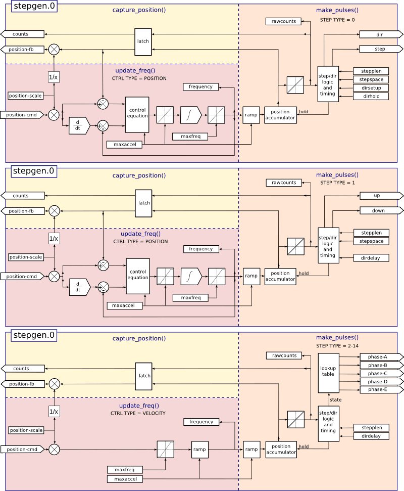

This component provides software based generation of step pulses in response to position or velocity commands. In position mode, it has a built in pre-tuned position loop, so PID tuning is not required. In velocity mode, it drives a motor at the commanded speed, while obeying velocity and acceleration limits. It is a realtime component only, and depending on CPU speed, etc, is capable of maximum step rates of 10kHz to perhaps 50kHz. Figure Step Pulse Generator Block Diagram shows three block diagrams, each is a single step pulse generator. The first diagram is for step type 0, (step and direction). The second is for step type 1 (up/down, or pseudo-PWM), and the third is for step types 2 through 14 (various stepping patterns). The first two diagrams show position mode control, and the third one shows velocity mode. Control mode and step type are set independently, and any combination can be selected.
Step Pulse Generator Block Diagram position mode

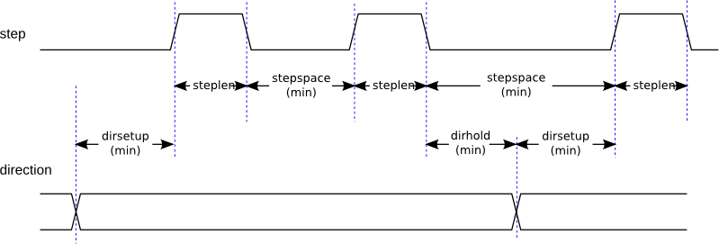

  • (float) stepgen.<chan>.steplen - Length of a step pulse (step type 0 and 1) or minimum time in a given state (step types 2-14), in nano-seconds.
  • (float) stepgen.<chan>.stepspace - Minimum spacing between two step pulses (step types 0 and 1 only), in nano-seconds. Set to 0 to enable the stepgen doublefreq function. To use doublefreq the parport reset function must be enabled.
  • (float) stepgen.<chan>.dirsetup - Minimum time from a direction change to the beginning of the next step pulse (step type 0 only), in nanoseconds.
  • (float) stepgen.<chan>.dirhold - Minmum time from the end of a step pulse to a direction change (step type 0 only), in nanoseconds.
  • (float) stepgen.<chan>.dirdelay - Minmum time any step to a step in the opposite direction (step types 1-14 only), in nano-seconds.

In position mode, the values of maxvel and maxaccel are used by the internal position loop to avoid generating step pulse trains that the motor cannot follow. When set to values that are appropriate for the motor, even a large instantaneous change in commanded position will result in a smooth trapezoidal move to the new location. The algorithm works by measuring both position error and velocity error, and calculating an acceleration that attempts to reduce both to zero at the same time. For more details, including the contents of the control equation box, consult the code.
In velocity mode, maxvel is a simple limit that is applied to the commanded velocity, and maxaccel is used to ramp the actual frequency if the commanded velocity changes abruptly. As in position mode, proper values for these parameters ensure that the motor can follow the generated pulse train.
Step Type 0
Step type 0 is the standard step and direction type. When configured for step type 0, there are four extra parameters that determine the exact timing of the step and direction signals. In the following figure the meaning of these parameters is shown. The parameters are in nanoseconds, but will be rounded up to an integer multiple of the thread period for the threaed that calls make_pulses(). For example, if make_pulses() is called every 16 us, and steplen is 20000, then the step pulses will be 2 x 16 = 32 us long. The default value for all four of the parameters is 1ns, but the automatic rounding takes effect the first time the code runs. Since one step requires steplen ns high and stepspace ns low, the maximum frequency is 1,000,000,000 divided by (steplen+stepspace). If maxfreq is set higher than that limit, it will be lowered automatically. If maxfreq is zero, it will remain zero, but the output frequency will still be limited.
When using the parallel port driver the step frequency can be doubled using the parport reset function together with stepgen’s doublefreq setting.
images/stepgen-type0.png
Figure 1. Step and Direction Timing

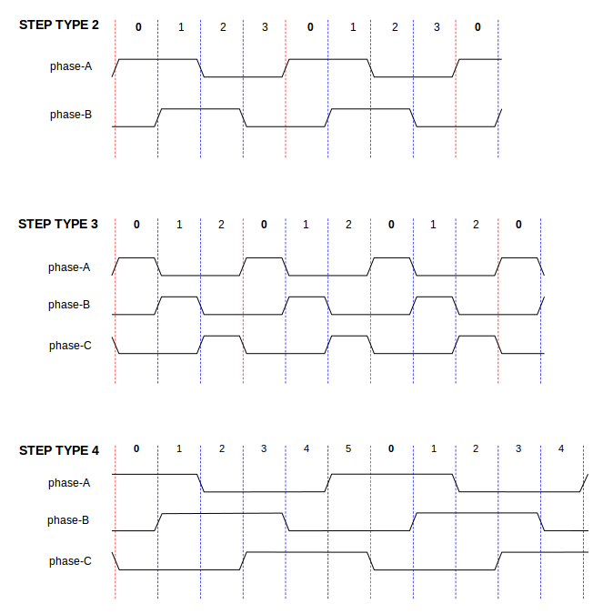

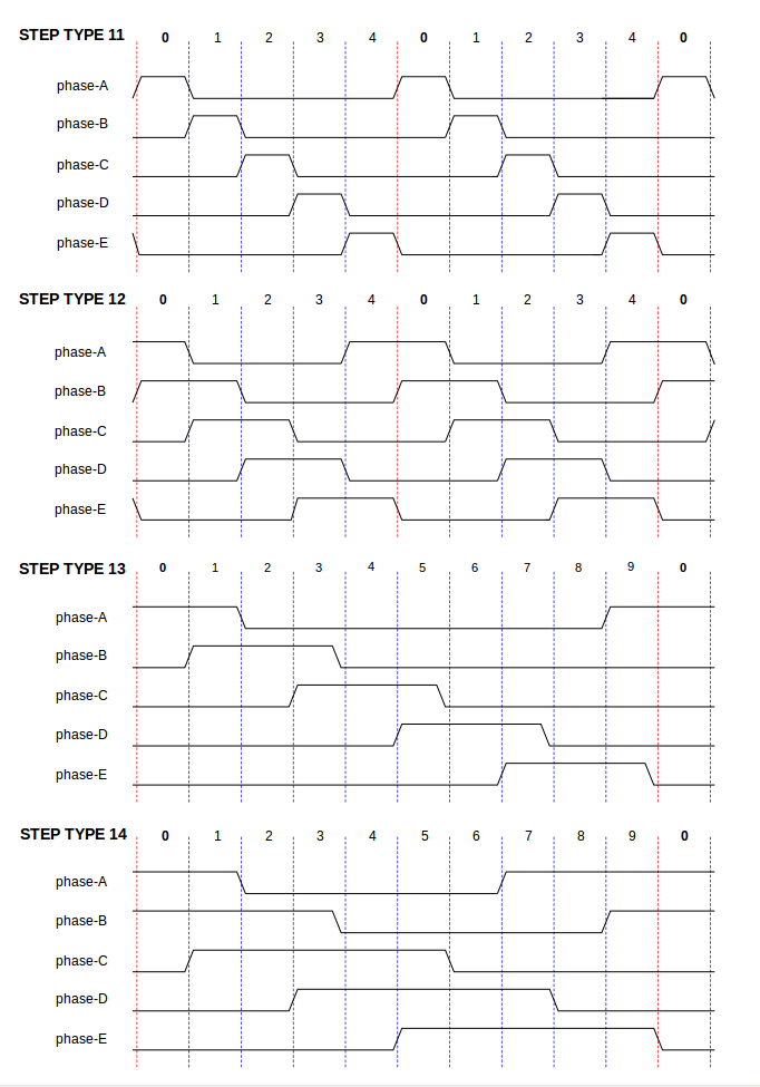

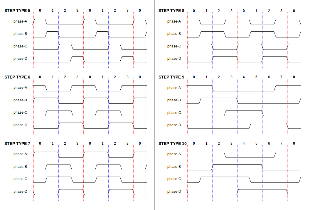

Step Type 2 - 14
Step types 2 through 14 are state based, and have from two to five outputs. On each step, a state counter is incremented or decremented. Figures Two-and-Three-Phase, Four-Phase, and Five-Phase show the output patterns as a function of the state counter. The maximum frequency is 1,000,000,000 divided by steplen, and as in the other modes, maxfreq will be lowered if it is above the limit.

Four-Phase Step Types
images/stepgen-type5-10.png
Five-Phase Step Types
images/stepgen-type11-14.png

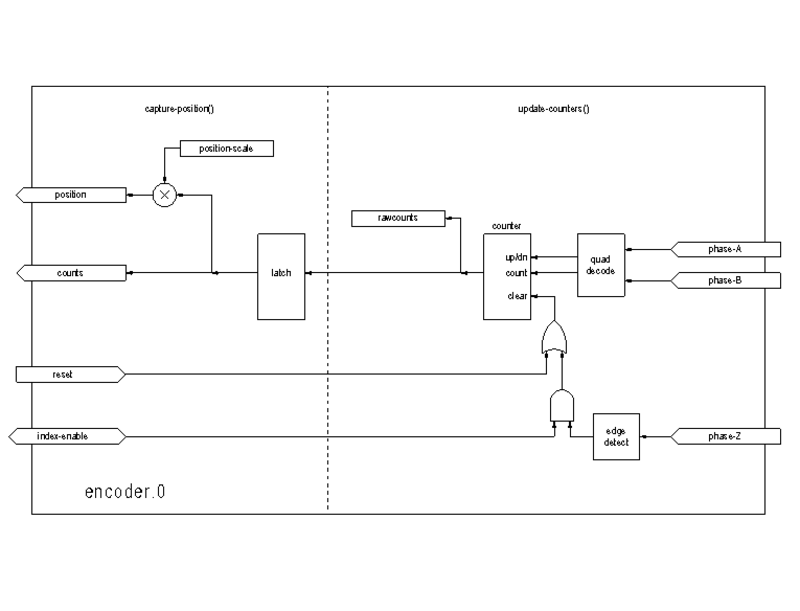

3. Encoder
This component provides software based counting of signals from quadrature encoders. It is a realtime component only, and depending on CPU speed, latency, etc, is capable of maximum count rates of 10kHz to perhaps up to 50kHz.
The base thread should be 1/2 count speed to allow for noise and timing variation. For example if you have a 100 pulse per revolution encoder on the spindle and your maximnum RPM is 3000 the maximum base thread should be 25 us. A 100 pulse per revolution encoder will have 400 counts. The spindle speed of 3000 RPM = 50 RPS (revolutions per second). 400 * 50 = 20,000 counts per second or 50 us between counts.
Figure Encoder Counter Block Diagram is a block diagram of one channel of encoder counter.
images/encoder-block-diag.png

The component exports two functions. Each function acts on all of the encoder counters - running different counters in different threads is not supported.
  • (funct) encoder.update-counters - High speed function to count pulses (no floating point).
  • (funct) encoder.capture-position - Low speed function to update latches and scale position.

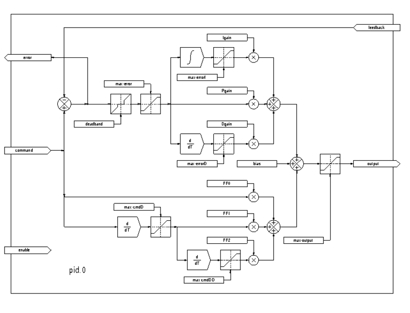

This component provides Proportional/Integral/Derivative control loops. It is a realtime component only. For simplicity, this discussion assumes that we are talking about position loops, however this component can be used to implement other feedback loops such as speed, torch height, temperature, etc. Figure PID Loop Block Diagram is a block diagram of a single PID loop.
images/pid-block-diag.png

  • (float) pid.<loopnum>.FF0 - Zeroth order feedforward - output proportional to command (position).
  • (float) pid.<loopnum>.FF1 - First order feedforward - output proportional to derivative of command (velocity).
  • (float) pid.<loopnum>.FF2 - Second order feedforward - output proportional to 2nd derivative of command (acceleration)
    [FF2 is not currently implemented, but it will be added. Consider this note a “FIXME” for the code]
  • (float) pid.<loopnum>.deadband - Amount of error that will be ignored
  • (float) pid.<loopnum>.maxerror - Limit on error
  • (float) pid.<loopnum>.maxerrorI - Limit on error integrator
  • (float) pid.<loopnum>.maxerrorD - Limit on error derivative
  • (float) pid.<loopnum>.maxcmdD - Limit on command derivative
  • (float) pid.<loopnum>.maxcmdDD - Limit on command 2nd derivative
  • (float) pid.<loopnum>.maxoutput - Limit on output value
All of the max limits are implemented such that if the parameter value is zero, there is no limit.
If debug=1 was specified when the component was installed, four additional parameters will be exported:
  • (float) pid.<loopnum>.errorI - Integral of error.
  • (float) pid.<loopnum>.errorD - Derivative of error.
  • (float) pid.<loopnum>.commandD - Derivative of the command.
  • (float) pid.<loopnum>.commandDD - 2nd derivative of the command.
Functions
The component exports one function for each PID loop. This function performs all the calculations needed for the loop. Since each loop has its own function, individual loops can be included in different threads and execute at different rates.
  • (funct) pid.<loopnum>.do_pid_calcs - Performs all calculations for a single PID loop.
If you want to understand the exact algorithm used to compute the output of the PID loop, refer to figure PID Loop Block Diagram, the comments at the beginning of emc2/src/hal/components/pid.c , and of course to the code itself. The loop calculations are in the C function calc_pid().
