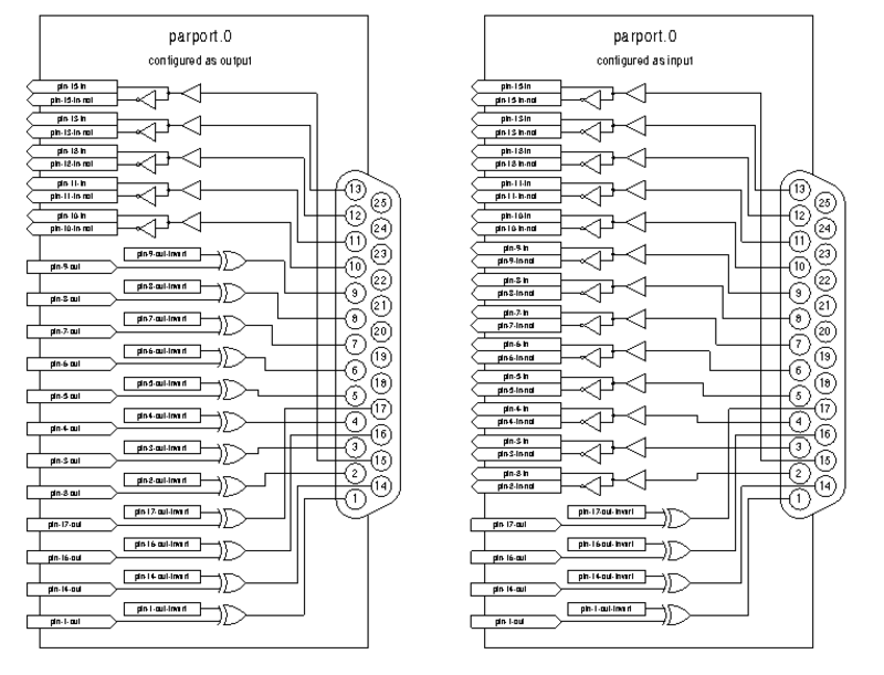

No other combinations are supported, and a port cannot be changed from input to output once the driver is installed. The Parport Block Diagram shows two block diagrams, one showing the driver when the data group is configured for output, and one showing it configured for input. For x mode, refer to the pin listing of halcmd show pin for pin direction assignment.

images/parport-block-diag.png
Figure 1. Parport Block Diagram
