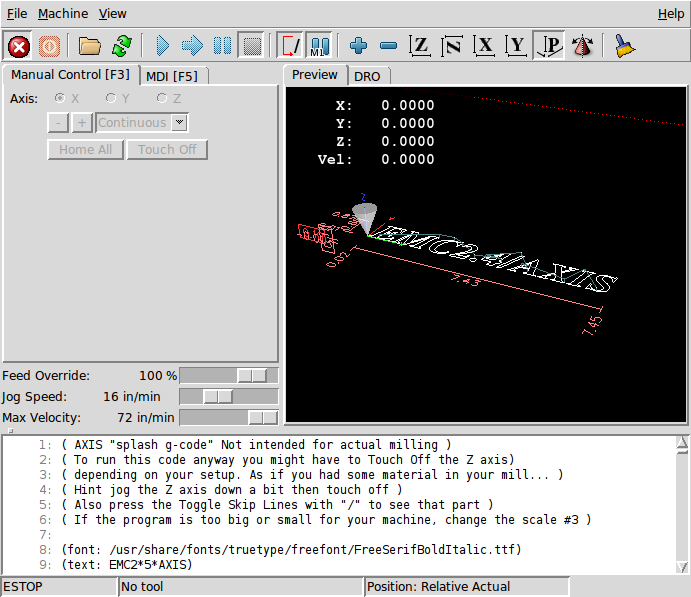

  • Axis, the standard GUI interface.
images/axis-2.5.png
Figure 2. Axis GUI

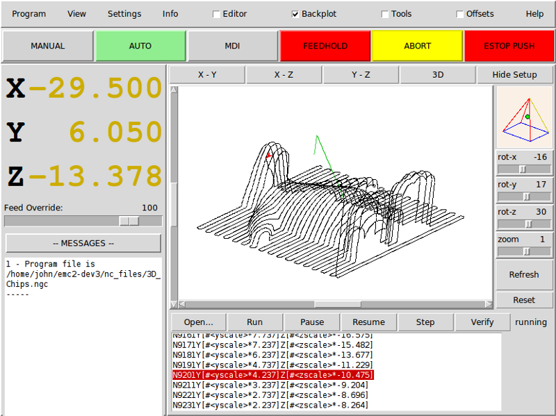

  • Mini, a Tcl/Tk-based GUI
images/mini.png
Figure 5. The Mini GUI
images/tkemc.png
Figure 6. The TkLinuxCNC GUI

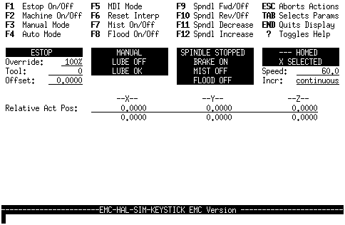

  • Keystick, a character-based screen graphics program suitable for minimal installations (without the X server running).
images/keystick.png
Figure 7. The Keystick GUI
