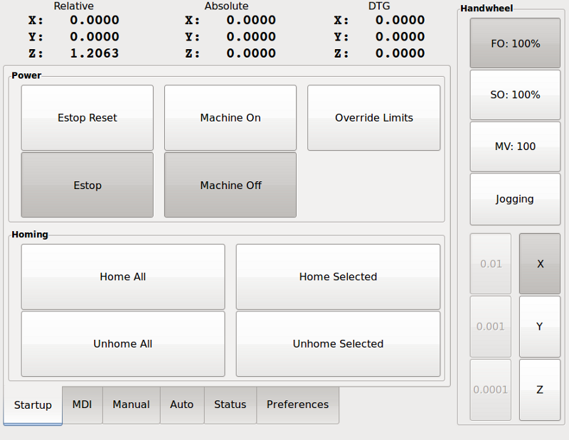

Touchy is a user interface for LinuxCNC meant for use on machine control panels, and therefore does not require keyboard or mouse.
It is meant to be used with a touch screen, and works in combination with a wheel/MPG and a few buttons and switches.
images/touchy.png
Figure 1. Touchy
