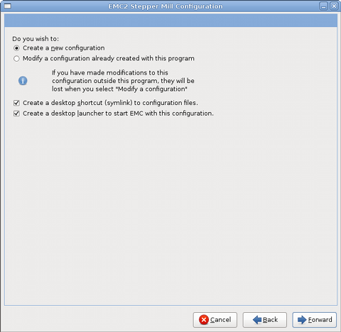

1.2 Entry Page
Figure: Entry Page- Create New
- Creates a fresh configuration.
- Modify
- Modify and existing configuration. After selecting this a file picker pops up so you can select the .stepconf file for modification. If you made any modifications to the main .hal or the .ini file these will be lost. Modifications to custom.hal and custom_postgui.hal will not be changed by the Stepconf Wizard.
- Create Desktop Shortcut
- This will place a link on your desktop to the files.
- Create Desktop Launcher
- This will place a launcher on your desktop to start your application.

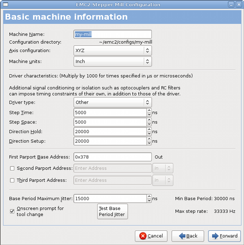

Figure: Basic Information Page- Machine Name
- Choose a name for your machine. Use only uppercase letters, lowercase letters, digits, "-" and "_".
- Axis Configuration
- Choose XYZ (Mill), XYZA (4-axis mill) or XZ (Lathe).
- Machine Units
- Choose Inch or mm. All subsequent questions (such as machine travel, leadscrew pitch, etc) will be answered in the chosen units
- Driver Type
- If you have one of the stepper drivers listed in the pull down box, choose it. Otherwise, find the 4 timing values in your driver's data sheet and enter them.
If the data sheet gives a value in microseconds, multiply by 1000. For example, enter 4.5us as 4500. A list is on the Linuxcnc Wiki site of most popular drives with the timing values is in the Stepper Drive Timing Page.
Additional signal conditioning or isolation such as optocouplers and RC filters on break out boards can impose timing constraints of their own, in addition to those of the driver. You may find it necessary to add some time to the drive requirements to allow for this. The EMC Configuration Selector has configs for Sherline all ready configured. - Step Time
- How long the step pulse is "on" in nano seconds.
- Step Space
- Minimum time between step pulses in nano seconds.
- Direction Hold
- How long the direction pin is held after a change of direction in nano seconds.
- Direction Setup
- How long before a direction change after the last step pulse in nano seconds
- First Parport
- Usually the default of Ox378 is correct.
- Second Parport
- If you need to specify addional parallel ports enter the address and the type. For information on finding the address of PCI parallel ports see the Port Address in the Integrators Manual.
- Base Period Maximum Jitter
- Enter the result of the Latency Test here. To run a latency test press the "Test Base Period Jitter" button. See the latency test section for more details.
- Max Step Rate
- Stepconf automatically calculates the Max Step Rate based on the driver characteristics entered and the latency test result.
- Min Base Period
- Stepconf automatically determines the Min Base Period based on the driver characteristics entered and latency test result.
- Onscreen Prompt For Tool Change
- If this box is checked, EMC will pause and prompt you to change the tool when M6 is encountered. Leave this box checked unless you plan to add support for an automatic tool changer in a custom hal file

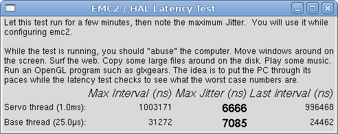

1.3.1 Latency Test
While the test is running, you should "abuse" the computer. Move windows around on the screen. Surf the web. Copy some large files around on the disk. Play some music. Run an OpenGL program such as glxgears. The idea is to put the PC through its paces while the latency test checks to see what the worst case numbers are. Do not run EMC2 while the latency test is running. Run the test at least a few minutes. The longer you run the test the better it will be at catching events that might occour at less frequent intervals. This is a test for your computer only, so no hardware needs to be connected to run the test.
Figure: Latency Test
Latency is how long it takes the PC to stop what it is doing and respond to an external request. In our case, the request is the periodic "heartbeat" that serves as a timing reference for the step pulses. The lower the latency, the faster you can run the heartbeat, and the faster and smoother the step pulses will be.
Latency is far more important than CPU speed. The CPU isn't the only factor in determining latency. Motherboards, video cards, USB ports, SMI issues, and a number of other things can hurt the latency.
The important numbers are the "max jitter". In the example above 7085 nanoseconds is the highest jitter. Record this number, and enter it in the Base Period Maximum Jitter box.
If your Max Jitter number is less than about 15-20 microseconds (15000-20000 nanoseconds), the computer should give very nice results with software stepping. If the max latency is more like 30-50 microseconds, you can still get good results, but your maximum step rate might be a little disappointing, especially if you use microstepping or have very fine pitch leadscrews. If the numbers are 100uS or more (100,000 nanoseconds), then the PC is not a good candidate for software stepping. Numbers over 1 millisecond (1,000,000 nanoseconds) mean the PC is not a good candidate for EMC, regardless of whether you use software stepping or not.

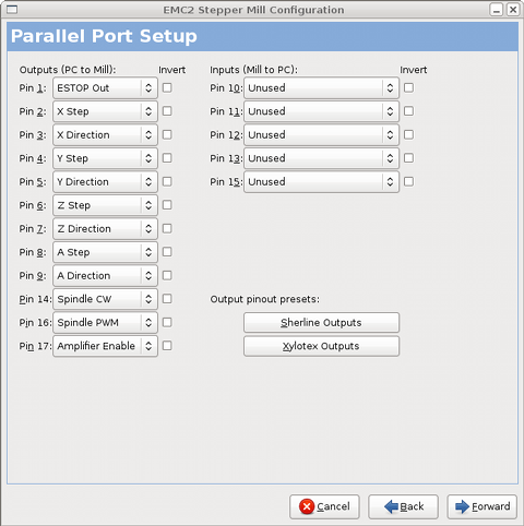

1.4 Parallel Port Setup
Figure: Parallel Port Setup Page
For each pin, choose the signal which matches your parallel port pin out. Turn on the "invert" check box if the signal is inverted (0V for true/active, 5V for false/inactive).
- Output pinout presets
- Automatically set pins 2 through 9 according to the Sherline standard (Direction on pins 2, 4, 6, 8) or the Xylotex standard (Direction on pins 3, 5, 7, 9).
- Inputs and Outputs
- If the input or output is not used set the option to "Unused".
- External E Stop
- This can be selected from an input pin drop down box. A typical E Stop chain uses all normally closed contacts.
- Homing & Limit Switches
- These can be selected from an input pin drop down box for most configurations.
- Charge Pump
- If your driver board requires a charge pump signal simply select Charge Pump from the drop down list for the output pin you wish to connect to your charge pump input. The charge pump output is connected to the base thread by Stepconf. The charge pump output will be about 1/2 of the maximum step rate shown on the Basic Machine Configuration page.

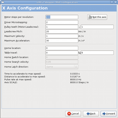

1.5 Axis Configuration
Figure: Axis Configuration Page- Motor Steps Per Revolution
- The number of full steps per motor revolution. If you know how many degrees the motor is (e.g., 1.2 degree), then divide 360 by the degrees to find the number of steps per motor revolution.
- Driver Microstepping
- The amount of microstepping performed by the driver. Enter "2" for half-stepping.
- Pulley Ratio
- If your machine has pulleys between the motor and leadscrew, enter the ratio here. If not, enter "1:1".
- Leadscrew Pitch
- Enter the pitch of the leadscrew here. If you chose "Inch" units, enter the number of threads per inch here (e.g., enter 8 for 8TPI). If you have a multi-lead screw then you need to know how many turns per inch it takes to move the "nut". If you chose "mm" units, enter the number of millimeters the "nut" would move per revolution here (e.g., enter 2 for 2mm/rev). If the machine travels in the wrong direction, enter a negative number here instead of a positive number or invert the direction pin for the axis.
- Maximum Velocity
- Enter the maximum velocity for the axis in units per second.
- Maximum Acceleration
- The correct values for these items can only be determined through experimentation. See "Finding Velocity and Acceleration" below.
- Home Location
- The position the machine moves to after completing the homing procedure for this axis. For machines without home switches, this is the location the operator manually moves the machine to before pressing the Home button. If you combine the home and limit switches you must move off of the switch to the home position or you will get a joint limit error.
- Table Travel
- The range of travel that g code programs must not exceed. The home location must be inside the Table Travel. In particular, having Home Location exactly equal to one of the Table Travel values is incorrect configuration
- Home Switch Location
- The location at which the home switch trips or releases during the homing process. This item and the two below only appear when Home Switches were chosen in the Parallel Port Pinout. If you combine home and limit switches the home switch location can not be the same as the home position or you will get a joint limit error.
- Home Search Velocity
- The velocity to use when moving towards the switch. If the switch is near the end of travel, this velocity must be chosen so that the axis can decelerate to a stop before hitting the end of travel. If the switch is only closed for a short range of travel (instead of being closed from its trip point to one end of travel), this velocity must be chosen so that the axis can decelerate to a stop before the switch opens again, and homing must always be started from the same side of the switch.
If the machine moves the wrong direction at the beginning of the homing procedure, negate the value of Home Search Velocity. - Home Latch Direction
- Choose "Same" to have homing back off the switch, then approach it again at a very low speed. The second time the switch closes, the home position is set.
Choose "Opposite" to have homing slowly back off the switch. When the switch opens, the home position is set. - Time to accelerate to max speed
- Distance to accelerate to max speed
- Pulse rate at max speed
- Information computed based on the values entered above. The greatest Pulse rate at max speed determines the BASE_PERIOD, and values above 20000Hz may lead to slow response time or even lockups (the fastest usable pulse rate varies from computer to computer)
- Axis SCALE:
- The number that will be used in the ini file [SCALE] setting. This is how many steps per user unit.
- Test this axis
- This will open a window to allow testing for each axis. This can be used after filling out all the information for this axis.

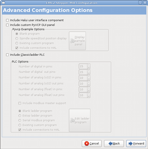

1.7 Advanced Configuration Options
Figure: Advanced Configuration- Include Halui
- This will add the Halui user interface component. See the Integrators Manual for more information on Halui.
- Include pyVCP
- This option adds the pyVCP panel base file or a sample file to work on. See the Integrators Manual for more information on pyVCP.
- Include ClassicLadder PLC
- This option will add the ClassicLadder PLC (Programmable Logic Controller). See the Integrators Manual for more information on ClassicLadder.

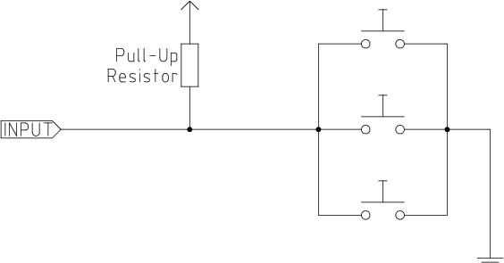

1.10 Home and Limit Switch wiring options
The ideal wiring for external switches would be one input per switch. However, the PC parallel port only offers a total of 5 inputs, while there are as many as 9 switches on a 3-axis machine. Instead, multiple switches are wired together in various ways so that a smaller number of inputs are required.
The figures below show the general idea of wiring multiple switches to a single input pin. In each case, when one switch is actuated, the value seen on INPUT goes from logic HIGH to LOW. However, EMC expects a TRUE value when a switch is closed, so the corresponding "Invert" box must be checked on the pinout configuration page.
![](switch-nc-series.png)
Wiring N/C switches in series (simplified diagram)
Figure: Normally Closed Switches
![](switch-no-parallel.png)
Wiring N/O switches in parallel (simplified diagram)
Figure: Normally Open Switches
The following combinations of switches are permitted in Stepconf:
- Combine home switches for all axes
- Combine limit switches for all axes
- Combine both limit switches for one axis
- Combine both limit switches and the home switch for one axis
- Combine one limit switch and the home switch for one axis
The last two combinations are also appropriate when a "home to limit" is used.
