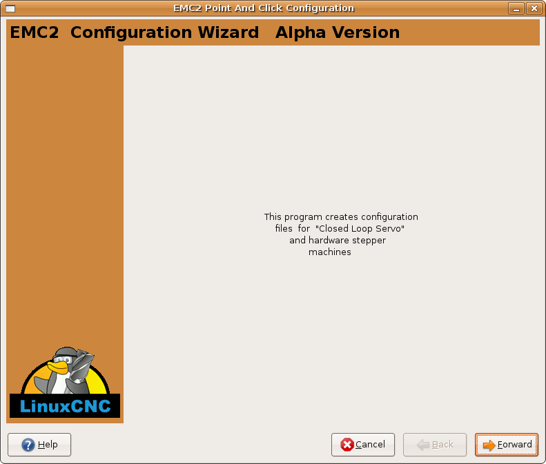

1 Point n Click Configurator
The Point n Click Configurator covers Mesa cards and parallel port stepper configurations. If you have a simple parallel port stepper machine the StepConf Wizard might be a better choice. The Point n Click Configurator can generate some advanced configurations without knowing anything about HAL.
Start the PnCConf program from the CNC menu or from a terminal window with pncconf. For more information on the terminal window see the Linux FAQ section.
Figure: PnCConf Splash

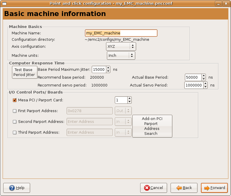

1.1 Basic Machine Information
- Machine Name:
- What you want to call your machine and must not have any spaces.
Figure: PnCConf Basic

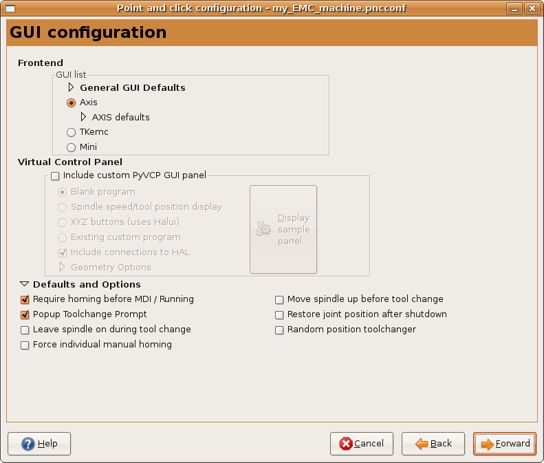

1.2 GUI Configuration
Here you can select from different GUI's and options for each one.
Figure: GUI Configuration

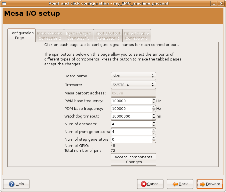

1.3 Mesa Configuration
Figure: Mesa Configuration

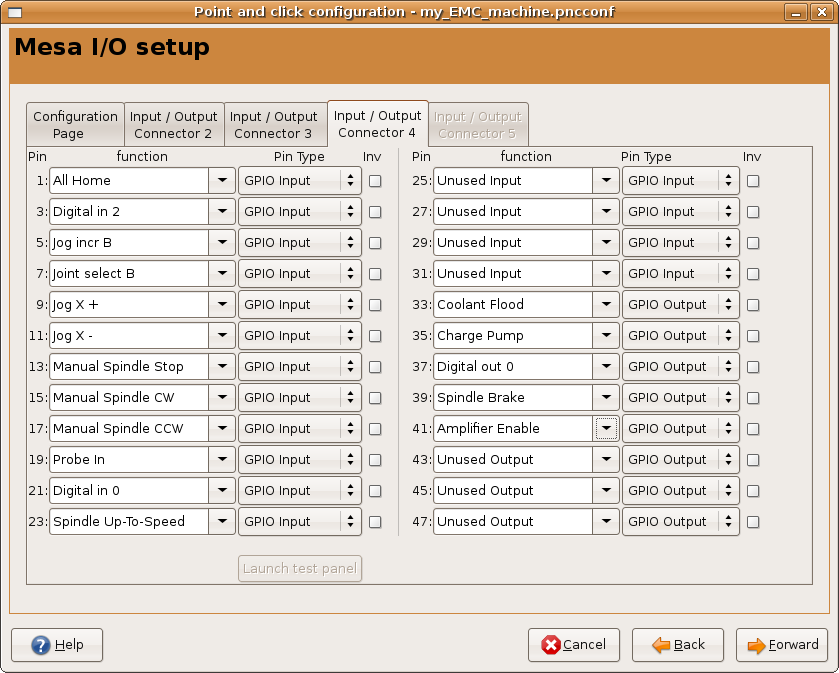

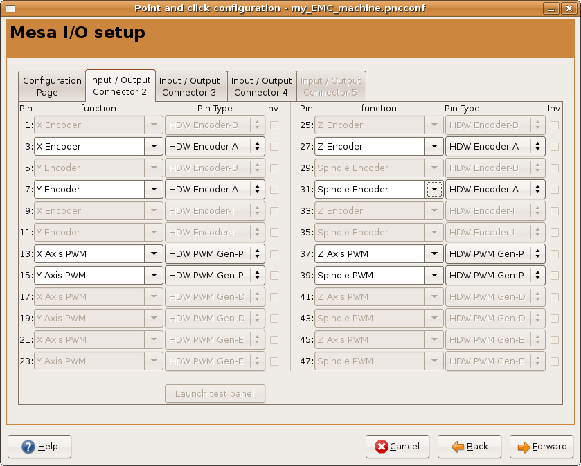

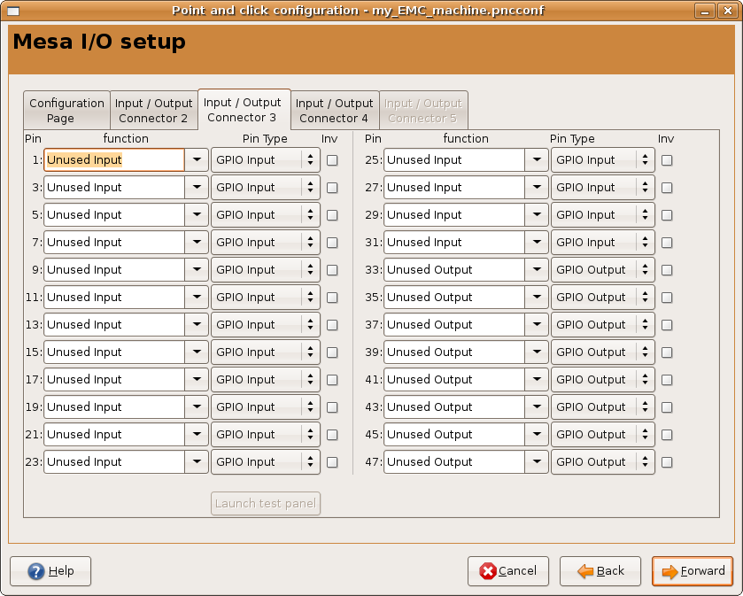

1.4 Mesa I/O Setup
Figure: Mesa I/O C2
Figure: Mesa I/O C3
Figure: Mesa I/O C4

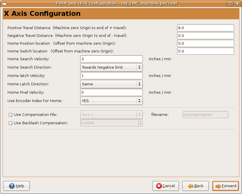

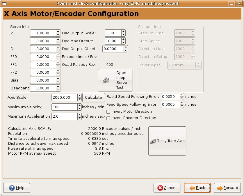

1.5 Axis Configuration
Figure: Axis Drive Configuration
Figure: Axis Configuration

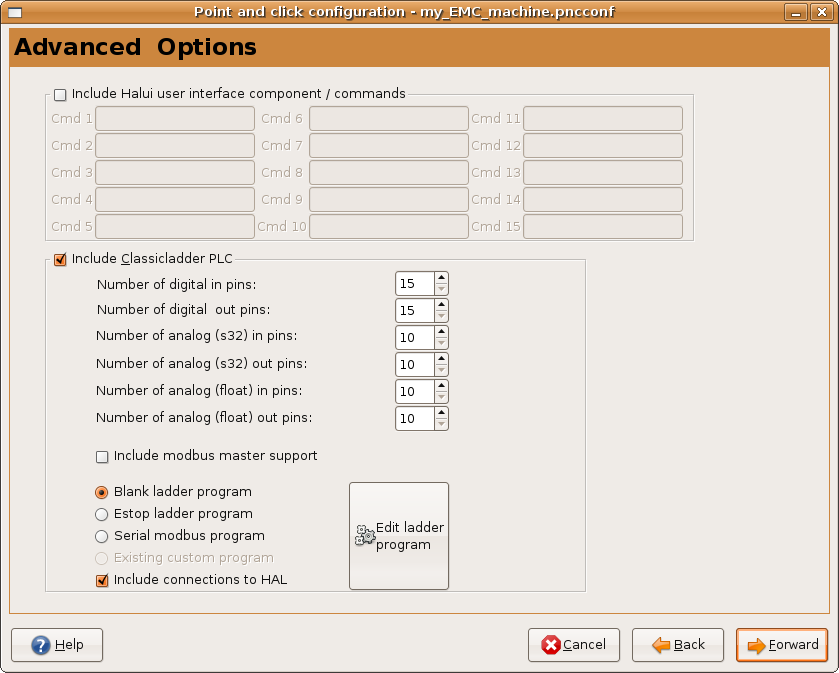

1.6 Advanced Options
Figure: Advanced Options
