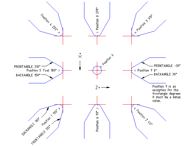

1.2 Tool Files
Lathe Tool Files differ from mill tool files by the addition of FRONTANGLE, BACKANGLE and ORIENT. The following table show the lathe format for a tool table. Use the "DIA" column for the tool tip diameter.

The Tool Table can be set using G10 L1 with the exception of FRONTANGLE ,BACKANGLE and COMMENT which must be set manually at this time.
The following figure shows the lathe tool orientations with the center line angle of each orientation and info on FRONTANGLE and BACKANGLE.
Figure: Lathe Tool Orientations
