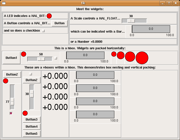

The following graphic displays many of the pyVCP widgets.

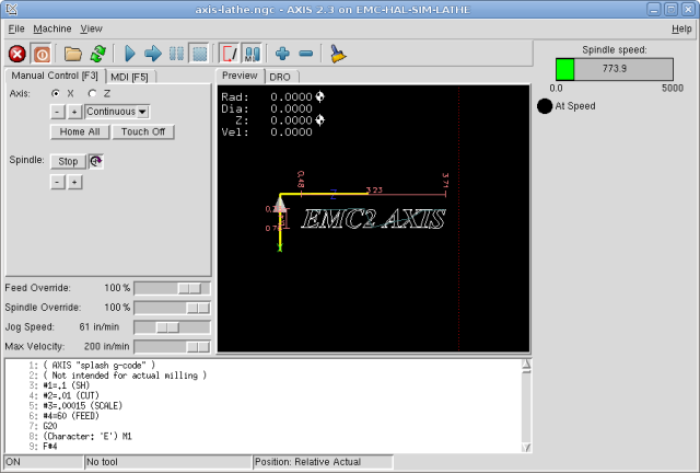

This is what the newly created pyVCP panel should look like in AXIS. The sim/lathe configuration is already configured this way.
