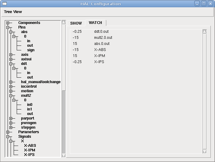

net xpos-cmd ddt.0.in
net X-IPS mult2.0.in0 <= ddt.0.out
net X-ABS abs.0.in <= mult2.0.out
net X-IPM abs.0.out
In this last section we are setting the mult2.0.in1 to 60 to convert the inch per second to inch per minute that we get from the ddt.0.out.
The xpos-cmd sends the commanded position to the ddt.0.in. The ddt computes the derivative of the change of the input.
The ddt2.0.out is multiplied by 60 to give IPM.
The mult2.0.out is sent to the abs to get the absolute value.
The following figure shows the result when the X axis is moving at 15 IPM in the minus direction. Notice that we can get the absolute value from either the abs.0.out pin or the X-IPM signal.

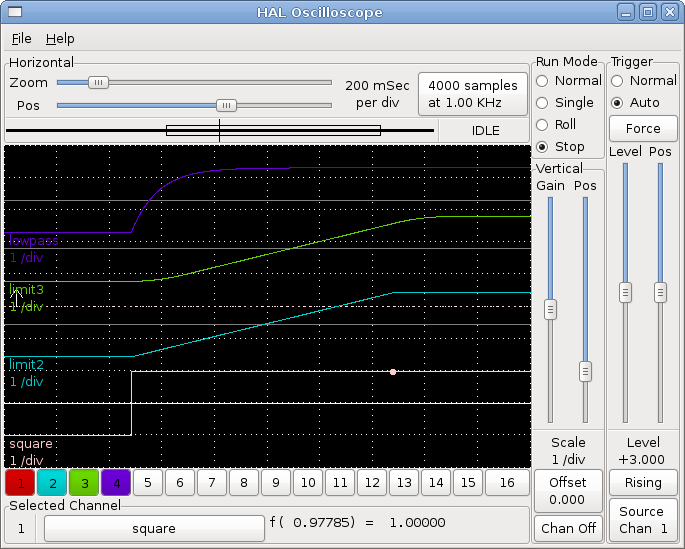

loadusr halscope
Open a terminal window and run the file with the following command.
halrun -I softstart.hal
When the HAL Oscilloscope first starts up click "OK" to accept the default thread.
Next you have to add the signals to the channels. Click on channel 1 then select "square" from the Signals tab. Repeat for channels 2-4 and add lowpass, limit2, and limit3.
Next to set up a trigger signal click on the Source None button and select square. The button will change to Source Chan 1.
Next click on Single in the Run Mode radio buttons box. This will start a run and when it finishes you will see your traces.
To separate the signals so you can see them better click on a channel then use the Pos slider in the Vertical box to set the positions.
Figure: Softstart
To see the effect of changing the set point values of any of the components you can change them in the terminal window. To see what different gain settings do for lowpass just type the following in the terminal window and try different settings.
setp lowpass.0.gain .01
After changing a setting run the oscilloscope again to see the change.
When your finished type "exit" in the terminal window to shut down halrun and close the halscope. Don't close the terminal window with halrun running as it might leave some things in memory that could prevent EMC from loading.

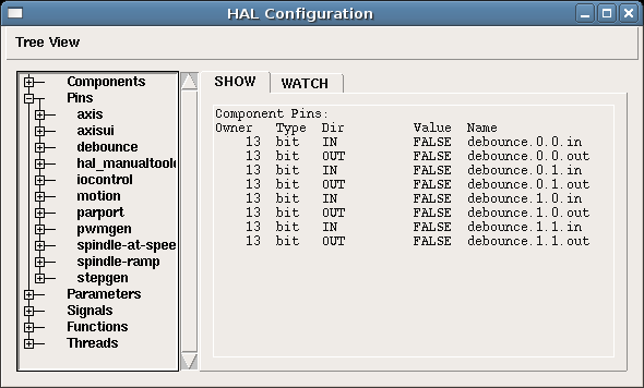

The debounce components are created in groups with the size of the group determined by the configuration when loaded. This allows the integrator to set the parameters of a group with one line in the HAL file and to add the group to a thread with one line. In the following example 2 groups are created with 2 filters to show how the addressing works. If your using a Stepconf Wizard generated configuration put the following in your custom.hal file.
# load the debounce component
loadrt debounce cfg=2,2
# add each debounce group to different threads just for an example
addf debounce.0 servo-thread
addf debounce.1 base-thread
# set the debounce delay for group 0 to two cycles of the servo-thread
setp debounce.0.delay 2
# set the debounce delay for group 1 to three cycles of the base-thread
setp debounce.1.delay 3
Now when you run EMC and look in the HAL Configuration window you will see the two debounce groups.
Figure: Debounce Groups
