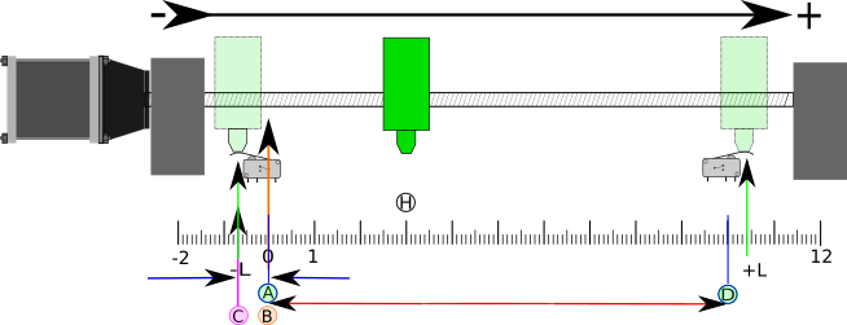

3. Separate Home Switch Example Layout
This example shows minimum and maximum limit switches with a separate home switch.
Example Homing Switch layout
  • A is the negative soft limit
  • B is the G53 machine coordinate Origin
  • C is the home switch trip point
  • D is the positive soft limit
  • H is the final home position (HOME) = 0 units
  • The -L and +L are the limit switches trip points
  • A<->B is the negative soft limits (MIN_LIMITS) = -3 units
  • B<->C is the home_offset (HOME_OFFSET) = -2.3 units
  • B<->D is the positive soft limits (MAX_LIMITS) = 7 units
  • A<->D is the total travel = 10 units
  • The distance between the limit switches and soft limits (-L<->A and D<-+L) is magnified in this example
  • Note that there is distance between the limit switches and actual physical hard contact for coasting after the amplifier is disabled.
Homing sets the G53 coordinate system, while the machine origin (zero point) can be anywhere, setting the zero point at the negative soft limit makes all G53 coordinates positive, which is probably easiest to remember. Do this by setting MIN_LIMIT = 0 and make sure MAX_LIMIT is positive.

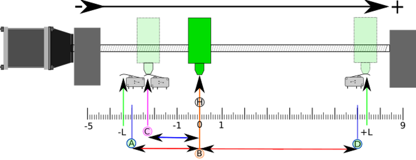

4. Shared Limit/Home Switch Example Layout
This example shows a maximum limit switch and a combined minimum limit/home switch.
Example shared Home Limit Switch layout
  • A is the negative soft limit.
  • B is the G53 machine coordinate Origin.
  • C is the home switch trip point shared with (-L) minimum limit trip.
  • D is the positive soft limit.
  • H is the final home position (HOME) = 3 units.
  • The -L and +L are the limit switch trip points.
  • A<->B is the negative soft limits (MIN_LIMITS) = 0 units.
  • B<->C is the home_offset (HOME_OFFSET) = -0.7 units.
  • B<->D is the positive soft limits (MAX_LIMITS) 10 units.
  • A<->D is the total travel = 10 units.
  • The distance between the limits switches and soft limits (-L<->A and D<->+L) is magnified in this example.

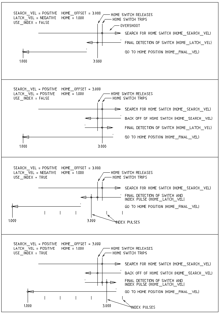

5. Homing Sequence
There are four possible homing sequences defined by the sign of HOME_SEARCH_VEL and HOME_LATCH_VEL, along with the associated configuration parameters as shown in the following table. Two basic conditions exist, HOME_SEARCH_VEL and HOME_LATCH_VEL are the same sign or they are opposite signs. For a more detailed description of what each configuration parameter does, see the following section.
Homing Sequences
