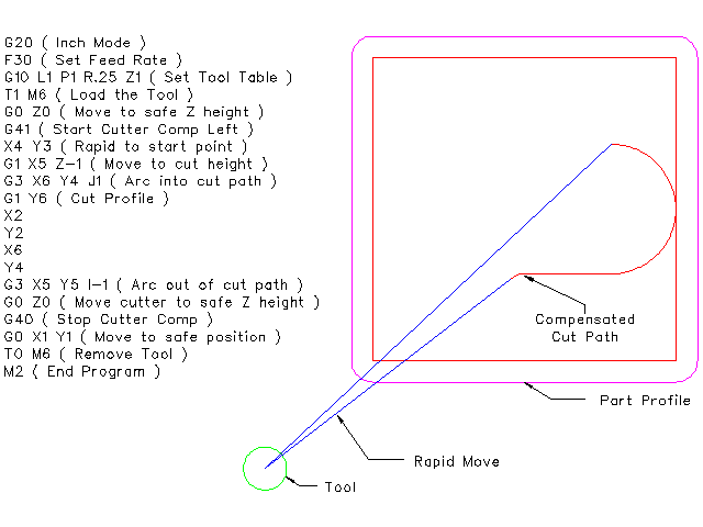

4.2.1. Outside Profile Example
Outside Profile
Figure 4. Outside Profile

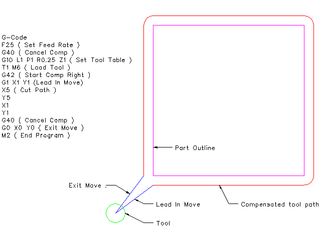

4.2.2. Inside Profile Example
Inside Profile
Figure 5. Inside Profile
