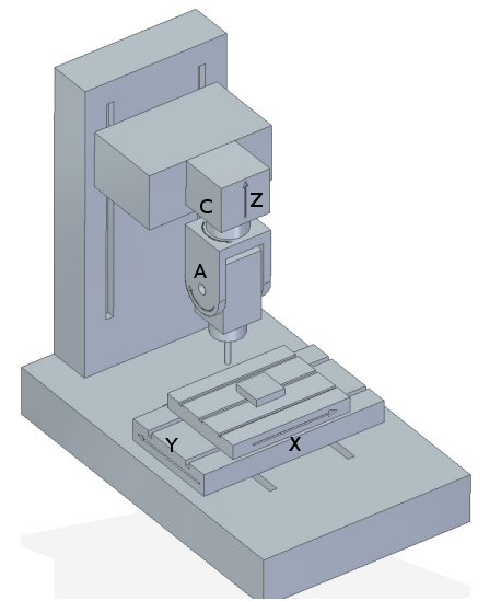

In this section we deal with the typical 5-axis milling or router machines with five joints or degrees-of-freedom which are controlled in coordinated moves.
3-axis machine tools cannot change the tool orientation, so 5-axis machine tools use two extra axes to set the cutting tool in an appropriate orientation for efficient machining of freeform surfaces.
Typical 5-axis machine tool configurations are shown in Figs. 3, 5, 7 and 9-11 [1,2] in section Figures.

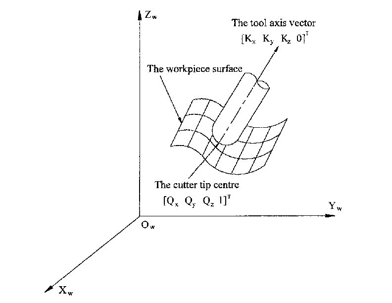

3. Tool Orientation and Location
CAD/CAM systems are typically used to generate the 3D CAD models of the workpiece as well as the CAM data for input to the CNC 5-axis machine. The tool or cutter location (CL) data, is composed of the cutter tip position and the cutter orientation relative to the workpiece coordinate system. Two vectors, as generated by most CAM systems and shown in Fig. 1, contain this information:
![5-axis-figures/equation__1.png](5-axis-figures/equation__1.png)
The K vector is equivalent to the 3rd vector from the pose matrix E6 that was used in the 6-axis robot kinematics [3] and the Q vector is equivalent to the 4th vector of E6. In MASTERCAM for example this information is contained in the intermediate output ".nci" file.

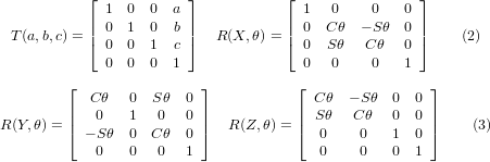

4. Translation and Rotation Matrices
Homogenous transformations provide a simple way to describe the mathematics of multi-axis machine kinematics. A transformation of the space H is a 4x4 matrix and can represent translation and rotation transformations. Given a point x,y,x described by a vector u = {x,y,z,1}T, then its transformation v is represented by the matrix product
![5-axis-figures/equation__2.png](5-axis-figures/equation__2.png)
There are four fundamental transformation matrices on which 5-axis kinematics can be based:
![5-axis-figures/equation__3.png](5-axis-figures/equation__3.png)
The matrix T(a,b,c) implies a translation in the X, Y, Z coordinate directions by the amounts a, b, c respectively. The R matrices imply rotations of the angle theta about the X, Y and Z coordinate axes respectively. The C and S symbols refer to cosine and sine functions respectively.

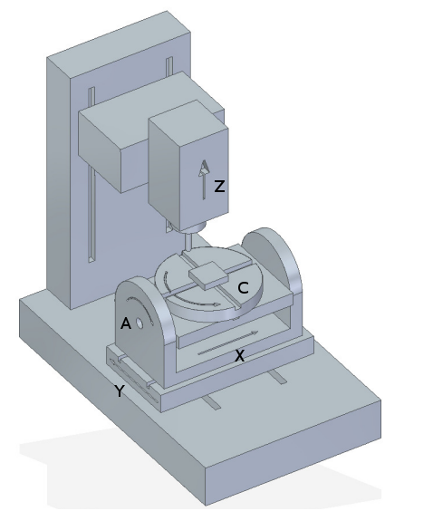

5. Table Rotary/Tilting 5-Axis Configurations
In these machine tools the two rotational axes mount on the work table of the machine. Two forms are typically used:
A rotary table which rotates about the vertical Z-axes (C-rotation, secondary) mounted on a tilting table which rotates about the X- or Y-axis (A- or B-rotation, primary). The workpiece is mounted on the rotary table.
A tilting table which rotates about the X- or Y-axis (A- or B-rotation, secondary) is mounted on a rotary table which rotates about the Z-axis (C-rotation, primary), with the workpiece on the tilting table.

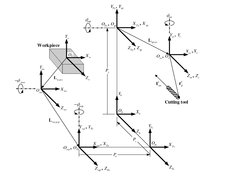

A multi-axis machine can be considered to consist of a series of links connected by joints. By embedding a coordinate frame in each link of the machine and using homogeneous transformations, we can describe the relative position and orientation between these coordinate frames
We need to describe a relationship between the workpiece coordinate system and the tool coordinate system. This can be defined by a transformation matrix wAt, which can be found by subsequent transformations between the different structural elements or links of the machine, each with its own defined coordinate system. In general such a transformation may look as follows:
![5-axis-figures/equation__4.png](5-axis-figures/equation__4.png)
where each matrix i-1Aj is a translation matrix T or a rotation matrix R of the form (2,3).
Matrix multiplication is a simple process in which the elements of each row of the lefthand matrix A is multiplied by the elements of each column of the righthand matrix B and summed to obtain an element in the result matrix C, ie.
![5-axis-figures/equation__5.png](5-axis-figures/equation__5.png)
In Fig. 2 a generic configuration with coordinate systems is shown [4]. It includes table rotary/tilting axes as well as spindle rotary/tilting axes. Only two of the rotary axes are actually used in a machine tool.
First we will develop the transformations for the first type of configuration mentioned above, ie. a table tilting/rotary (trt) type with no rotating axis offsets. We may give it the name xyzac-trt configuration.
We also develop the transformations for the same type (xyzac-trt), but with rotating axis offsets.
Then we develop the transformations for a xyzbc-trt configuration with rotating axis offsets.

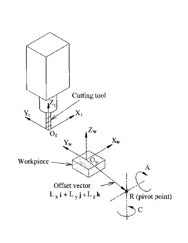

5.1. Transformations for a xyzac-trt machine tool with work offsets
![5-axis-figures/Figure-3.png](5-axis-figures/Figure-3.png)
We deal here with a simplified configuration in which the tilting axis and rotary axis intersects at a point called the pivot point as shown in Fig. 4. therefore the two coordinate systems Ows and Owp of Fig. 2 are coincident.

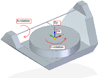

5.2. Transformations for a xyzac-trt machine with rotary axis offsets
![5-axis-figures/Figure-5.png](5-axis-figures/Figure-5.png)
We deal here with a extended configuration in which the tilting axis and rotary axis do not intersect at a point but have an offset Dy. Furthermore, there is also an z-offset between the two coordinate systems Ows and Owp of Fig. 2, called Dz. A vismach model is shown in Fig. 5 and the offsets are shown in Fig. 6 (positive offsets in this example). To simplify the configuration, the offsets Lx, Ly, Lz of the previous case are not included. They are probably not necessary if one uses the G54 offsets in LinuxCNC by means of the "touch of" facility.
![5-axis-figures/Figure-6.png](5-axis-figures/Figure-6.png)

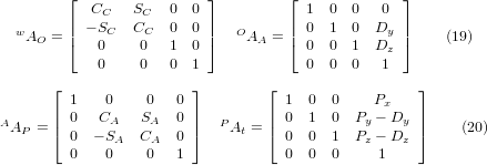

The transformation can be defined by the sequential multiplication of the matrices:
![5-axis-figures/equation__18.png](5-axis-figures/equation__18.png)
with the matrices built up as follows:
![5-axis-figures/equation__19.png](5-axis-figures/equation__19.png)
In these equations Dy, Dz defines the offsets of the pivot point of the rotary axes A relative to the workpiece coordinate system origin. Furthermore, Px, Py, Pz are the relative distances of the pivot point to the cutter tip position, which can also be called the "joint coordinates" of the pivot point. The pivot point is on the A rotary axis.
When multiplied in accordance with (18), we obtain:
![5-axis-figures/equation__20.png](5-axis-figures/equation__20.png)

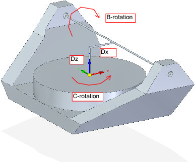

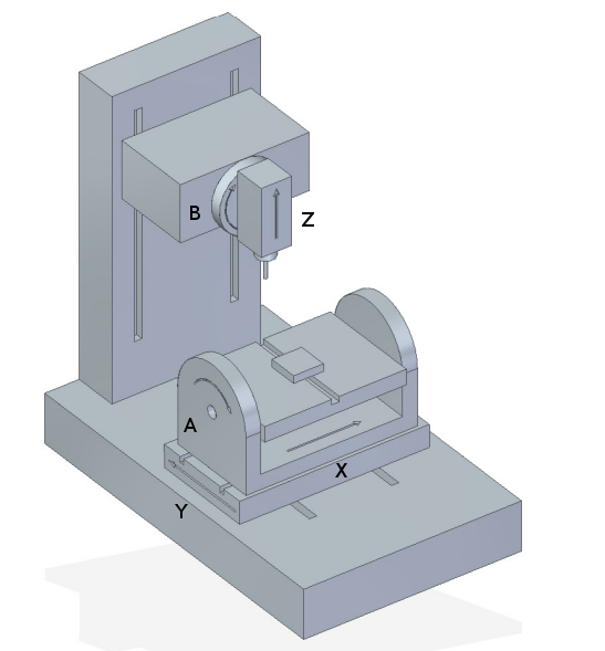

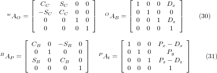

5.3. Transformations for a xyzbc-trt machine with rotary axis offsets
![5-axis-figures/Figure-7.png](5-axis-figures/Figure-7.png)
We deal here again with a extended configuration in which the tilting axis (about the y-axis) and rotary axis do not intersect at a point but have an offset Dx. Furthermore, there is also an z-offset between the two coordinate systems Ows and Owp of Fig. 2, called Dz. A vismach model is shown in Fig. 7 (negative offsets in this example) and the positive offsets are shown in Fig. 8.
![5-axis-figures/Figure-8.png](5-axis-figures/Figure-8.png)
5.3.1. Forward Transformation
![5-axis-figures/equation__28.png](5-axis-figures/equation__28.png)
![5-axis-figures/equation__29.png](5-axis-figures/equation__29.png)
In these equations Dx, Dz defines the offsets of the pivot point of the rotary axes B relative to the workpiece coordinate system origin. Furthermore, Px, Py, Pz are the relative distances of the pivot point to the cutter tip position, which can also be called the "joint coordinates" of the pivot point. The pivot point is on the B rotary axis.
When multiplied in accordance with (29), we obtain:
![5-axis-figures/equation__30.png](5-axis-figures/equation__30.png)
We can now equate the third column of this matrix with our given tool orientation vector K, ie.:
![5-axis-figures/equation__31.png](5-axis-figures/equation__31.png)
From these equations we can solve for the rotation angles thetaB, thetaC. From the third row we find:
![5-axis-figures/equation__32.png](5-axis-figures/equation__32.png)
and by dividing the second row by the first row we find:
![5-axis-figures/equation__33.png](5-axis-figures/equation__33.png)
These relationships are typically used in the CAM post-processor to convert the tool orientation vectors to rotation angles.
Equating the last column of (32) with the tool position vector Q, we can write:
![5-axis-figures/equation__34.png](5-axis-figures/equation__34.png)
The vector on the right hand side can also be written as the product of a matrix and a vector resulting in:
![5-axis-figures/equation__35.png](5-axis-figures/equation__35.png)
which is the forward transformation of the kinematics.
5.3.2. Inverse Transformation
We can solve for P from equation (37) as P = (QAP)-1 * Q. With the same approach as before, we obtain:
![5-axis-figures/equation__36.png](5-axis-figures/equation__36.png)
The desired equations for the inverse transformation of the kinematics thus can be written as:
![5-axis-figures/equation__37.png](5-axis-figures/equation__37.png)

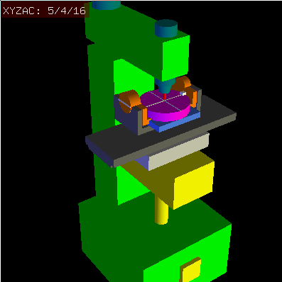

LinuxCNC includes kinematics modules for the xyzac-trt and xyzbc-trt topologies described in the mathematics detailed above. For interested users, the source code is available in the git tree in the src/emc/kinematics/ directory.
Example xyzac-trt and xyzbc-trt simulation configurations are located in the Sample Configurations (configs/sim/axis/vismach/5axis/table-rotary-tilting/) directory.
The example configurations include the required ini files and an examples subdirectory with gode (.ngc) files. These sim configurations invoke a realistic 3-dimensional model using the LinuxCNC vismach facility.

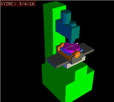

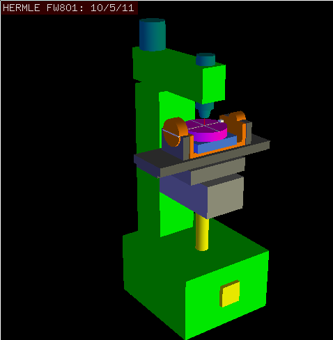

6.1. Vismach Simulation Models
Vismach is a library of python routines to display a dynamic simulation of a CNC machine on the PC screen. The python script for a particular machine is loaded in HAL and data passed by HAL pin connections. The user-space vismach model is loaded by a hal command like:
loadusr -W xyzac-trt-gui
and connections are made using HAL commands like:
net :table-x joint.0.pos-fb xyzac-trt-gui.table-x net :saddle-y joint.1.pos-fb xyzac-trt-gui.saddle-y ...
See the simulation ini files for details of the HAL connections used for the vismach model.
