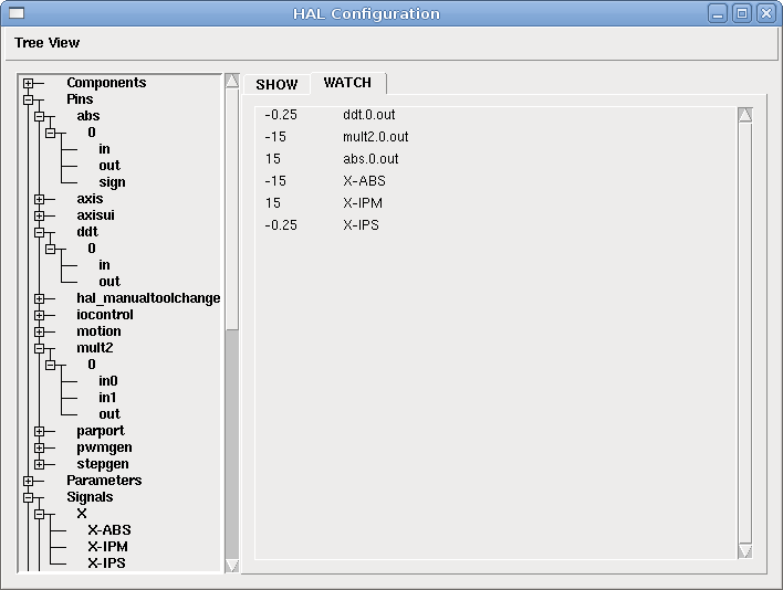

3. Compute Velocity
This example uses ddt, mult2 and abs to compute the velocity of a single axis. For more information on the real time components see the man pages or the HAL Components List ([sec:hal-components]).
The first thing is to check your configuration to make sure you are not using any of the real time components all ready. You can do this by opening up the HAL Configuration window and look for the components in the pin section. If you are then find the HAL file that they are being loaded in and increase the counts and adjust the instance to the correct value. Add the following to your custom.hal file.
Load the realtime components.
loadrt ddt count=1 loadrt mult2 count=1 loadrt abs count=1
Add the functions to a thread so it will get updated.
addf ddt.0 servo-thread addf mult2.0 servo-thread addf abs.0 servo-thread
Make the connections.
setp mult2.in1 60 net xpos-cmd ddt.0.in net X-IPS mult2.0.in0 <= ddt.0.out net X-ABS abs.0.in <= mult2.0.out net X-IPM abs.0.out
In this last section we are setting the mult2.0.in1
to 60 to convert the inch per second to inch per minute (IPM) that we get from the ddt.0.out
The xpos-cmd
sends the commanded position to the ddt.0.in
The ddt computes the derivative of the change of the input.
The ddt2.0.out
is multiplied by 60 to give IPM.
The mult2.0.out
is sent to the abs
to get the absolute value.
The following figure shows the result when the X axis is moving at 15 IPM in the minus direction.
Notice that we can get the absolute value from either the abs.0.out
pin or the X-IPM
signal.

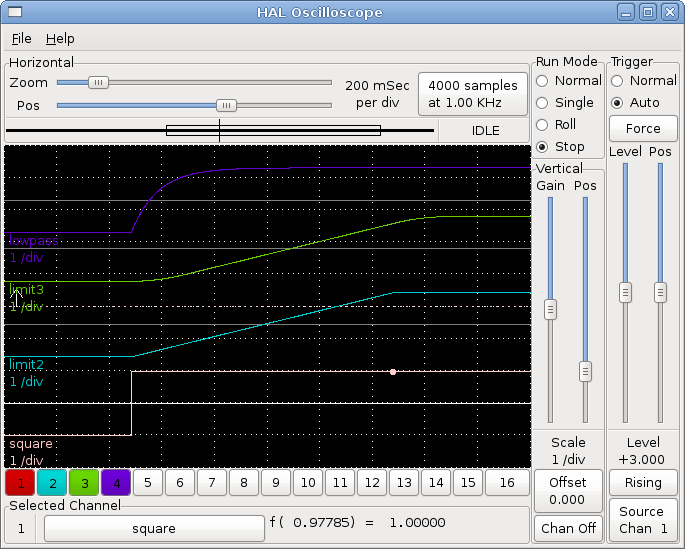

4. Soft Start Details
This example shows how the HAL components lowpass, limit2 or limit3 can be used to limit how fast a signal changes.
In this example we have a servo motor driving a lathe spindle.
If we just used the commanded spindle speeds on the servo it will try to go from present speed to commanded speed as fast as it can.
This could cause a problem or damage the drive.
To slow the rate of change we can send the spindle.N.speed-out
through a limiter before the PID, so that the PID command value changes to new settings more slowly.
Three built-in components that limit a signal are:
limit2 limits the range and first derivative of a signal.
limit3 limits the range, first and second derivatives of a signal.
lowpass uses an exponentially-weighted moving average to track an input signal.
To find more information on these HAL components check the man pages.
Place the following in a text file called softstart.hal. If you’re not familiar with Linux place the file in your home directory.
loadrt threads period1=1000000 name1=thread loadrt siggen loadrt lowpass loadrt limit2 loadrt limit3 net square siggen.0.square => lowpass.0.in limit2.0.in limit3.0.in net lowpass <= lowpass.0.out net limit2 <= limit2.0.out net limit3 <= limit3.0.out setp siggen.0.frequency .1 setp lowpass.0.gain .01 setp limit2.0.maxv 2 setp limit3.0.maxv 2 setp limit3.0.maxa 10 addf siggen.0.update thread addf lowpass.0 thread addf limit2.0 thread addf limit3.0 thread start loadusr halscope
Open a terminal window and run the file with the following command.
halrun -I softstart.hal
When the HAL Oscilloscope first starts up click OK to accept the default thread.
Next you have to add the signals to the channels. Click on channel 1 then select square from the Signals tab. Repeat for channels 2-4 and add lowpass, limit2, and limit3.
Next to set up a trigger signal click on the Source None button and select square. The button will change to Source Chan 1.
Next click on Single in the Run Mode radio buttons box. This will start a run and when it finishes you will see your traces.
To separate the signals so you can see them better click on a channel then use the Pos slider in the Vertical box to set the positions.
To see the effect of changing the set point values of any of the components you can change them in the terminal window. To see what different gain settings do for lowpass just type the following in the terminal window and try different settings.
setp lowpass.0.gain *.01
After changing a setting run the oscilloscope again to see the change.
When you’re finished type exit in the terminal window to shut down halrun and close the halscope. Don’t close the terminal window with halrun running as it might leave some things in memory that could prevent LinuxCNC from loading.
For more information on Halscope see the HAL manual and the tutorial.
