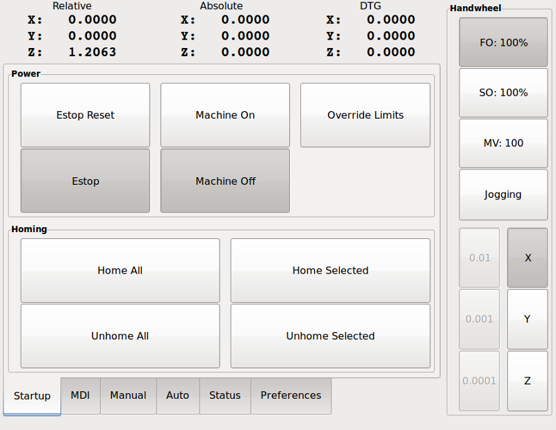

Touchy is a user interface for LinuxCNC meant for use on machine control panels, and therefore does not require keyboard or mouse.
It is meant to be used with a touch screen, and works in combination with a wheel/MPG and a few buttons and switches.
The Handwheel tab has radio buttons to select between Feed Override, Spindle Override, Maximum Velocity and Jogging functions for the wheel/MPG input. Radio buttons for axis selection and increment for jogging are also provided.
Touchy GUI

To use Touchy, in the [DISPLAY] section of your INI file change the display selector line to DISPLAY = touchy.
2.2. Preferences
When you start Touchy the first time, check the Preferences tab. If using a touchscreen, choose the option to hide the pointer for best results.
The Status Window is a fixed height, set by the size of a fixed font. This can be affected by the Gnome DPI, configured in System / Preferences / Appearance / Fonts / Details. If the bottom of the screen is cut off, reduce the DPI setting.
All other font sizes can be changed on the Preferences tab.
