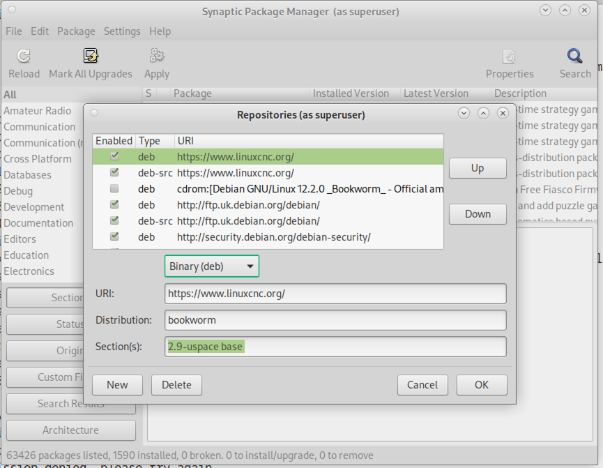

1.1. Apt Sources Configuration
  • Open the Software Sources window. The process for doing this differs slightly on the three supported platforms:
    • Debian:
      • Click on Applications Menu, then System, then Synaptic Package Manager.
      • In Synaptic, click on the Settings menu, then click Repositories to open the Software Sources window.
    • Ubuntu Precise:
      • Click on the Dash Home icon in the top left.
      • In the Search field, type "software", then click on the Ubuntu Software Center icon.
      • In the Ubuntu Software Center window, click on the Edit menu, then click on Software Sources... to open the Software Sources window.
    • Ubuntu Lucid:
      • Click the System menu, then Administration, then Synaptic Package Manager.
      • In Synaptic, click on the Settings menu, then click on Repositories to open the Software Sources window.
  • In the Software Sources window, select the Other Software tab.
  • Delete or un-check all the old linuxcnc.org entries (leave all non-linuxcnc.org lines as they are).
  • Click the Add button and add a new apt line. The line will be slightly different on the different platforms:
Table 1. Tabular overview on variants of the Operating System and the corresponding configuration of the repository. The configuration can be performed in the GUI of the package manager or in the file /etc/apt/sources.list.
OS / Realtime Version Repository
Debian Buster - preempt
deb https://linuxcnc.org buster base 2.9-rtpreempt
Debian Buster - RTAI
Debian Bullseye - preempt
deb https://linuxcnc.org bullseye base 2.9-uspace
Debian Bookworm - preempt
deb https://linuxcnc.org bookworm base 2.9-uspace
Debian Bookworm - RTAI
deb https://linuxcnc.org bookworm base 2.9-rt
Setting apt sources
Figure 1. Figure with a screenshot of the repository configuration of the synaptic package manager.
  • Click Add Source, then Close in the Software Sources window. If it pops up a window informing you that the information about available software is out-of-date, click the Reload button.
