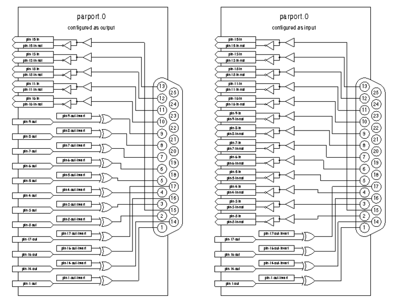

3. Pins
parport.<p>.pin-`__<n>__-out` (bit) Drives a physical output pin. -
parport.<p>.pin-`__<n>__-in` (bit) Tracks a physical input pin. -
parport.<p>.pin-`__<n>__-in-not` (bit) Tracks a physical input pin, but inverted.
For each pin, <p> is the port number, and <n> is the physical pin number in the 25 pin D-shell connector.
For each physical output pin, the driver creates a single HAL pin, for example: parport.0.pin-14-out.
For each physical input pin, the driver creates two HAL pins, for example: parport.0.pin-12-in and parport.0.pin-12-in-not.
The -in HAL pin is TRUE if the physical pin is high, and FALSE if the physical pin is low.
The -in-not HAL pin is inverted and is FALSE if the physical pin is high.
4. Parameters
parport.`__<p>__.pin-__<n>__-out-invert` (bit) Inverts an output pin. -
parport.`__<p>__.pin-__<n>__-out-reset` (bit) (only for-outpins) TRUE if this pin should be reset when the-resetfunction is executed. -
parport.`__<p>__.reset-time` (U32) The time (in nanoseconds) between a pin is set by-writeand reset by the-resetfunction if it is enabled.
The -invert parameter determines whether an output pin is active high or active low.
If -invert is FALSE, setting the HAL -out pin TRUE drives the physical pin high, and FALSE drives it low.
If -invert is TRUE, then setting the HAL -out pin TRUE will drive the physical pin low.
