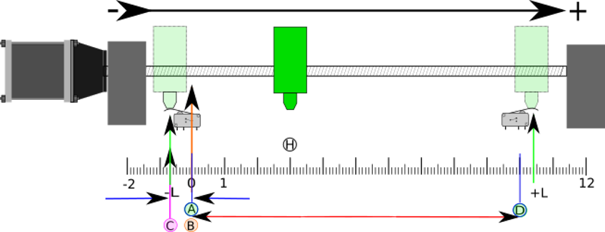

3. Separate Home Switch Example Layout
This example shows minimum and maximum limit switches with a separate home switch.
![Example Homing Switch layout](images/HomeAxisTravel_V2.png)
A is the negative soft limit
B is the G53 machine coordinate Origin
C is the home switch trip point
D is the positive soft limit
H is the final home position (HOME) = 0 units
The -L and +L are the limit switches trip points
A<->B is the negative soft limits (MIN_LIMITS) = -3 units
B<->C is the home_offset (HOME_OFFSET) = -2.3 units
B<->D is the positive soft limits (MAX_LIMITS) = 7 units
A<->D is the total travel = 10 units
The distance between the limit switches and soft limits (-L<->A and D<-+L) is magnified in this example
Note that there is distance between the limit switches and actual physical hard contact for coasting after the amplifier is disabled.

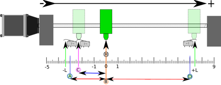

4. Shared Limit/Home Switch Example Layout
This example shows a maximum limit switch and a combined minimum limit/home switch.
![Example shared Home Limit Switch layout](images/HomeAxisTravel_V3.png)
A is the negative soft limit.
B is the G53 machine coordinate Origin.
C is the home switch trip point shared with (-L) minimum limit trip.
D is the positive soft limit.
H is the final home position (HOME) = 3 units.
The -L and +L are the limit switch trip points.
A<->B is the negative soft limits (MIN_LIMITS) = 0 units.
B<->C is the home_offset (HOME_OFFSET) = -0.7 units.
B<->D is the positive soft limits (MAX_LIMITS) 10 units.
A<->D is the total travel = 10 units.
The distance between the limits switches and soft limits (-L<->A and D<->+L) is magnified in this example.

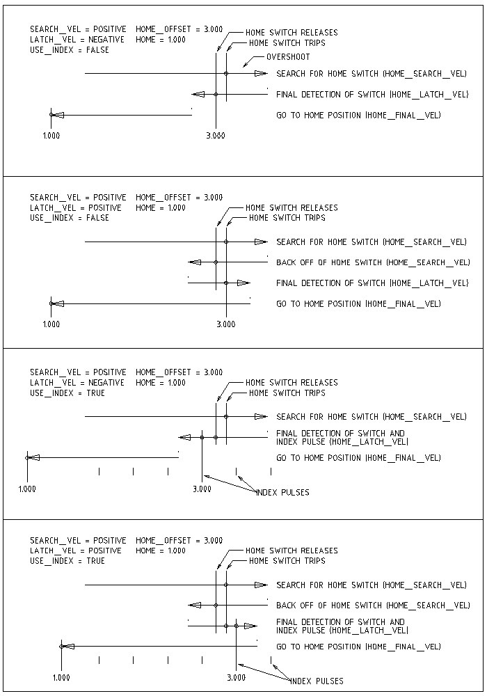

5. Homing Sequence
There are four possible homing sequences defined by the sign of HOME_SEARCH_VEL and HOME_LATCH_VEL, along with the associated configuration parameters as shown in the following table. Two basic conditions exist, HOME_SEARCH_VEL and HOME_LATCH_VEL are the same sign or they are opposite signs. For a more detailed description of what each configuration parameter does, see the following section.
![Homing Sequences](images/emc2-motion-homing-diag.png)
