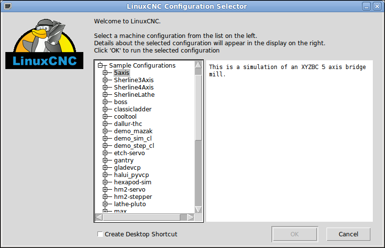

1.1. Configuration Selector
If no ini file is passed to the linuxcnc script it loads the configuration selector so you can choose and save a sample configuration. Once a sample configuration has been saved it can be modified to suit your application. The configuration files are saved in linuxcnc/configs directory.
LinuxCNC Configuration Selector
Figure 1. Configuration Selector
