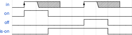

Toggle2nist can be used with a momentary push button to control a device that has separate on and off inputs and an is-on output.
• On a rising edge on pin in when is-on is low: It sets on until is-on becomes high.
• On a rising edge on pin in when is-on is high: It sets off until is-on becomes low.
Image ../man/images/toggle2nist.ps.png
