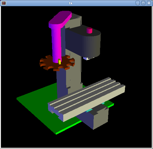

Vismach is a set of Python functions that can be used to create and animate models of machines. Vismach displays the model in a 3D viewport and the model parts are animated as the values of associated HAL pins change.
The Vismach viewport view can be manipulated as follows
  • zoom by scroll wheel or right button drag
  • pan by left button drag
  • rotate by middle-button drag or shift-drag.
