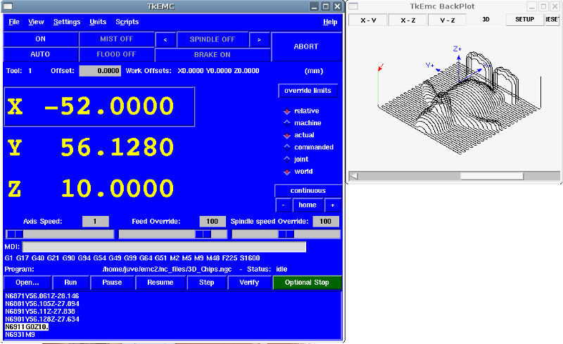

TkLinuxCNC is one of the first graphical front-ends for LinuxCNC. It is written in Tcl and uses the Tk toolkit for the display. Being written in Tcl makes it very portable (it runs on a multitude of platforms). A separate backplot window can be displayed as shown.
![TkLinuxCNC Window](images/tkemc.png)

The TkLinuxCNC window contains the following elements:
A menubar that allows you to perform various actions
A set of buttons that allow you to change the current working mode, start/stop spindle and other relevant I/O
Status bar for various offset related displays
Coordinate display area
A set of sliders which control Jogging speed, Feed Override , and Spindle speed Override which allow you to increase or decrease those settings
Manual data input text box MDI
Status bar display with active G-codes, M-codes, F- and S-words
Interpreter related buttons
A text display area that shows the G-code source of the loaded file

3.3. Coordinate Display Area
The main part of the display shows the current position of the tool. The color of the position readout depends on the state of the axis. If the axis is unhomed the axis will be displayed in yellow letters. Once homed it will be displayed in green letters. If there is an error with the current axis TkLinuxCNC will use red letter to show that. (for example if an hardware limit switch is tripped).
To properly interpret these numbers, refer to the radio boxes on the right. If the position is Machine, then the displayed number is in the machine coordinate system. If it is Relative, then the displayed number is in the offset coordinate system. Further down the choices can be actual or commanded. Actual refers to the feedback coming from encoders (if you have a servo machine), and the commanded refers to the position command send out to the motors. These values can differ for several reasons: Following error, deadband, encoder resolution, or step size. For instance, if you command a movement to X 0.0033 on your mill, but one step of your stepper motor is 0.00125, then the Commanded position will be 0.0033 but the Actual position will be 0.0025 (2 steps) or 0.00375 (3 steps).
Another set of radio buttons allows you to choose between joint and world view. These make little sense on a normal type of machine (e.g. trivial kinematics), but help on machines with non-trivial kinematics like robots or stewart platforms. (you can read more about kinematics in the Integrator Manual).
When the machine moves, it leaves a trail called the backplot. You can start the backplot window by selecting View→Backplot.

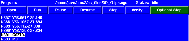

The buttons in the lower part of TkLinuxCNC are used to control the execution of a program: Open to load a program, Verify to check it for errors, Run to start the actual cutting, Pause to stop it while running, Resume to resume an already paused program, Step to advance one line in the program and Optional Stop to toggle the optional stop switch (if the button is green the program execution will be stopped on any M1 encountered).
![TkLinuxCNC Interpreter / program control](images/tkemc-interp.png)
When the program is running, the line currently being executed is highlighted in white. The text display will automatically scroll to show the current line.
