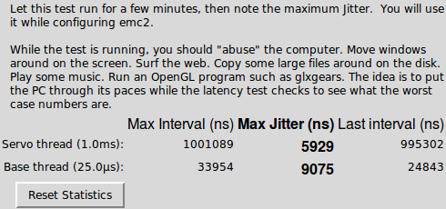

The best way to find out how well your PC will lrun LinuxCNC is to run the HAL latency test. To run the test, open a terminal window (In Ubuntu, from Applications → Accessories → Terminal) and run the following command:
latency-test
You should see something like this:
../config/images/latency.png
Figure 1. HAL Latency Test
While the test is running, you should abuse the computer. Move windows around on the screen. Surf the web. Copy some large files around on the disk. Play some music. Run an OpenGL program such as glxgears. The idea is to put the PC through its paces while the latency test checks to see what the worst case numbers are.
Note
Do not run LinuxCNC or Stepconf while the latency test is running.
The important numbers are the max jitter. In the example above, that is 9075 nanoseconds, or 9.075 microseconds. Record this number, and enter it in Stepconf when it is requested.
In the example above, latency-test only ran for a few seconds. You should run the test for at least several minutes; sometimes the worst case latency doesn’t happen very often, or only happens when you do some particular action. For instance, one Intel motherboard worked pretty well most of the time, but every 64 seconds it had a very bad 300 us latency. Fortunately that was fixable, see http://wiki.linuxcnc.org/cgi-bin/wiki.pl?FixingSMIIssues
So, what do the results mean? If your Max Jitter number is less than about 15-20 microseconds (15000-20000 nanoseconds), the computer should give very nice results with software stepping. If the max latency is more like 30-50 microseconds, you can still get good results, but your maximum step rate might be a little disappointing, especially if you use microstepping or have very fine pitch leadscrews. If the numbers are 100 us or more (100,000 nanoseconds), then the PC is not a good candidate for software stepping. Numbers over 1 millisecond (1,000,000 nanoseconds) mean the PC is not a good candidate for LinuxCNC, regardless of whether you use software stepping or not.

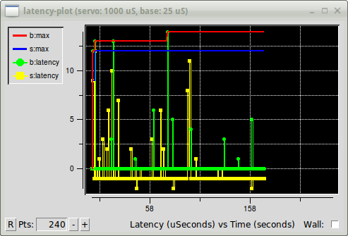

latency-plot makes a strip chart recording for a base and a servo thread. It may be useful to see spikes in latency when other applications are started or used. Usage:
latency-plot --help
Usage:
      latency-plot --help | -?      (this)
      latency-plot --hal [Options]
Options:
      --base nS  (base  thread interval, default:   25000)
      --servo nS (servo thread interval, default: 1000000)
      --time mS  (report interval, default: 1000)
      --relative (relative clock time (default))
      --actual   (actual clock time)

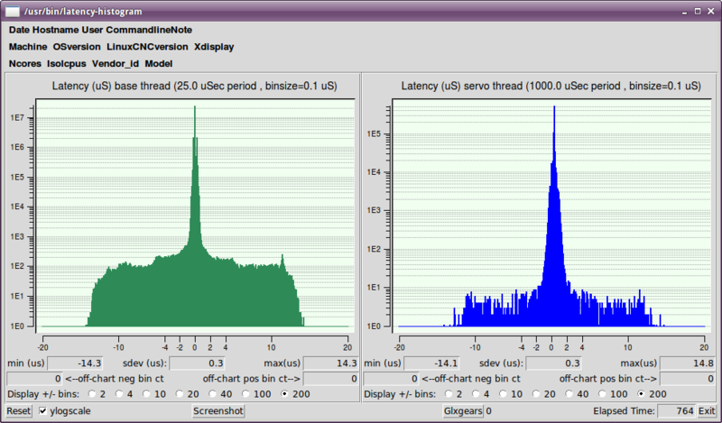

latency-histogram displays a histogram of latency (jitter) for a base and servo thread. Usage:
latency-histogram --help
Usage:
   latency-histogram --help | -?
or
   latency-histogram [Options]
Options:
  --version        (show version and exit)
  --base      nS   (base  thread interval, default:   25000, min:  5000)
  --servo     nS   (servo thread interval, default: 1000000, min: 25000)
  --bbinsize  nS   (base  bin size,  default: 100
  --sbinsize  nS   (servo bin size, default: 100
  --bbins     n    (base  bins, default: 200
  --sbins     n    (servo bins, default: 200
  --logscale  0|1  (y axis log scale, default: 1)
  --text      note (additional note, default: "" )
  --show           (show count of undisplayed bins)
  --nobase         (servo thread only)
  --verbose        (progress and debug)
Notes:
  Linuxcnc and Hal should not be running, stop with halrun -U.
  Large number of bins and/or small binsizes will slow updates.
  For single thread, specify --nobase (and options for servo thread).
  Measured latencies outside of the +/- bin range are reported
  with special end bars.  Use --show to show count for
  the off-chart [pos|neg] bin
../config/images/latency-histogram.png
