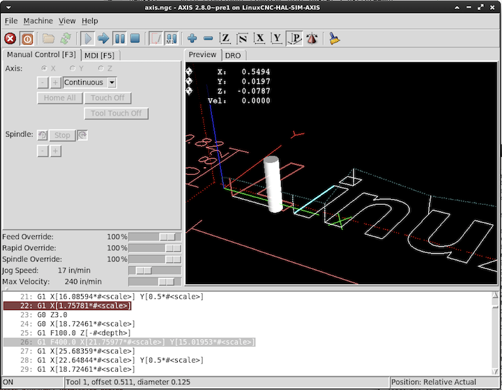

AXIS is a graphical front-end for LinuxCNC which features a live preview and backplot. It is written in Python and uses Tk and OpenGL to display its user interface.
images/axis.png
Figure 1. AXIS Window

3. AXIS Display
The AXIS window contains the following elements:
  • A display area that shows one of the following:
    • a preview of the loaded file (in this case, axis.ngc), as well as the current location of the CNC machine’s controlled point. Later, this area will display the path the CNC machine has moved through, called the backplot
    • a large readout showing the current position and all offsets.
  • A menu bar and toolbar that allow you to perform various actions
  • Manual Control Tab - which allows you to make the machine move, turn the spindle on or off, and turn the coolant on or off if included in the ini file.

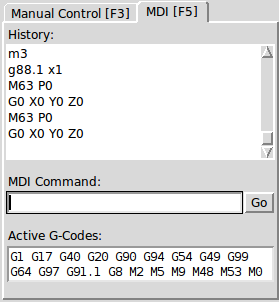

  • MDI Tab - where G-code programs can be entered manually, one line at a time. This also shows the Active G Codes which shows which modal G Codes are in effect.
  • Feed Override - which allows you to scale the speed of programmed motions. The default maximum is 120% and can be set to a different value in the ini file. See the Display Section of the INI file for more information.
  • Spindle Override - which allows you to scale the spindle speed up or down.
  • Jog Speed - which allows you to set the jog speed within the limits set in the ini file. See the Display Section of the INI file for more information.
  • Max Velocity - which allows you to restrict the maximum velocity of all programmed motions (except spindle synchronized motion).
  • A text display area that shows the loaded G-Code.
  • A status bar which shows the state of the machine. In this screen shot, the machine is turned on, does not have a tool inserted, and the displayed position is Relative (showing all offsets), and Actual (showing feedback position).

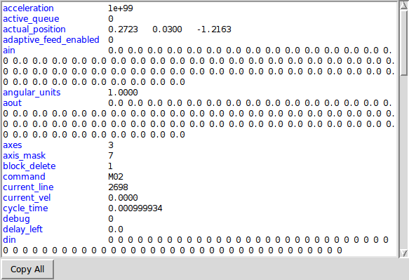

  • Show LinuxCNC Status - Opens a window showing LinuxCNC’s status.

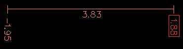

Program Extents
The extents of the program in each axis are shown. At the ends, the least and greatest coordinate values are indicated. In the middle, the difference between the coordinates is shown.
When some coordinates exceed the soft limits in the .ini file, the relevant dimension is shown in a different color and enclosed by a box. In figure below the maximum soft limit is exceeded on the X axis as indicated by the box surrounding the coordinate value. The minimum X travel of the program is -1.95, the maximum X travel is 1.88, and the program requires 3.83 inches of X travel. To move the program so it’s within the machine’s travel in this case, jog to the left and Touch Off X again.

3.6. MDI
MDI allows G-code commands to be entered manually. When the machine is not turned on, or when a program is running, the MDI controls are unavailable.
images/axis-mdi.png
Figure 5. The MDI tab
  • History - This shows MDI commands that have been typed earlier in this session.
  • MDI Command - This allows you to enter a g-code command to be executed. Execute the command by pressing Enter or by clicking Go.
  • Active G-Codes - This shows the modal codes that are active in the interpreter. For instance, G54 indicates that the G54 offset is applied to all coordinates that are entered. When in Auto the Active G-Codes represent the codes after any read ahead by the interpreter.

5. Show LinuxCNC Status (linuxcnctop)
AXIS includes a program called linuxcnctop which shows some of the details of LinuxCNC’s state. You can run this program by invoking Machine > Show LinuxCNC Status
images/axis-emc-status.png
Figure 6. LinuxCNC Status Window
The name of each item is shown in the left column. The current value is shown in the right column. If the value has recently changed, it is shown on a red background.

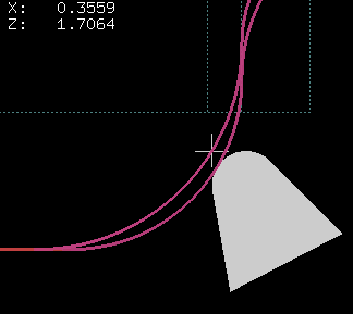

Lathe Tool Shape
images/axis-lathe-tool.png

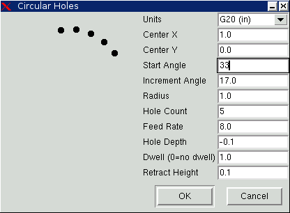

It is also possible to specify an interpreter:
py = python
In this way, any Python script can be opened, and its output is treated as g-code. One such example script is available at nc_files/holecircle.py. This script creates g-code for drilling a series of holes along the circumference of a circle.
images/holes.png
Figure 8. Circular Holes
