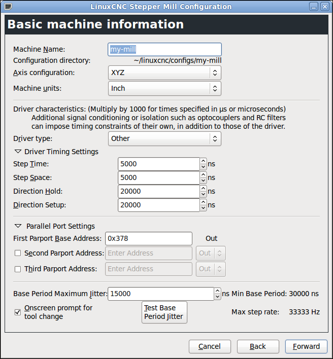

2. Basic Information
images/stepconf-basic.png
Figure 2. Basic Information Page
  • Machine Name - Choose a name for your machine. Use only uppercase letters, lowercase letters, digits, - and _.
  • Axis Configuration - Choose XYZ (Mill), XYZA (4-axis mill) or XZ (Lathe).
  • Machine Units - Choose Inch or mm. All subsequent entries will be in the chosen units
  • Driver Type - If you have one of the stepper drivers listed in the pull down box, choose it. Otherwise, select Other and find the timing values in your driver’s data sheet and enter them as nano seconds in the Driver Timing Settings. If the data sheet gives a value in microseconds, multiply by 1000. For example, enter 4.5us as 4500ns.
A list of some popular drives, along with their timing values, is on the LinuxCNC.org Wiki under Stepper Drive Timing.
Additional signal conditioning or isolation such as optocouplers and RC filters on break out boards can impose timing constraints of their own, in addition to those of the driver. You may find it necessary to add some time to the drive requirements to allow for this.
The LinuxCNC Configuration Selector has configs for Sherline already configured.
  • Step Time - How long the step pulse is on in nano seconds. If your not sure about this setting a value of 10,000 will work with most drives.
  • Step Space - Minimum time between step pulses in nano seconds. If your not sure about this setting a value of 10,000 will work with most drives.
  • Direction Hold - How long the direction pin is held after a change of direction in nanoseconds. If your not sure about this setting a value of 200,000 will work with most drives.
  • Direction Setup - How long before a direction change after the last step pulse in nanoseconds. If your not sure about this setting a value of 200,000 will work with most drives.
  • First Parport - Usually the default of 0x378 is correct.
  • Second Parport - If you need to specify additional parallel ports enter the address and the type. For information on finding the address of PCI parallel ports see the Port Address in the Integrator Manual. (Try 0x278 or 0x3BC first.)
  • Base Period Maximum Jitter - Enter the result of the Latency Test here. To run a latency test press the Test Base Period Jitter button. See the Latency Test section for more details.
  • Max Step Rate -Stepconf automatically calculates the Max Step Rate based on the driver characteristics entered and the latency test result.
  • Min Base Period - Stepconf automatically determines the Min Base Period based on the driver characteristics entered and latency test result.
  • Onscreen Prompt For Tool Change - If this box is checked, LinuxCNC will pause and prompt you to change the tool when M6 is encountered. This feature is usually only useful if you have presettable tools.

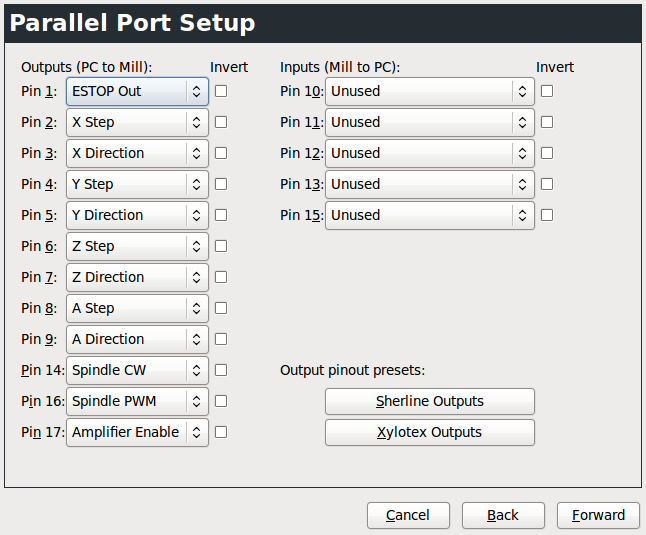

4. Parallel Port Setup
images/stepconf-pinout.png
Figure 4. Parallel Port Setup Page
For each pin, choose the signal which matches your parallel port pinout. Turn on the invert check box if the signal is inverted (0V for true/active, 5V for false/inactive).
  • Output pinout presets - Automatically set pins 2 through 9 according to the Sherline standard (Direction on pins 2, 4, 6, 8) or the Xylotex standard (Direction on pins 3, 5, 7, 9).
  • Inputs and Outputs - If the input or output is not used set the option to Unused.
  • External E Stop - This can be selected from an input pin drop down box. A typical E Stop chain uses all normally closed contacts.
  • Homing & Limit Switches - These can be selected from an input pin drop down box for most configurations.
  • Charge Pump - If your driver board requires a charge pump signal select Charge Pump from the drop down list for the output pin you wish to connect to your charge pump input. The charge pump output is connected to the base thread by Stepconf. The charge pump output will be about 1/2 of the maximum step rate shown on the Basic Machine Configuration page.

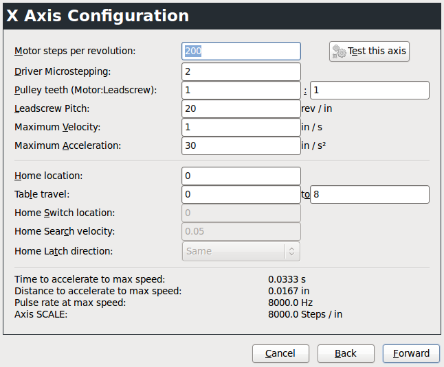

5. Axis Configuration
images/stepconf-axis.png
Figure 5. Axis Configuration Page
  • Motor Steps Per Revolution - The number of full steps per motor revolution. If you know how many degrees per step the motor is (e.g., 1.8 degree), then divide 360 by the degrees per step to find the number of steps per motor revolution.
  • Driver Microstepping - The amount of microstepping performed by the driver. Enter 2 for half-stepping.
  • Pulley Ratio - If your machine has pulleys between the motor and leadscrew, enter the ratio here. If not, enter 1:1.
  • Leadscrew Pitch - Enter the pitch of the leadscrew here. If you chose Inch units, enter the number of threads per inch If you chose mm units, enter the number of millimeters per revolution (e.g., enter 2 for 2mm/rev). If the machine travels in the wrong direction, enter a negative number here instead of a positive number, or invert the direction pin for the axis.
  • Maximum Velocity -Enter the maximum velocity for the axis in units per second.
  • Maximum Acceleration - The correct values for these items can only be determined through experimentation. See Finding Maximum Velocity to set the speed and Finding Maximum Acceleration to set the acceleration.
  • Home Location - The position the machine moves to after completing the homing procedure for this axis. For machines without home switches, this is the location the operator manually moves the machine to before pressing the Home button. If you combine the home and limit switches you must move off of the switch to the home position or you will get a joint limit error.
  • Table Travel - The range of travel for that axis based on the machine origin. The home location must be inside the Table Travel and not equal to one of the Table Travel values.
  • Home Switch Location - The location at which the home switch trips or releases reletive to the machine origin. This item and the two below only appear when Home Switches were chosen in the Parallel Port Pinout. If you combine home and limit switches the home switch location can not be the same as the home position or you will get a joint limit error.
  • Home Search Velocity - The velocity to use when searching for the home switch. If the switch is near the end of travel, this velocity must be chosen so that the axis can decelerate to a stop before hitting the end of travel. If the switch is only closed for a short range of travel (instead of being closed from its trip point to one end of travel), this velocity must be chosen so that the axis can decelerate to a stop before the switch opens again, and homing must always be started from the same side of the switch. If the machine moves the wrong direction at the beginning of the homing procedure, negate the value of Home Search Velocity.
  • Home Latch Direction - Choose Same to have the axis back off the switch, then approach it again at a very low speed. The second time the switch closes, the home position is set. Choose Opposite to have the axis back off the switch and when the switch opens, the home position is set.
  • Time to accelerate to max speed - Time to reach maximum speed calculated from Max Acceleration and Max Velocity.
  • Distance to accelerate to max speed - Distance to reach maximum speed from a standstill.
  • Pulse rate at max speed - Information computed based on the values entered above. The greatest Pulse rate at max speed determines the BASE_PERIOD. Values above 20000Hz may lead to slow response time or even lockups (the fastest usable pulse rate varies from computer to computer)
  • Axis SCALE - The number that will be used in the ini file [SCALE] setting. This is how many steps per user unit.
  • Test this axis - This will open a window to allow testing for each axis. This can be used after filling out all the information for this axis.

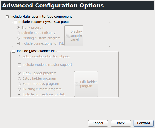

7. Advanced Configuration Options
images/stepconf-advanced.png
Figure 8. Advanced Configuration
  • Include Halui - This will add the Halui user interface component. See the Integrator Manual for more information on Halui.
  • Include pyVCP - This option adds the pyVCP panel base file or a sample file to work on. See the Integrator Manual for more information on pyVCP.
  • Include ClassicLadder PLC - This option will add the ClassicLadder PLC (Programmable Logic Controller). See the Integrator Manual for more information on ClassicLadder.

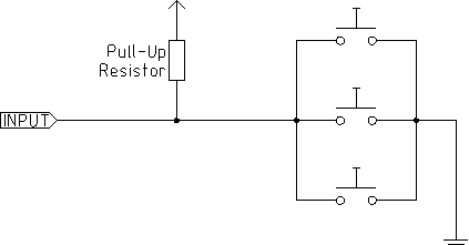

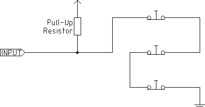

9.3. Home and Limit Switch wiring options
The ideal wiring for external switches would be one input per switch. However, the PC parallel port only offers a total of 5 inputs, while there are as many as 9 switches on a 3-axis machine. Instead, multiple switches are wired together in various ways so that a smaller number of inputs are required.
The figures below show the general idea of wiring multiple switches to a single input pin. In each case, when one switch is actuated, the value seen on INPUT goes from logic HIGH to LOW. However, LinuxCNC expects a TRUE value when a switch is closed, so the corresponding Invert box must be checked on the pinout configuration page. The pull up resistor show in the diagrams pulls the input high until the connection to ground is made and then the input goes low. Otherwise the input might float between on and off when the circuit is open. Typically for a parallel port you might use 47k.
Normally Closed Switches
Wiring N/C switches in series (simplified diagram)

Normally Open Switches
Wiring N/O switches in parallel (simplified diagram)
images/switch-no-parallel.png
