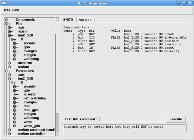

10. HAL Pins
The HAL pins for each configuration can be seen by opening up Show HAL Configuration from the Machine menu. All the HAL pins and parameters can be found there. The following figure is of the 5I20 configuration used above.

15. Encoder
Encoders have names like hm2_<BoardType>.<BoardNum>.encoder.<Instance>.. Instance is a two-digit number that corresponds to the HostMot2 encoder instance number. There are num_encoders instances, starting with 00.
Each encoder uses three or four input I/O pins, depending on how the firmware was compiled. Three-pin encoders use A, B, and Index (sometimes also known as Z). Four-pin encoders use A, B, Index, and Index-mask.
The hm2 encoder representation is similar to the one described by the Canonical Device Interface (in the HAL General Reference document), and to the software encoder component. Each encoder instance has the following pins and parameters:
15.1. Pins
count- (s32, Out) Number of encoder counts since the previous reset. -
index-enable- (Bit, I/O) When this pin is set to True, the count (and therefore also position) are reset to zero on the next Index (Phase-Z) pulse. At the same time, index-enable is reset to zero to indicate that the pulse has occurred. -
position- (Float, Out) Encoder position in position units (count / scale). -
rawcounts- (s32, Out) Total number of encoder counts since the start, not adjusted for index or reset. -
reset- (Bit, In) When this pin is TRUE, the count and position pins are set to 0. The value of the velocity pin is not affected by this. The driver does not reset this pin to FALSE after resetting the count to 0, that is the user’s job. -
velocity- (Float, Out) Estimated encoder velocity in position units per second.
