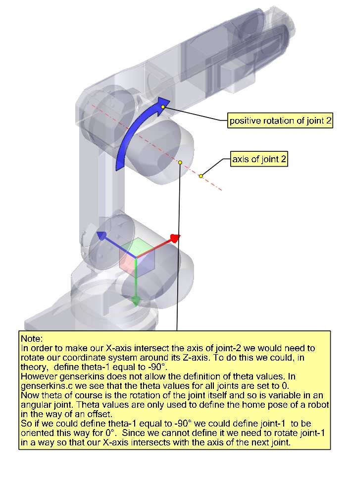

Note that genserkins does not handle offsets to theta-values — theta is the joint variable that is controlled by LinuxCNC. With the CS aligned with the joint, a rotation around its Z-Axis is identical to the rotation commanded to that joint by LinuxCNC. This makes it impossible to define the 0° position of our robots joints arbitrarily.

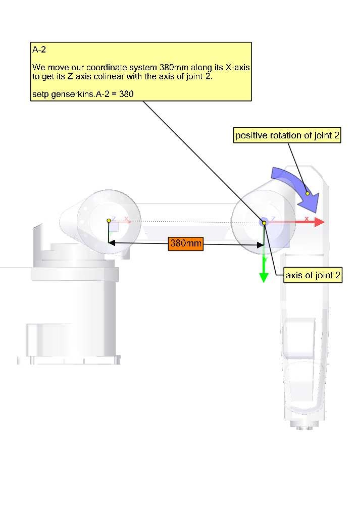

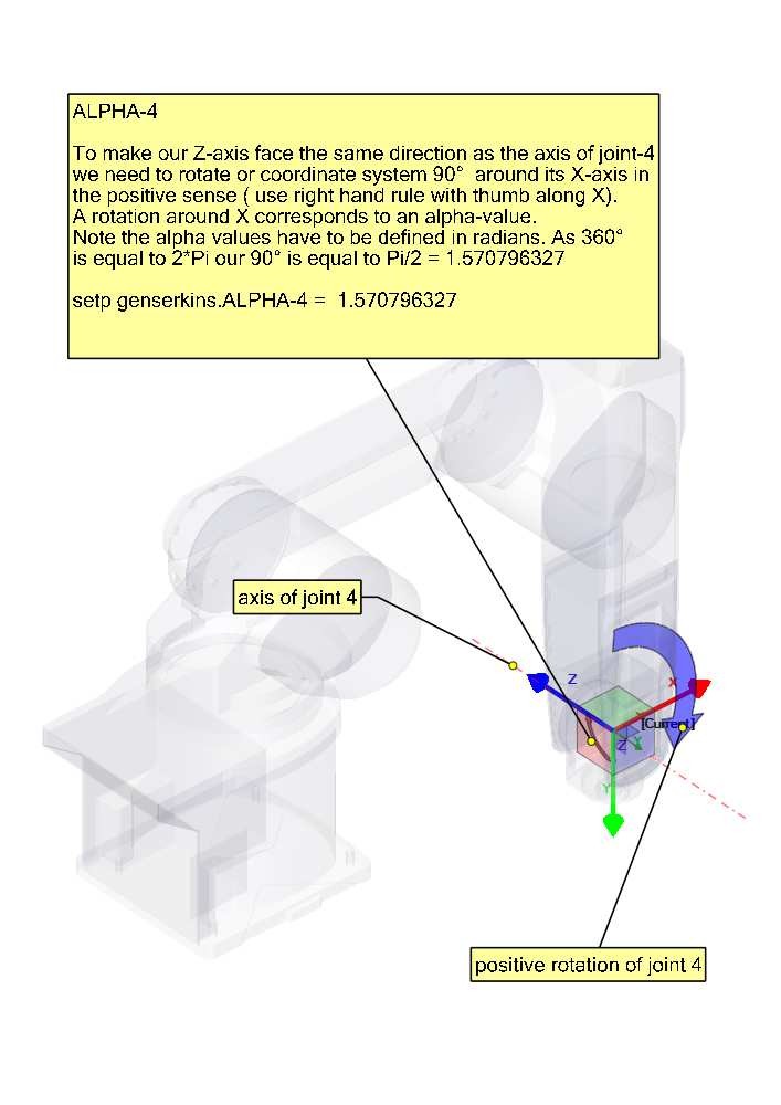

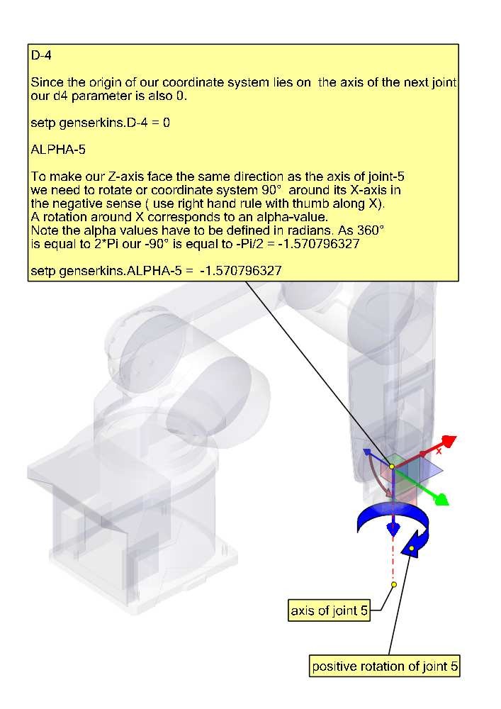

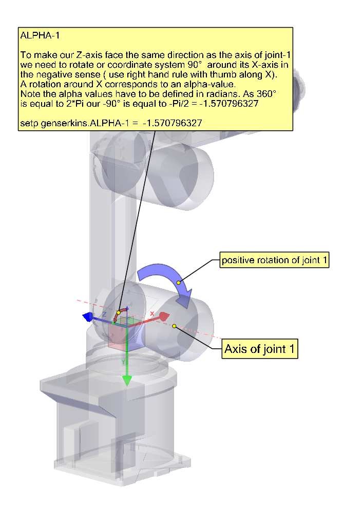

alpha : positive or negative rotation (in radians) around the X-axis of the "current coordinate system"

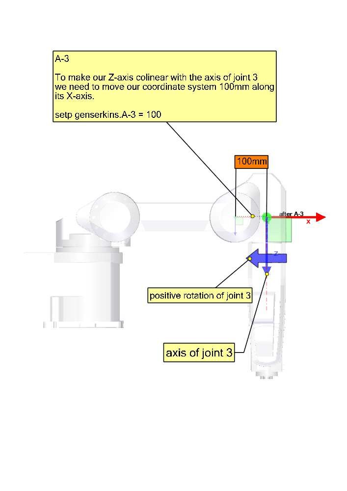

a : positive distance, along X, between two joint axes specified in machine units (mm or inch) defined in the system’s INI file.
d : positive or negative length along Z (also in machine units)

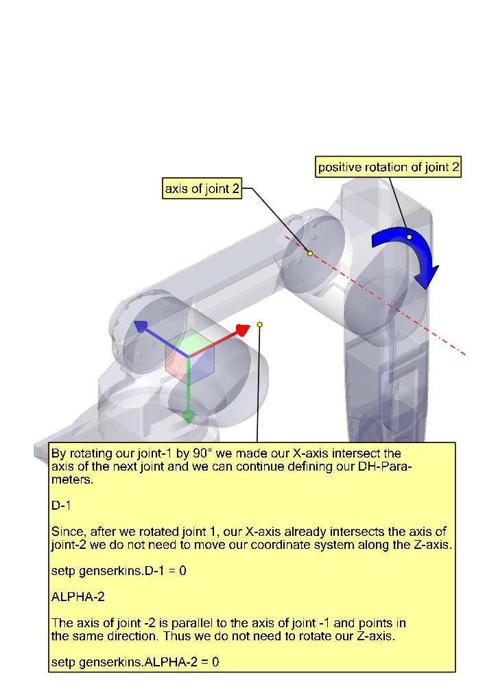

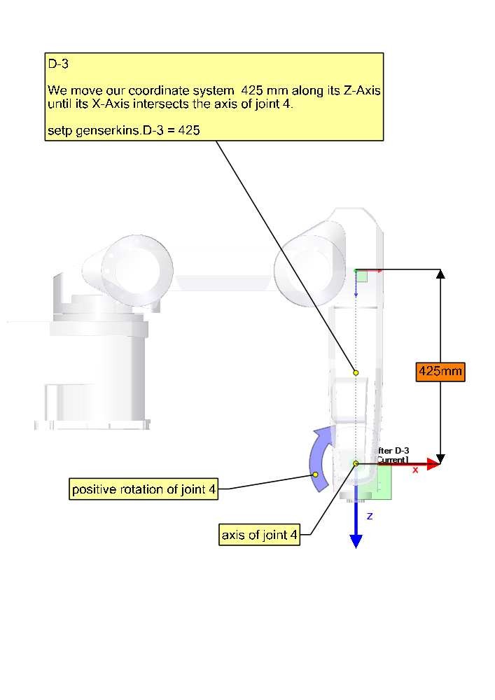

The parameter sets are always derived in the same order and a set is completed by setting the d-parameter. This does not leave the Z-axis of our CS aligned with the next joint! This may seem confusing but sticking to this rule will yield a working set of parameters. Once the d-parameter is set, the X-axis of our-CS needs to point to the axis of the next joint.

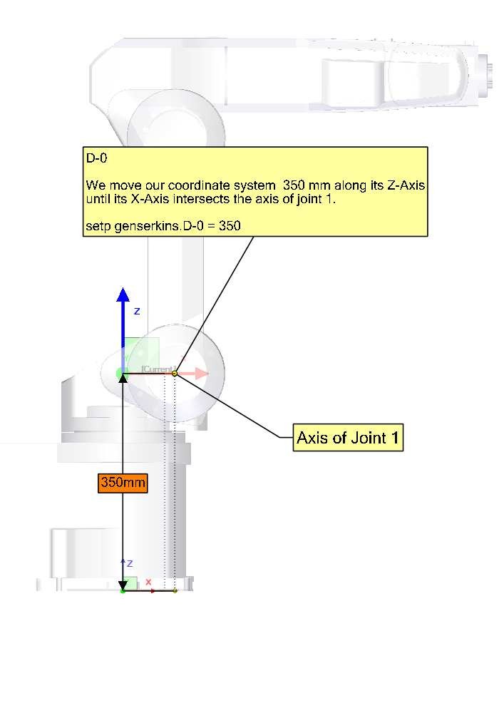

Convention is to start by placing the reference-CS in the base of the robot with it’s Z-axis coinciding with the axis of the first joint and its X-axis pointing toward the next joint’s axis.

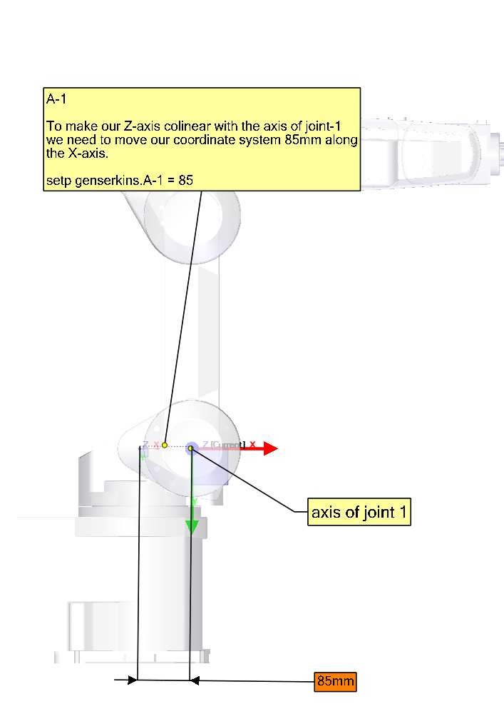

This will also result in the DRO values in LinuxCNC being referenced to that point. Having done so sets a-0 and alpha-0 to 0. The above mentioned publication (Craig) also sets d-0 to 0, which is confusing when a displacement offset is needed in order to have the reference-CS at the bottom of the base. Setting d-0 = to the displacement gives correct results. In this manner, the first set of parameters are alpha-0 = 0, a-0 = 0, d0 = displacement, and the X-axis of the CS points to the axis of the next joint (joint-1).

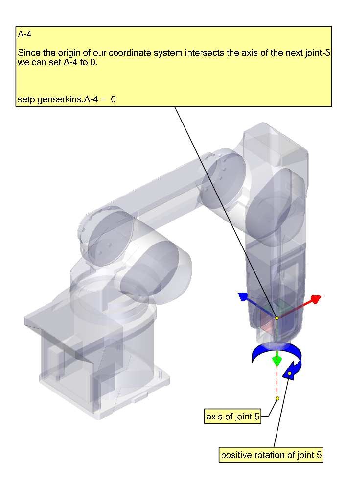

Derivation of the net set (alpha-1, a-1, d-1) follows — always using the same sequence all the way to the sixth set (alpha-5, a-5, d-5).
And thus, the TCP-CS of the end-effector is sitting in the center of the hand flange.

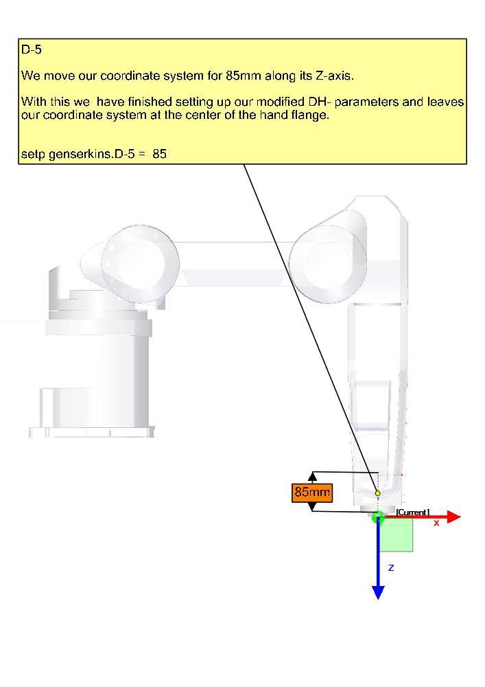

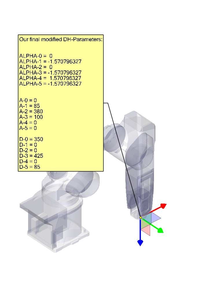

8. Detailed Example (RV-6SL)

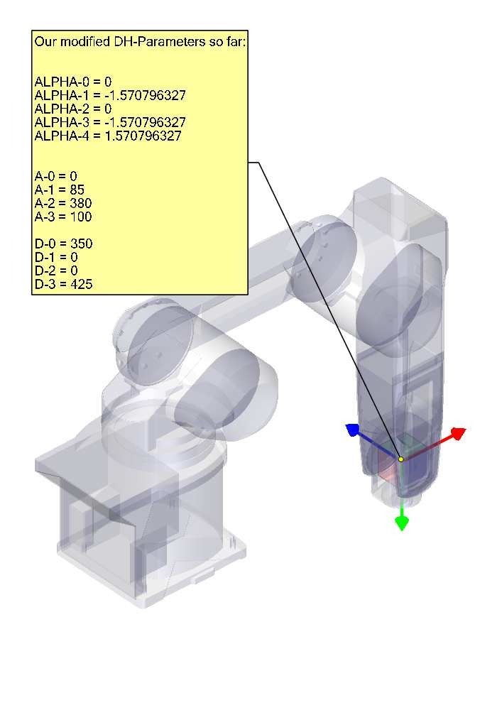

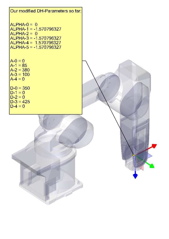

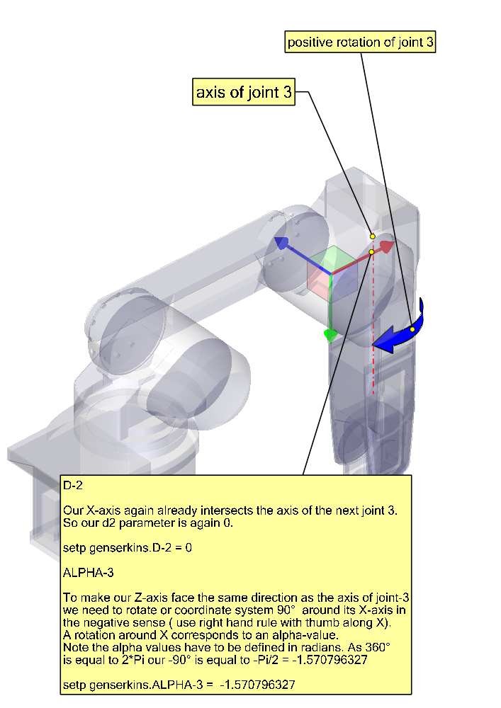

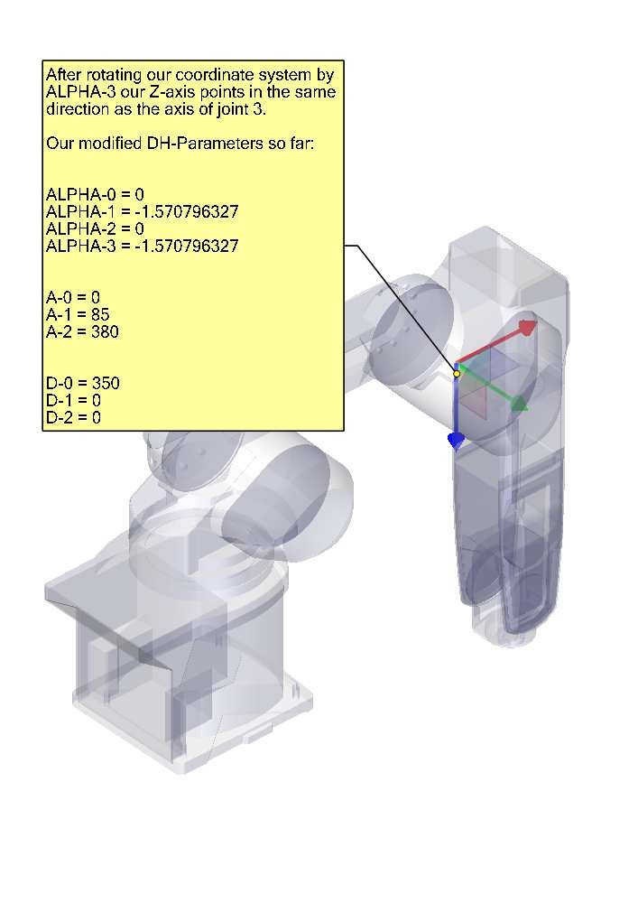

Described below is a method to derive the required "modified DH-parameters" for a Mitsubishi RV-6SDL and how to set the parameters in the HAL file to be used with the genserkins kinematics in LinuxCNC. The necessary dimensions are best taken from a dimensional drawing provided by the manufacturer of the robot.
![rv-6sl/rv-6sl-001.jpg](rv-6sl/rv-6sl-001.jpg)
![rv-6sl/rv-6sl-002.jpg](rv-6sl/rv-6sl-002.jpg)
![rv-6sl/rv-6sl-003.jpg](rv-6sl/rv-6sl-003.jpg)
![rv-6sl/rv-6sl-004.jpg](rv-6sl/rv-6sl-004.jpg)
![rv-6sl/rv-6sl-005.jpg](rv-6sl/rv-6sl-005.jpg)
![rv-6sl/rv-6sl-006.jpg](rv-6sl/rv-6sl-006.jpg)
![rv-6sl/rv-6sl-007.jpg](rv-6sl/rv-6sl-007.jpg)
![rv-6sl/rv-6sl-008.jpg](rv-6sl/rv-6sl-008.jpg)
![rv-6sl/rv-6sl-009.jpg](rv-6sl/rv-6sl-009.jpg)
![rv-6sl/rv-6sl-010.jpg](rv-6sl/rv-6sl-010.jpg)
![rv-6sl/rv-6sl-011.jpg](rv-6sl/rv-6sl-011.jpg)
![rv-6sl/rv-6sl-012.jpg](rv-6sl/rv-6sl-012.jpg)
![rv-6sl/rv-6sl-013.jpg](rv-6sl/rv-6sl-013.jpg)
![rv-6sl/rv-6sl-014.jpg](rv-6sl/rv-6sl-014.jpg)
![rv-6sl/rv-6sl-015.jpg](rv-6sl/rv-6sl-015.jpg)
![rv-6sl/rv-6sl-016.jpg](rv-6sl/rv-6sl-016.jpg)
![rv-6sl/rv-6sl-017.jpg](rv-6sl/rv-6sl-017.jpg)
![rv-6sl/rv-6sl-018.jpg](rv-6sl/rv-6sl-018.jpg)
