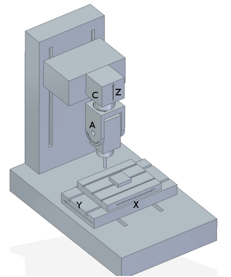

3-axis machine tools cannot change the tool orientation, so 5-axis machine tools use two extra axes to set the cutting tool in an appropriate orientation for efficient machining of freeform surfaces.
Typical 5-axis machine tool configurations are shown in Figs. 3, 5, 7 and 9-11 [1,2] in section Figures.

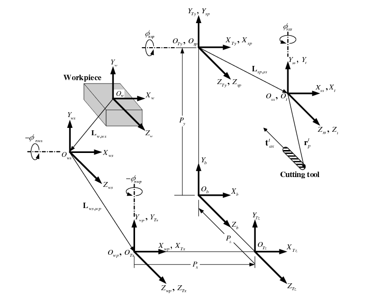

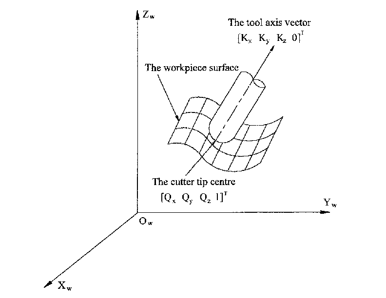

3. Tool Orientation and Location
CAD/CAM systems are typically used to generate the 3D CAD models of the workpiece as well as the CAM data for input to the CNC 5-axis machine. The tool or cutter location (CL) data, is composed of the cutter tip position and the cutter orientation relative to the workpiece coordinate system. Two vectors, as generated by most CAM systems and shown in Fig. 1, contain this information:
5-axis-figures/equation__1.png
The K vector is equivalent to the 3rd vector from the pose matrix E6 that was used in the 6-axis robot kinematics [3] and the Q vector is equivalent to the 4th vector of E6. In MASTERCAM for example this information is contained in the intermediate output ".nci" file.
5-axis-figures/Figure-1.png
Figure 1. Cutter location data

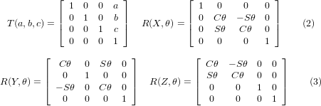

4. Translation and Rotation Matrices
Homogeneous transformations provide a simple way to describe the mathematics of multi-axis machine kinematics. A transformation of the space H is a 4x4 matrix and can represent translation and rotation transformations. Given a point x,y,x described by a vector u = {x,y,z,1}T, then its transformation v is represented by the matrix product
5-axis-figures/equation__2.png
There are four fundamental transformation matrices on which 5-axis kinematics can be based:
5-axis-figures/equation__3.png
The matrix T(a,b,c) implies a translation in the X, Y, Z coordinate directions by the amounts a, b, c respectively. The R matrices imply rotations of the angle theta about the X, Y and Z coordinate axes respectively. The C and S symbols refer to cosine and sine functions respectively.

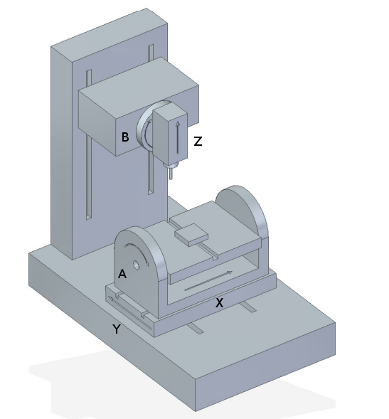

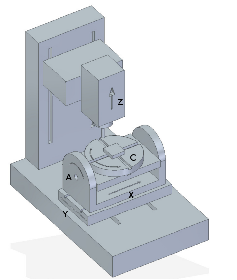

5. Table Rotary/Tilting 5-Axis Configurations
In these machine tools the two rotational axes mount on the work table of the machine. Two forms are typically used:
  • A rotary table which rotates about the vertical Z-axes (C-rotation, secondary) mounted on a tilting table which rotates about the X- or Y-axis (A- or B-rotation, primary). The workpiece is mounted on the rotary table.
  • A tilting table which rotates about the X- or Y-axis (A- or B-rotation, secondary) is mounted on a rotary table which rotates about the Z-axis (C-rotation, primary), with the workpiece on the tilting table.
5-axis-figures/Figure-2.png
Figure 2. General configuration and coordinate systems

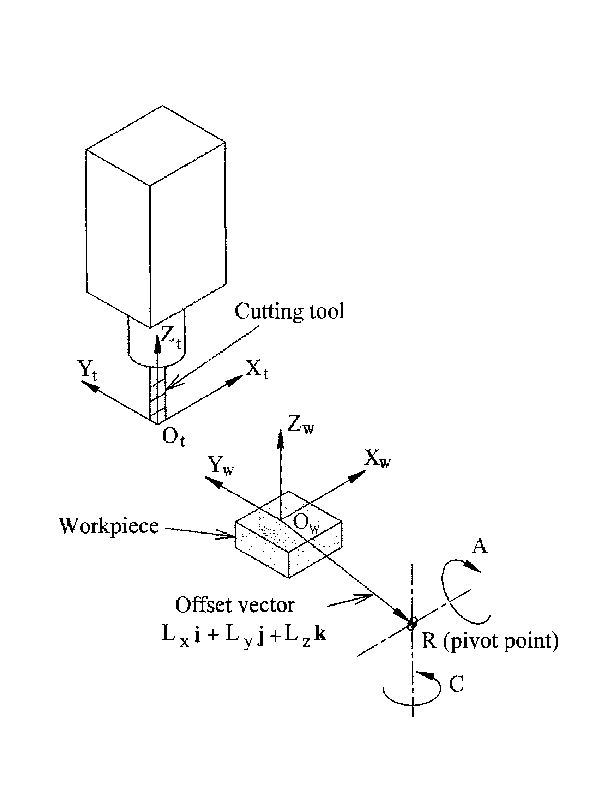

5.1. Transformations for a xyzac-trt machine tool with work offsets
5-axis-figures/Figure-3.png
Figure 3. vismach model of xyzac-trt with coincident rotation axes
We deal here with a simplified configuration in which the tilting axis and rotary axis intersects at a point called the pivot point as shown in Fig. 4. therefore the two coordinate systems Ows and Owp of Fig. 2 are coincident.
5-axis-figures/Figure-4.png
Figure 4. Table tilting/rotary configuration

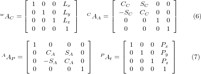

5.1.1. Forward transformation
The transformation can be defined by the sequential multiplication of the matrices:
5-axis-figures/equation__6.png
with the matrices built up as follows:
5-axis-figures/equation__7.png
In these equations Lx, Ly, Lz defines the offsets of the pivot point of the two rotary axes A and C relative to the workpiece coordinate system origin. Furthermore, Px, Py, Pz are the relative distances of the pivot point to the cutter tip position, which can also be called the "joint coordinates" of the pivot point. The pivot point is at the intersection of the two rotary axes. The signs of the SA and SC terms are different to those in [2,3] since there the table rotations are negative relative to the workpiece coordinate axes (note that sin(-theta) = -sin(theta), cos(-theta) = cos(theta)).
When multiplied in accordance with (5), we obtain:
5-axis-figures/equation__8.png

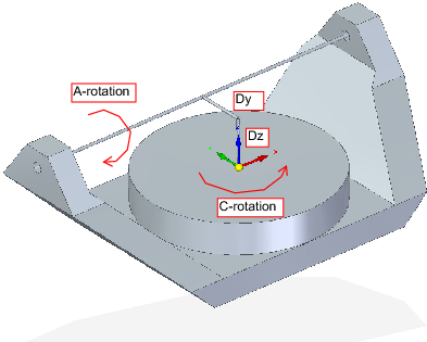

5.2. Transformations for a xyzac-trt machine with rotary axis offsets
5-axis-figures/Figure-5.png
Figure 5. vismach model of xyzac-trt with rotational axis offsets (positive)
We deal here with a extended configuration in which the tilting axis and rotary axis do not intersect at a point but have an offset Dy. Furthermore, there is also an z-offset between the two coordinate systems Ows and Owp of Fig. 2, called Dz. A vismach model is shown in Fig. 5 and the offsets are shown in Fig. 6 (positive offsets in this example). To simplify the configuration, the offsets Lx, Ly, Lz of the previous case are not included. They are probably not necessary if one uses the G54 offsets in LinuxCNC by means of the "touch of" facility.
5-axis-figures/Figure-6.png
Figure 6. Table tilting/rotary xyzac-trt configuration, with axis offsets

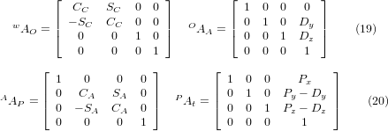

5.2.1. Forward Transformation
5-axis-figures/equation__18.png
5-axis-figures/equation__19.png
In these equations Dy, Dz defines the offsets of the pivot point of the rotary axes A relative to the workpiece coordinate system origin. Furthermore, Px, Py, Pz are the relative distances of the pivot point to the cutter tip position, which can also be called the "joint coordinates" of the pivot point. The pivot point is on the A rotary axis.
When multiplied in accordance with (18), we obtain:

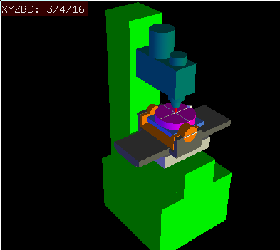

5.3. Transformations for a xyzbc-trt machine with rotary axis offsets
5-axis-figures/Figure-7.png
Figure 7. vismach model of xyzbc-trt with rotational axis offsets (negative)

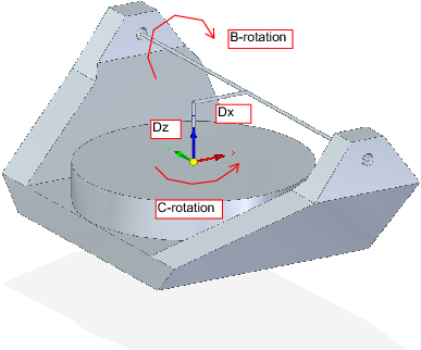

We deal here again with a extended configuration in which the tilting axis (about the y-axis) and rotary axis do not intersect at a point but have an offset Dx. Furthermore, there is also an z-offset between the two coordinate systems Ows and Owp of Fig. 2, called Dz. A vismach model is shown in Fig. 7 (negative offsets in this example) and the positive offsets are shown in Fig. 8.
5-axis-figures/Figure-8.png
Figure 8. Table tilting/rotary xyzbc-trt configuration, with axis offsets

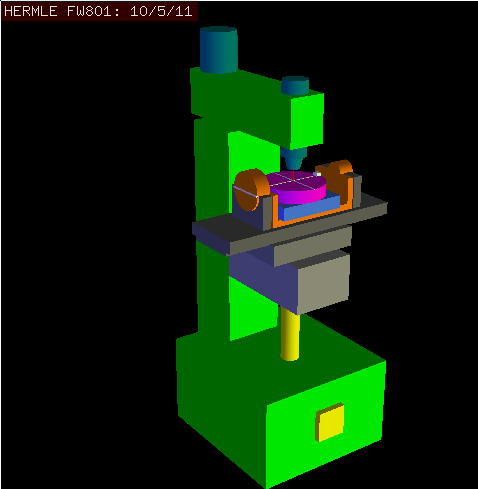

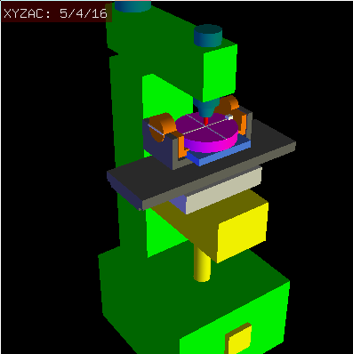

6.1. Vismach Simulation Models
Vismach is a library of python routines to display a dynamic simulation of a CNC machine on the PC screen. The python script for a particular machine is loaded in HAL and data passed by HAL pin connections. The non-realtime vismach model is loaded by a HAL command like:
loadusr -W xyzac-trt-gui
and connections are made using HAL commands like:
net  :table-x   joint.0.pos-fb xyzac-trt-gui.table-x
net  :saddle-y  joint.1.pos-fb xyzac-trt-gui.saddle-y
See the simulation INI files for details of the HAL connections used for the vismach model.

Table tilting/rotating configuration
Figure 9. Table tilting/rotating configuration
Spindle/table tilting configuration
Figure 10. Spindle/table tilting configuration
Spindle tilting/rotary configuration
Figure 11. Spindle tilting/rotary configuration
