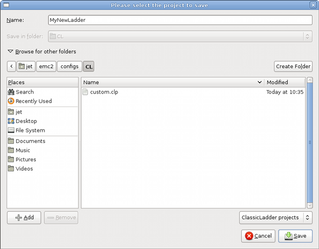

3.1. Files
Typically classic ladder components are placed in the custom.hal file if your working from a Stepconf generated configuration. These must not be placed in the custom_postgui.hal file or the Ladder Editor menu will be grayed out.
Note
Ladder files (.clp) must not contain any blank spaces in the name. |

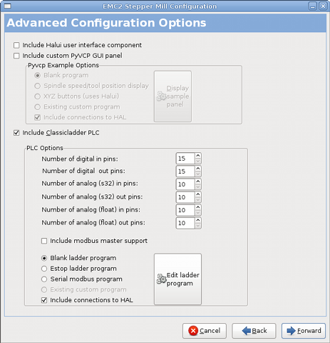

It is possible to configure the number of each type of ladder object while loading the Classic Ladder real time module. If you do not configure the number of ladder objects Classic Ladder will use the default values.
Object Name | Variable Name | Default Value |
Number of rungs |
(numRungs) |
100 |
Number of bits |
(numBits) |
20 |
Number of word variables |
(numWords) |
20 |
Number of timers |
(numTimers) |
10 |
Number of timers IEC |
(numTimersIec) |
10 |
Number of monostables |
(numMonostables) |
10 |
Number of counters |
(numCounters) |
10 |
Number of HAL inputs bit pins |
(numPhysInputs) |
15 |
Number of HAL output bit pins |
(numPhysOutputs) |
15 |
Number of arithmetic expressions |
(numArithmExpr) |
50 |
Number of Sections |
(numSections) |
10 |
Number of Symbols |
(numSymbols) |
Auto |
Number of S32 inputs |
(numS32in) |
10 |
Number of S32 outputs |
(numS32out) |
10 |
Number of Float inputs |
(numFloatIn) |
10 |
Number of Float outputs |
(numFloatOut) |
10 |
Objects of most interest are numPhysInputs, numPhysOutputs, numS32in, and numS32out.
Changing these numbers will change the number of HAL bit pins available. numPhysInputs and numPhysOutputs control how many HAL bit (on/off) pins are available. numS32in and numS32out control how many HAL signed integers (+- integer range) pins are available.
For example (you don’t need all of these to change just a few):
loadrt classicladder_rt numRungs=12 numBits=100 numWords=10 numTimers=10 numMonostables=10 numCounters=10 numPhysInputs=10 numPhysOutputs=10 numArithmExpr=100 numSections=4 numSymbols=200 numS32in=5 numS32out=5

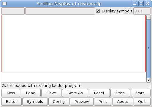

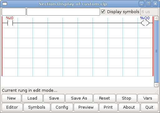

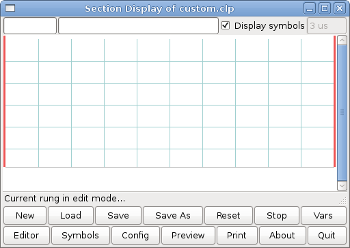

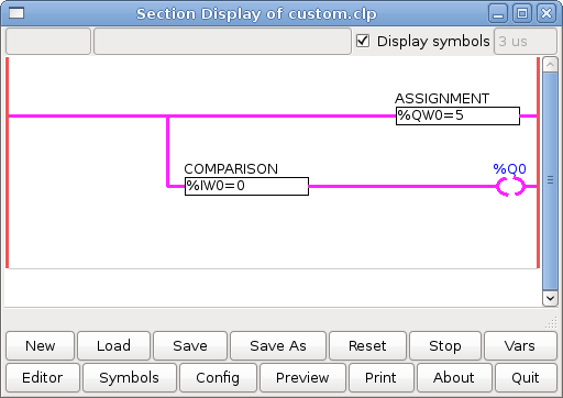

5.2. Section Display
When you first start up Classic Ladder you get an empty Section Display window. Displayed is one empty rung.
Most of the buttons are self explanatory:
The Vars button is for looking at variables, toggle it to display one, the other, both, then none of the windows.
The Config button is used for modbus and shows the max number of ladder elements that was loaded with the real time module.
The Symbols button will display an editable list of symbols for the variables (hint you can name the inputs, outputs, coils etc).
The Quit button will shut down the user program meaning Modbus and the display. The real time ladder program will still run in the background.
The check box at the top right allows you to select whether variable names or symbol names are displayed
You might notice that there is a line under the ladder program display that reads "Project failed to load…" That is the status bar that gives you info about elements of the ladder program that you click on in the display window. This status line will now display HAL signal names for variables %I, %Q and the first %W (in an equation) You might see some funny labels, such as (103) in the rungs. This is displayed (on purpose) because of an old bug- when erasing elements older versions sometimes didn’t erase the object with the right code. You might have noticed that the long horizontal connection button sometimes didn’t work in the older versions. This was because it looked for the free code but found something else. The number in the brackets is the unrecognized code. The ladder program will still work properly, to fix it erase the codes with the editor and save the program.

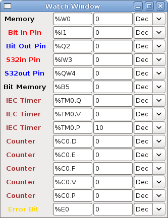

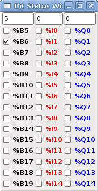

5.3. The Variable Windows
This are two variable windows: the Bit Status Window (boolean) and the Watch Window (signed integer). The Vars button is in the Section Display Window, toggle the Vars button to display one, the other, both, then none of the variable windows.
The Bit Status Window displays some of the boolean (on/off) variable data. Notice all variables start with the % sign. The %I variables represent HAL input bit pins. The %Q represents the relay coil and HAL output bit pins. The %B represents an internal relay coil or internal contact. The three edit areas at the top allow you to select what 15 variables will be displayed in each column. For instance, if the %B Variable column were 15 entries high, and you entered 5 at the top of the column, variables %B5 to %B19 would be displayed. The check boxes allow you to set and unset %B variables manually as long as the ladder program isn’t setting them as outputs. Any Bits that are set as outputs by the program when Classic Ladder is running can not be changed and will be displayed as checked if on and unchecked if off.
The Watch Window displays variable status. The edit box beside it is the number stored in the variable and the drop-down box beside that allow you to choose whether the number to be displayed in hex, decimal or binary. If there are symbol names defined in the symbols window for the word variables showing and the display symbols checkbox is checked in the section display window, symbol names will be displayed. To change the variable displayed, type the variable number, e.g. %W2 (if the display symbols check box is not checked) or type the symbol name (if the display symbols checkbox is checked) over an existing variable number/name and press the Enter Key.

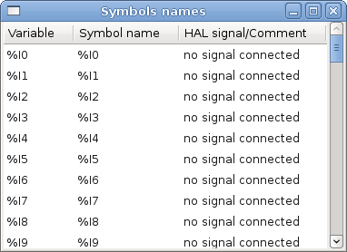

5.4. Symbol Window
This is a list of symbol names to use instead of variable names to be displayed in the section window when the display symbols check box is checked. You add the variable name (remember the % symbol and capital letters), symbol name . If the variable can have a HAL signal connected to it (%I, %Q, and %W-if you have loaded s32 pin with the real time module) then the comment section will show the current HAL signal name or lack thereof. Symbol names should be kept short to display better. Keep in mind that you can display the longer HAL signal names of %I, %Q and %W variable by clicking on them in the section window. Between the two, one should be able to keep track of what the ladder program is connected to!

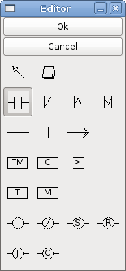

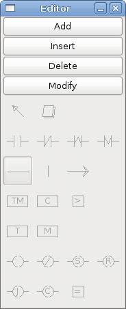

5.5. The Editor window
Add - adds a rung after the selected rung
Insert - inserts a rung before the selected rung
Delete - deletes the selected rung
Modify - opens the selected rung for editing
Starting from the top left image:
Object Selector, Eraser
N.O. Input, N.C. Input, Rising Edge Input , Falling Edge Input
Horizontal Connection, Vertical Connection , Long Horizontal Connection
Timer IEC Block, Counter Block, Compare Variable
Old Timer Block, Old Monostable Block (These have been replaced by the IEC Timer)
COILS - N.O. Output, N.C. Output, Set Output, Reset Output
Jump Coil, Call Coil, Variable Assignment
A short description of each of the buttons:
Selector - allows you to select existing objects and modify the information.
Eraser - erases an object.
N.O. Contact - creates a normally open contact. It can be an external HAL-pin (%I) input contact, an internal-bit coil (%B) contact or a external coil (%Q) contact. The HAL-pin input contact is closed when the HAL-pin is true. The coil contacts are closed when the corresponding coil is active (%Q2 contact closes when %Q2 coil is active).
N.C. Contact - creates a normally closed contact. It is the same as the N.O. contact except that the contact is open when the HAL-pin is true or the coil is active.
'Rising Edge Contact - creates a contact that is closed when the HAL-pin goes from False to true, or the coil from not-active to active.
Falling Edge Contact - creates a contact that is closed when the HAL-pin goes from true to false or the coil from active to not.
Horizontal Connection - creates a horizontal connection to objects.
Vertical Connection - creates a vertical connection to horizontal lines.
Horizontal Running Connection - creates a horizontal connection between two objects and is a quick way to connect objects that are more than one block apart.
IEC Timer - creates a timer and replaces the Timer.
Timer - creates a Timer Module (depreciated use IEC Timer instead).
Monostable - creates a one-shot monostable module
Counter - creates a counter module.
Compare - creates a compare block to compare variable to values or other variables. (eg %W1<=5 or %W1=%W2) Compare cannot be placed in the right most side of the section display.
Variable Assignment - creates an assignment block so you to assign values to variables. (eg %W2=7 or %W1=%W2) ASSIGNMENT functions can only be placed at the right most side of the section display.

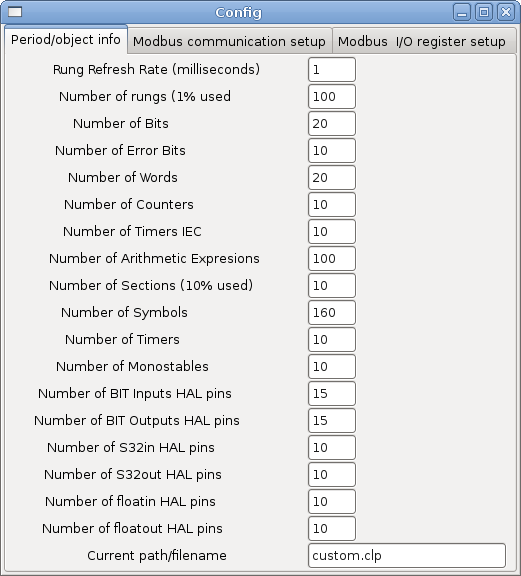

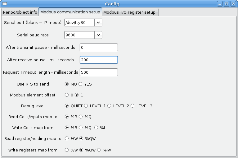

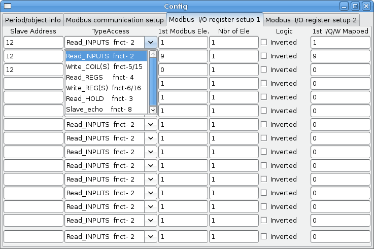

5.6. Config Window
The config window shows the current project status and has the Modbus setup tabs.

The following figure shows an Assignment and a Comparison Example. %QW0 is a S32out bit and %IW0 is a S32in bit. In this case the HAL pin classicladder.0.s32out-00 will be set to a value of 5 and when the HAL pin classicladder.0.s32in-00 is 0 the HAL pin classicladder.0.out-00 will be set to True.

7. Classic Ladder Variables
These Variables are used in COMPARE or OPERATE to get information about, or change specs of, ladder objects such as changing a counter preset, or seeing if a timer is done running.
List of variables :
%Bxxx - Bit memory xxx (Boolean)
%Wxxx - Word memory xxx (32 bits signed integer)
%IWxxx - Word memory xxx (S32 in pin)
%QWxxx - Word memory xxx (S32 out pin)
%IFxx - Word memory xx (Float in pin) (converted to S32 in Classic Ladder)
%QFxx - Word memory xx (Float out pin) (converted to S32 in Classic Ladder)
%Txx.R - Timer xx running (Boolean, user read only)
%Txx.D - Timer xx done (Boolean, user read only)
%Txx.V - Timer xx current value (integer, user read only)
%Txx.P - Timer xx preset (integer)
%TMxxx.Q - Timer xxx done (Boolean, read write)
%TMxxx.P - Timer xxx preset (integer, read write)
%TMxxx.V - Timer xxx value (integer, read write)
%Mxx.R - Monostable xx running (Boolean)
%Mxx.V - Monostable xx current value (integer, user read only)
%Mxx.P - Monostable xx preset (integer)
%Cxx.D - Counter xx done (Boolean, user read only)
%Cxx.E - Counter xx empty overflow (Boolean, user read only)
%Cxx.F - Counter xx full overflow (Boolean, user read only)
%Cxx.V - Counter xx current value (integer)
%Cxx.P - Counter xx preset (integer)
%Ixxx - Physical input xxx (Boolean) (HAL input bit)
%Qxxx - Physical output xxx (Boolean) (HAL output bit)
%Xxxx - Activity of step xxx (sequential language)
%Xxxx.V - Time of activity in seconds of step xxx (sequential language)
%Exx - Errors (Boolean, read write(will be overwritten))
Indexed or vectored variables - These are variables indexed by another variable. Some might call this vectored variables. Example: %W0[%W4] => if %W4 equals 23 it corresponds to %W23

1st%I%Q IQ WQ MAPPED - This is the starting number of %B, %I, %Q, %W, %IW, or %QW variables that are mapped onto/from the modbus element group (starting at the first modbus element number).
In the example above: Port number - for my computer /dev/ttyS0 was my serial port.
The serial speed is set to 9600 baud.
Slave address is set to 12 (on my VFD I can set this from 1-31, meaning I can talk to 31 VFDs maximum on one system).
The first line is set up for 8 input bits starting at the first register number (register 1). So register numbers 1-8 are mapped onto Classic Ladder’s %B variables starting at %B1 and ending at %B8.
The second line is set for 2 output bits starting at the ninth register number (register 9) so register numbers 9-10 are mapped onto Classic Ladder’s %Q variables starting at %Q9 ending at %Q10.
The third line is set to write 2 registers (16 bits each) starting at the 0th register number (register 0) so register numbers 0-1 are mapped onto Classic Ladder’s %W variables starting at %W0 ending at %W1.
It’s easy to make an off-by-one error as sometimes the modbus elements are referenced starting at one rather then 0 (actually by the standard that is the way it’s supposed to be!) You can use the modbus element offset radio button to help with this.
The documents for your modbus slave device will tell you how the registers are set up- there is no standard way.
The SERIAL PORT, PORT SPEED, PAUSE, and DEBUG level are editable for changes (when you close the config window values are applied, though Radio buttons apply immediately).
To use the echo function select the echo function and add the slave number you wish to test. You don’t need to specify any variables.
The number 257 will be sent to the slave number you specified and the slave should send it back. you will need to have Classic Ladder running in a terminal to see the message.

In this section we will cover the steps needed to add Classic Ladder to a Stepconf Wizard generated config. On the advanced Configuration Options page of Stepconf Wizard check off "Include Classic Ladder PLC".
10.1. Add the Modules
If you used the Stepconf Wizard to add Classic Ladder you can skip this step.
To manually add Classic Ladder you must first add the modules. This is done by adding a couple of lines to the custom.hal file.

Now start up your config and select "File/Ladder Editor" to open up the Classic Ladder GUI. You should see a blank Section Display and Sections Manager window as shown above. In the Section Display window open the Editor. In the Editor window select Modify. Now a Properties window pops up and the Section Display shows a grid. The grid is one rung of ladder. The rung can contain branches. A simple rung has one input, a connector line and one output. A rung can have up to six horizontal branches. While it is possible to have more than one circuit in a run the results are not predictable.
Now click on the N.O. Input in the Editor Window.
Now click in the upper left grid to place the N.O. Input into the ladder.
Repeat the above steps to add a N.O. Output to the upper right grid and use the Horizontal Connection to connect the two. It should look like the following. If not, use the Eraser to remove unwanted sections.
Now click on the OK button in the Editor window. Now your Section Display should look like this.
To save the new file select Save As and give it a name. The .clp extension will be added automatically. It should default to the running config directory as the place to save it.
Again if you used the Stepconf Wizard to add Classic Ladder you can skip this step.
