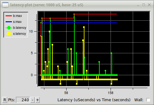

Additional command line tools are availalbe for examining latency when LinuxCNC is not running.
latency-plot makes a strip chart recording for a base and a servo thread. It may be useful to see spikes in latency when other applications are started or used. Usage:
latency-plot --help
Usage:
      latency-plot --help | -?      (this)
      latency-plot --hal [Options]
Options:
      --base nS  (base  thread interval, default:   25000)
      --servo nS (servo thread interval, default: 1000000)
      --time mS  (report interval, default: 1000)
      --relative (relative clock time (default))
      --actual   (actual clock time)

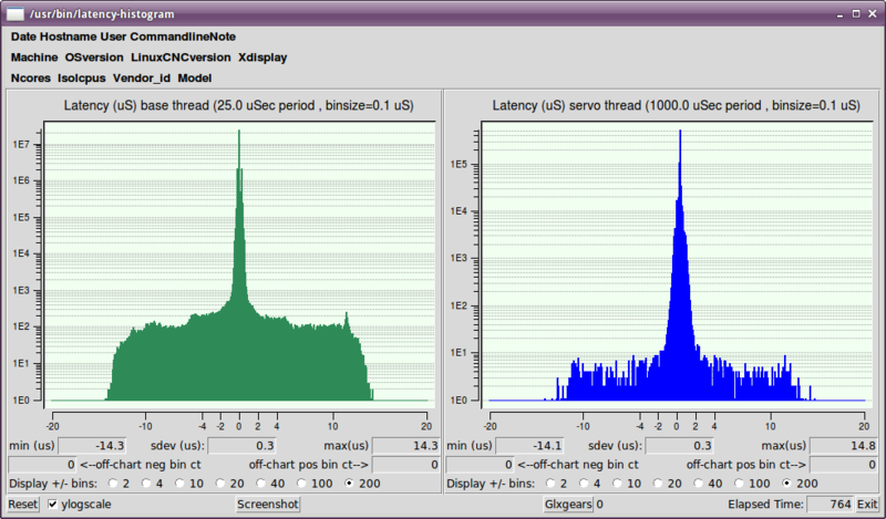

../config/images/latency-plot.png
latency-histogram displays a histogram of latency (jitter) for a base and servo thread. Usage:
latency-histogram --help
Usage:
   latency-histogram --help | -?
or
   latency-histogram [Options]
Options:
  --version        (show version and exit)
  --base      nS   (base  thread interval, default:   25000, min:  5000)
  --servo     nS   (servo thread interval, default: 1000000, min: 25000)
  --bbinsize  nS   (base  bin size,  default: 100
  --sbinsize  nS   (servo bin size, default: 100
  --bbins     n    (base  bins, default: 200
  --sbins     n    (servo bins, default: 200
  --logscale  0|1  (y axis log scale, default: 1)
  --text      note (additional note, default: "" )
  --show           (show count of undisplayed bins)
  --nobase         (servo thread only)
  --verbose        (progress and debug)
Notes:
  Linuxcnc and Hal should not be running, stop with halrun -U.
  Large number of bins and/or small binsizes will slow updates.
  For single thread, specify --nobase (and options for servo thread).
  Measured latencies outside of the +/- bin range are reported
  with special end bars.  Use --show to show count for
  the off-chart [pos|neg] bin
../config/images/latency-histogram.png
