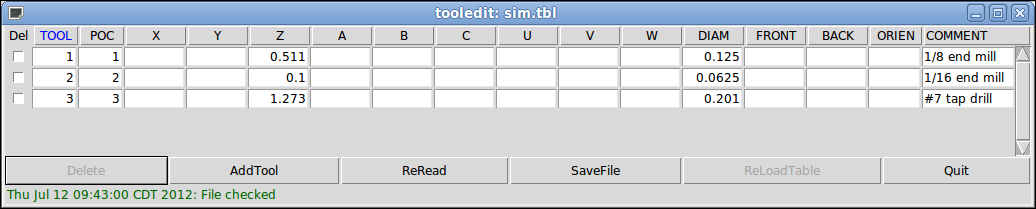

The tooledit program can update the tool table file with edited changes by using the SaveFile button. The SaveFile button updates the system file but a separate action is required to update the tool table data used by a running LinuxCNC instance. With the axis GUI, both the file and the current tool table data used by LinuxCNC can be updated with the ReloadTable button. This button is enabled only when the machine is ON and IDLE.

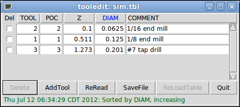

The tool table display can be sorted on any column in ascending order by clicking on the column header. A second click sorts in descending order. Column sorting requires that the machine is configured with the default tcl version >= 8.5.
images/tooledit-sort.png

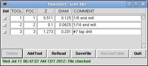

3. Column Selection
By default, the tooledit program will display all possible tool table parameter columns. Since few machines use all parameters, the columns displayed can be limited with the following ini file setting:
images/tooledit-columns.png
INI File Syntax
[DISPLAY]
TOOL_EDITOR = tooledit column_name column_name ...
Example for Z and DIAM columns
[DISPLAY]
TOOL_EDITOR = tooledit Z DIAM
