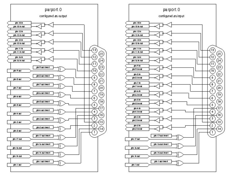

![Parport block diagram](images/parport-block-diag.png)

3. Pins
parport.<p>.pin-`__<n>__
-out` (bit) Drives a physical output pin. -
-in` (bit) Tracks a physical input pin. -
-in-not` (bit) Tracks a physical input pin, but inverted.
For each pin, <p> is the port number, and <n> is the physical pin number in the 25 pin D-shell connector.
For each physical output pin, the driver creates a single HAL pin, for example: parport.0.pin-14-out
For each physical input pin, the driver creates two HAL pins, for example: parport.0.pin-12-in
and parport.0.pin-12-in-not
The -in
HAL pin is TRUE if the physical pin is high, and FALSE if the physical pin is low.
The -in-not
HAL pin is inverted and is FALSE if the physical pin is high.
