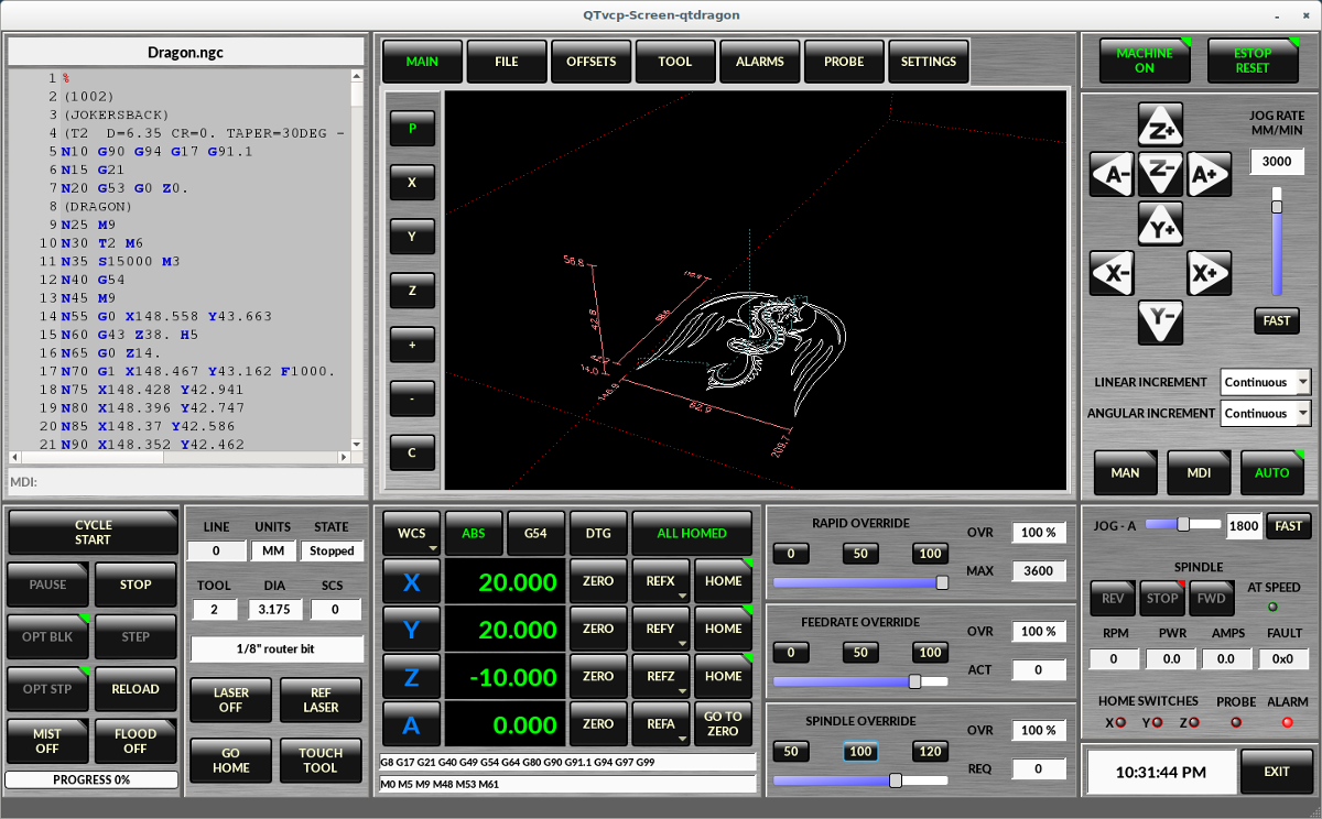

Gscreen is an infrastructure to display a custom screen to control LinuxCNC. Gscreen borrows heavily from GladeVCP. GladeVCP uses the GTK widget editor GLADE to build virtual control panels (VCP) by point and click. Gscreen combines this with Python programming to create a GUI screen for running a CNC machine.
Gscreen is customizable if you want different buttons and status LEDs. Gscreen supports GladeVCP which is used to add controls and indicators. To customize Gscreen you use the Glade editor. Gscreen is not restricted to adding a custom panel on the right or a custom tab it is fully editable.

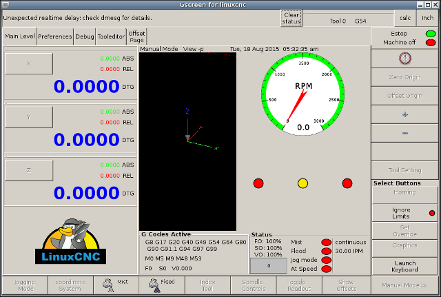

Gscreen Mill Based Screen
Figure 1. Gscreen Default Screen

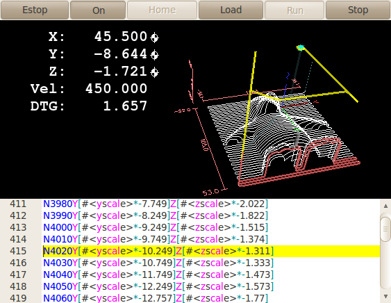

Gscreen Silverdragon Screen
Figure 2. Gscreen Silverdragon Screen

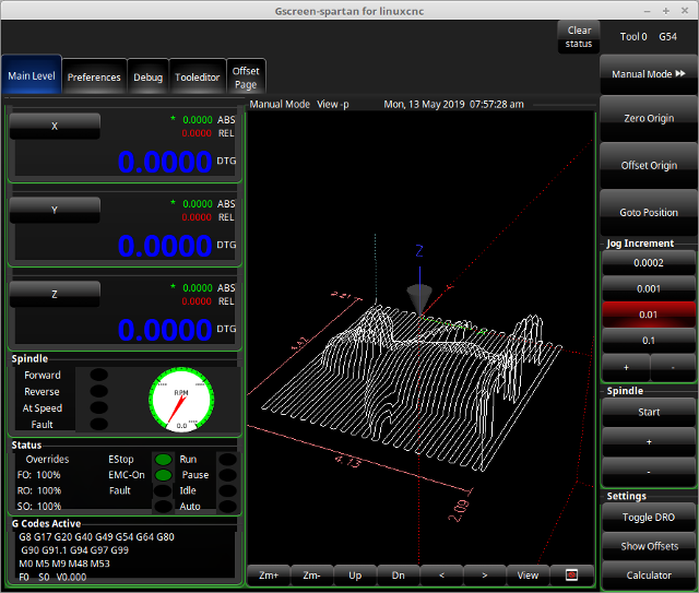

Gscreen Spartan Screen
Figure 3. Gscreen Spartan Screen

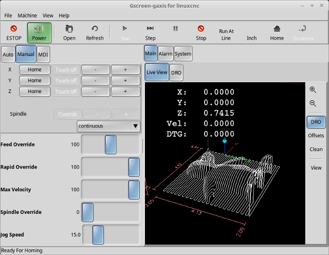

Gscreen Gaxis Screen
Figure 4. Gscreen Gaxis Screen

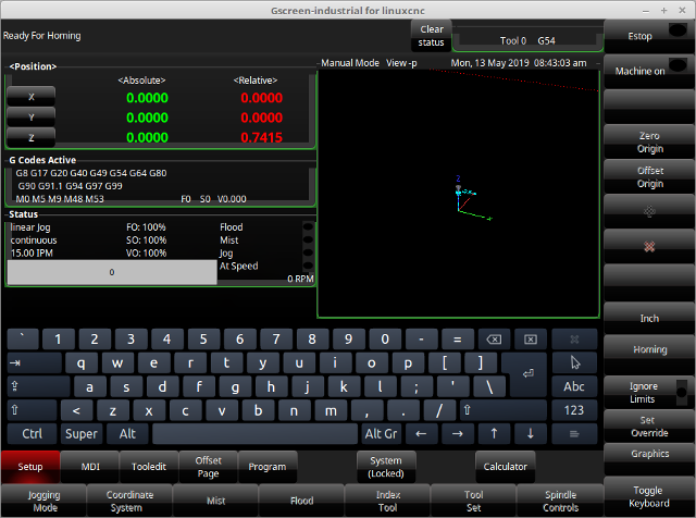

Gscreen Industrial Screen
Figure 5. Gscreen Industrial Screen
