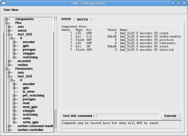

10. HAL Pins
The HAL pins for each configuration can be seen by opening up Show HAL Configuration from the Machine menu. All the HAL pins and parameters can be found there. The following figure is of the 5I20 configuration used above.

To see the exact pins and parameters that your configuration gave you, open the Show HAL
Configuration window from the Machine menu, or do dmesg
as outlined above.
