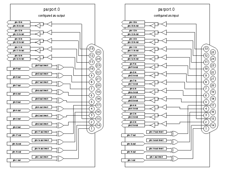

The hal_parport component is a driver for the traditional PC parallel port. The port has a total of 17 physical pins. The original parallel port divided those pins into three groups: data, control, and status. The data group consists of 8 output pins, the control group consists of 4 pins, and the status group consists of 5 input pins.
In the early 1990s, the bidirectional parallel port was introduced, which allows the data group to be used for output or input. The HAL driver supports the bidirectional port, and allows the user to set the data group as either input or output. If configured as out, a port provides a total of 12 outputs and 5 inputs. If configured as in, it provides 4 outputs and 13 inputs.

The hal_parport driver is a real time component so it must be loaded into the real time thread with loadrt. The configuration string describes the parallel ports to be used, and (optionally) their types. If the configuration string does not describe at least one port, it is an error.
loadrt hal_parport cfg="Anschluss [Typ] [Anschluss [Typ] ...]"
Numbers below 16 refer to parallel ports detected by the system. This is the simplest way to configure the hal_parport driver and cooperates with the Linux parport_pc driver if it is loaded. A port of 0 is the first parallel port detected on the system, 1 is the next and so on.
Dies wird den ersten parallelen Port verwenden, den Linux erkennt:
loadrt hal_parport cfg="0"
Stattdessen kann die Anschlussadresse in Hexadezimalschreibweise mit dem Präfix "0x" angegeben werden.
The config string represents the hexadecimal address of the port, optionally followed by a direction, all repeated for each port. The directions are in, out, or x, and determine the direction of the physical pins 2 to 9 of the D-Sub 25 connector. If the direction is not specified, the data group will by default be configured as outputs. For example:
loadrt hal_parport cfg="0x278 0x378 in 0x20A0 out"
This example installs the drivers for a port 0x0278, with pins 2 to 9 as outputs (by default, since neither in nor out is specified), a port 0x0378, with pins 2 to 9 as inputs and a 0x20A0 port, with pins 2 to 9 explicitly specified as outputs. Note that you must know the base address of the parallel ports to configure the drivers correctly. For ISA bus ports, this is usually not a problem, since the ports are almost always at a well-known address, such as 0x278 or 0x378 which are typically configured in the BIOS. The addresses of PCI bus cards are usually found with lspci -v in an I/O ports line, or in a kernel message after running sudo modprobe -a parport_pc. There is no default address, so if <config-string> does not contain at least one address, it is an error.
Für jede parallele Schnittstelle, die vom hal_parport Treiber verwaltet wird, kann optional ein Typ angegeben werden. Der Typ ist einer von in, out, epp oder x.

Wenn der Typ nicht angegeben wird, ist der Standardwert "out".
Ein Typ epp ist derselbe wie out, aber der hal_parport Treiber fordert den Port auf, in den EPP-Modus zu wechseln. Der hal_parport-Treiber benutzt nicht das EPP-Busprotokoll, aber auf einigen Systemen ändert der EPP-Modus die elektrischen Eigenschaften des Ports auf eine Weise, die einige marginale Hardware besser funktionieren lässt. Es ist bekannt, dass die Ladungspumpe des Gecko G540 dies bei einigen parallelen Anschlüssen erfordert.

3. Pins
parport.<p>.pin-`__<n>__-out` (bit) Drives a physical output pin. -
parport.<p>.pin-`__<n>__-in` (bit) Tracks a physical input pin. -
parport.<p>.pin-`__<n>__-in-not` (bit) Tracks a physical input pin, but inverted.
For each pin, <p> is the port number, and <n> is the physical pin number in the 25 pin D-shell connector.
For each physical output pin, the driver creates a single HAL pin, for example: parport.0.pin-14-out.
For each physical input pin, the driver creates two HAL pins, for example: parport.0.pin-12-in and parport.0.pin-12-in-not.
The -in HAL pin is TRUE if the physical pin is high, and FALSE if the physical pin is low. The -in-not HAL pin is inverted and is FALSE if the physical pin is high.
4. Parameter
parport.`__<p>__.pin-__<n>__-out-invert` (bit) Inverts an output pin. -
parport.`__<p>__.pin-__<n>__-out-reset` (bit) (only for-outpins) TRUE if this pin should be reset when the-resetfunction is executed. -
parport.`__<p>__.reset-time` (U32) The time (in nanoseconds) between a pin is set by-writeand reset by the-resetfunction if it is enabled.
The -invert parameter determines whether an output pin is active high or active low. If -invert is FALSE, setting the HAL -out pin TRUE drives the physical pin high, and FALSE drives it low. If -invert is TRUE, then setting the HAL -out pin TRUE will drive the physical pin low.
