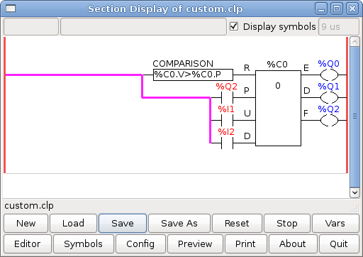

1. Wrapping Counter
To have a counter that wraps around you have to use the preset pin and the reset pin. When you create the counter set the preset at the number you wish to reach before wrapping around to 0. The logic is if the counter value is over the preset then reset the counter and if the underflow is on then set the counter value to the preset value. As you can see in the example when the counter value is greater than the counter preset the counter reset is triggered and the value is now 0. The underflow output %Q2 will set the counter value at the preset when counting backwards.
Wrapping Counter

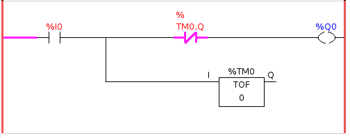

2. Reject Extra Pulses
This example shows you how to reject extra pulses from an input. Suppose the input pulse %I0 has an annoying habit of giving an extra pulse that spoils our logic. The TOF (Timer Off Delay) prevents the extra pulse from reaching our cleaned up output %Q0. How this works is when the timer gets an input the output of the timer is on for the duration of the time setting. Using a normally closed contact %TM0.Q the output of the timer blocks any further inputs from reaching our output until it times out.
Reject Extra Pulse

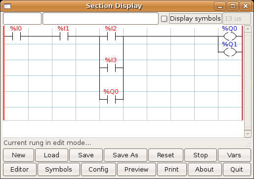

Next we run our config and build the ladder as shown here.
E-Stop Section Display
After building the ladder select Save As and save the ladder as estop.clp
Now add the following line to your custom.hal file.
# Load the ladder
loadusr classicladder --nogui estop.clp
I/O assignments
  • %I0 = Input from the PyVCP panel simulated E-Stop (the checkbox)
  • %I1 = Input from LinuxCNC’s E-Stop
  • %I2 = Input from LinuxCNC’s E-Stop Reset Pulse
  • %I3 = Input from the PyVCP panel reset button
  • %Q0 = Output to LinuxCNC to enable
  • %Q1 = Output to external driver board enable pin (use a N/C output if your board had a disable pin)

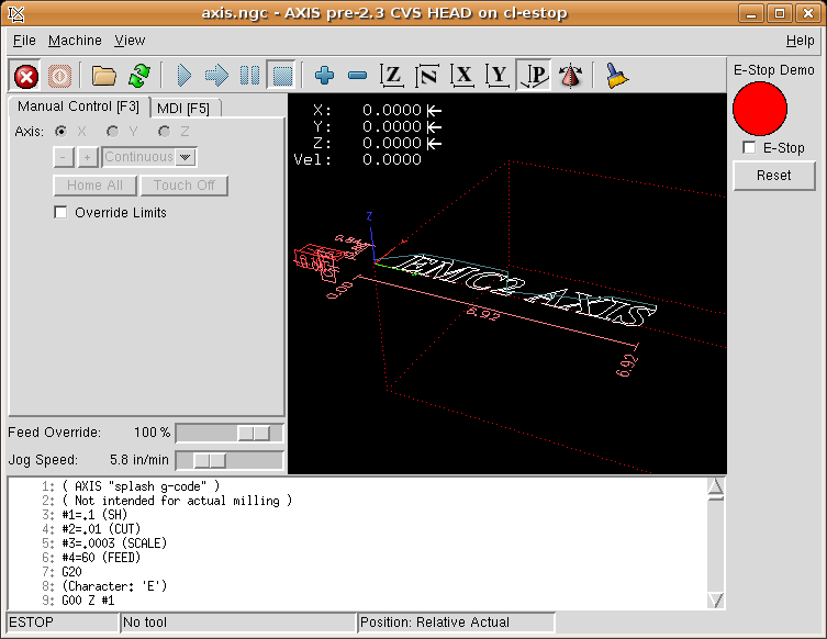

Now start up your config and it should look like this.
AXIS E-Stop
Note that in this example like in real life you must clear the remote E-Stop (simulated by the checkbox) before the AXIS E-Stop or the external Reset will put you in OFF mode. If the E-Stop in the AXIS screen was pressed, you must press it again to clear it. You cannot reset from the external after you do an E-Stop in AXIS.

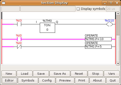

4. Timer/Operate Example
In this example we are using the Operate block to assign a value to the timer preset based on if an input is on or off.
In this case %I0 is true so the timer preset value is 10. If %I0 was false the timer preset would be 5.
