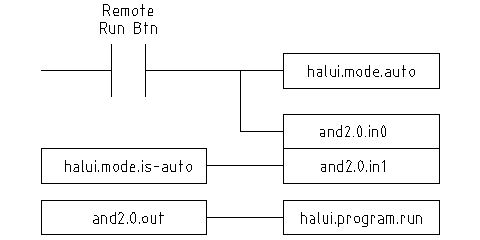

1. Remote Start
To connect a remote program start button to LinuxCNC you use the halui.program.run
pin and the halui.mode.auto
pin. You have to ensure that it is OK to run first by using the halui.mode.is-auto
pin. You do this with an and2
component. The following figure shows how this is done. When the Remote Run Button is pressed it is connected to both halui.mode.auto
and and2.0.in0
. If it is OK for auto mode the pin halui.mode.is-auto
will be on. If both the inputs to the and2.0
component are on the and2.0.out
will be on and this will start the program.
The hal commands needed to accomplish the above are:
net program-start-btn halui.mode.auto and2.0.in0 <= <your input pin> net program-run-ok and2.0.in1 <= halui.mode.is-auto net remote-program-run halui.program.run <= and2.0.out
Notice on line one that there are two reader pins, this can also be split up to two lines like this:
net program-start-btn halui.mode.auto <= <your input pin> net program-start-btn and2.0.in0
