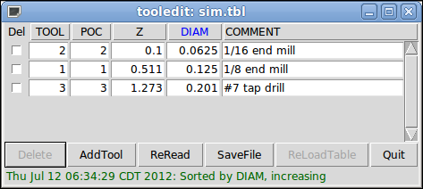

2. Column Sorting
The tool table display can be sorted on any column in ascending order by clicking on the column header. A second click sorts in descending order. Column sorting requires that the machine is configured with the default Tcl version >= 8.5.

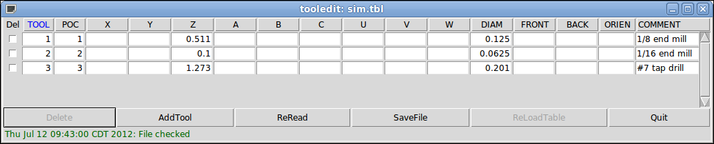

3. Columns Selection
By default, the tooledit program will display all possible tool table parameter columns. Since few machines use all parameters, the columns displayed can be limited with the following INI file setting:

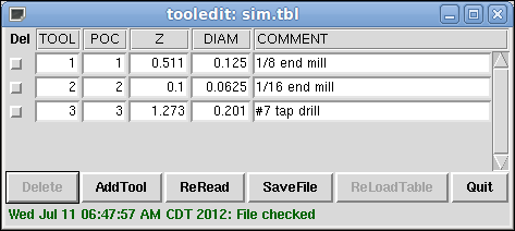

[DISPLAY] TOOL_EDITOR = tooledit column_name column_name ...
[DISPLAY] TOOL_EDITOR = tooledit Z DIAM
