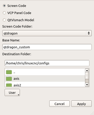

1.1. copy
Used for copying QtVCP’s builtin Screens/VCP Panels/QtVismach code to a folder so one can customize it.
In a terminal run:
qtvcp copy
QtVCP copy Dialog - Screen, Panel or Vismach Code Copy Panel

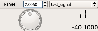

1.3. test_dial
  • This panel has a dial that adjusts S32 and Float HAL output pins.
  • The dial’s range can be adjusted from a drop down menu.
  • The output can be scaled with the spinbox.
  • A combobox can be used to automatically select and connect to a signal.
loadusr qtvcp test_dial
QtVCP test_dial Panel - Test Dial VCP

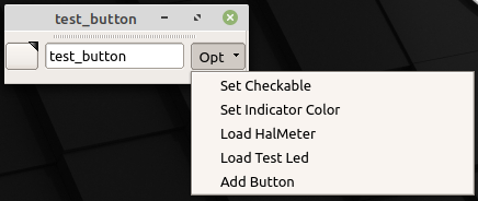

1.4. test_button
  • This panel has a button that will set a HAL pin.
  • The button can be selected as a momentary or a toggle button.
  • A HAL pin will be created that follows the button state
  • The button’s indicator color can be adjusted from a drop down menu.
  • A HAL pin or signal can be selected to follow the button state
  • You can add more buttons from the drop down menu.
  • You can load a Halmeter from the drop down menu.
  • You can load a test LED from the drop down menu.
  • The button can be detached from the main windows.
Here is how to load test_button from a HAL script:
loadusr qtvcp test_button
loadusr qtvcp -o 4 test_button
The -o switch sets how many buttons the panel starts with.
If loading directly from a terminal omit the loadusr.
QtVCP test_button - Test Button VCP

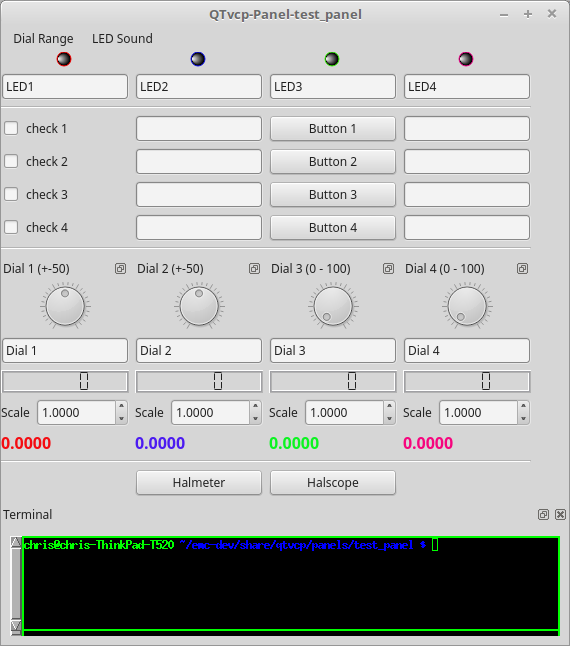

1.6. test_panel
Collection of useful widgets for testing HAL component, including speech of LED state.
loadusr qtvcp test_panel
QtVCP test_panel - HAL Component Testing Panel

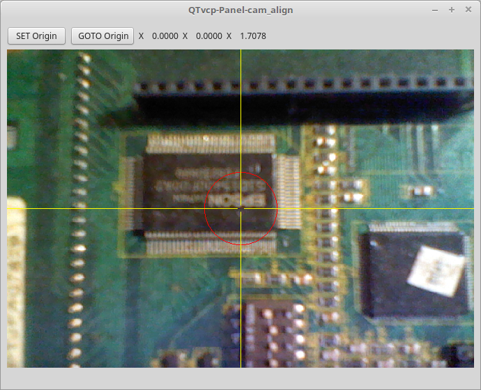

1.7. cam_align
A camera display widget for rotational alignment.
QtVCP cam_align Panel - Camera Based Alignment Panel
Kullanım
Add these lines to the INI file:
[DISPLAY]
EMBED_TAB_NAME = cam_align
EMBED_TAB_COMMAND = halcmd loadusr -Wn qtvcp_embed qtvcp -d -c qtvcp_embed -x {XID} cam_align
# The following line is needed if embedding in GMOCCAPY
All <options> must appear before the cam_align panel name.
Qtvcp Options
  • -c NAME HAL component name. Default is to use the UI file name.
  • -d Debugging on. or remove for no minimum output
  • -x {XID} used for embedding into AXIS or Gmoccapy
  • -o <option> Options passed to cam_align
Cam_align Options
  • size=400,400 Size of the embedded window (width,height)
  • imagesize=300,300 Size of the image inside the window (width,height)
  • rotincr=5 Sets the increment of the crosshair rotation. (degrees)
  • xscale=100 Scales the image in X. A negative value will flip the image in X (percent)
  • yscale=100 Scales the image in Y. A negative value will flip the image in Y (percent)
  • camnumber=1 Sets what system camera to use
For instance you can add window width and height size, rotation increment, and camera number from the INI with -o options.
EMBED_TAB_COMMAND = halcmd loadusr -Wn qtvcp_embed qtvcp -d -c qtvcp_embed -x {XID} -o size=400,400 -o rotincr=.2 -o camnumber=0 cam_align
Mouse controls:
  • left mouse single click - increase cross hair rotation one increment
  • right mouse single click - decrease cross hair rotation one increment
  • middle mouse single click - cycle through rotation increments
  • left mouse hold and scroll - scroll camera zoom
  • right mouse hold and scroll - scroll cross hair rotation angle
  • mouse scroll only - scroll circle diameter
  • left mouse double click - reset zoom
  • right mouse double click - reset rotation
  • middle mouse double click - reset circle diameter
To use the top buttons you have to assign a command (or a sub-routine). This could look like this:
[MDI_COMMAND_LIST]
MDI_COMMAND_CAM_ALIGN1=G10 L20 P1 X0 Y0,Set XY\nOrigin
MDI_COMMAND_CAM_ALIGN2=G0 X0 Y0,Go To\nOrigin
Where the first command is referring to the button "SET origin" and the second to the button "GOTO Origin".
Note the comma and text after is optional - it will override the default button text.
These buttons are QtVCP action buttons and follow those rules.

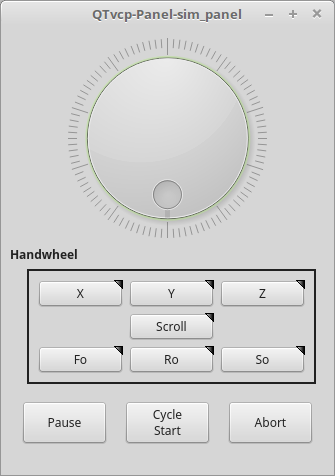

1.8. sim_panel
Small control panel to simulate MPG jogging controls etc for simulated configurations.
The MPG, selection buttons and control buttons export HAL pins to connect to linuxcnc.
The selection and control group boxes can be hidden if not needed by using the -o hide= option.
groupBoxControl and groupBoxSelection are the widget names that can be hidden.
If you want to hide both, use a comma between them with no spaces.
The -a option will make the panel always-on-top of all windows.
loadusr qtvcp sim_panel
Here we load the panel with no MPG selection buttons and the always-on-top option.
loadusr qtvcp -a -o hide=groupBoxSelection sim_panel
QtVCP sim_panel - Simulated Controls Panel For Screen Testing

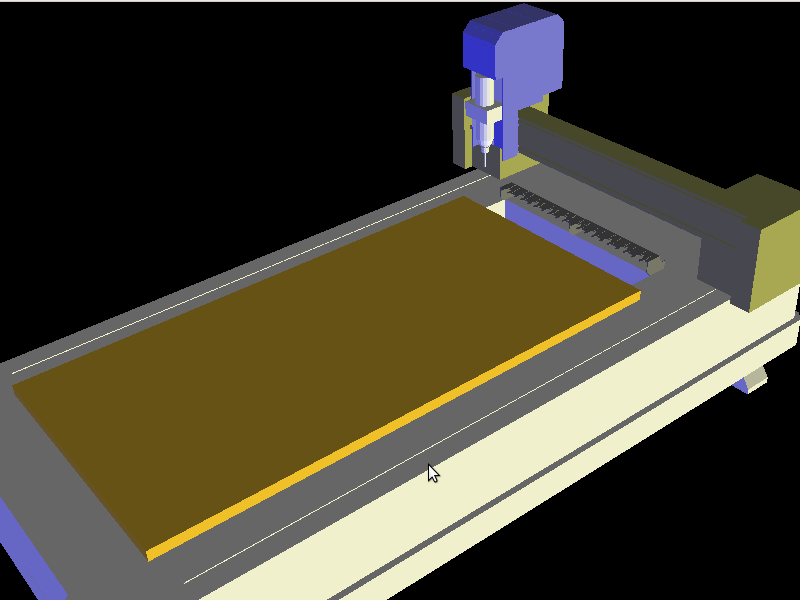

2.2. QtVCP vismach_router_atc
3D OpenGL view of a 3-Axis router style, gantry bed milling machine.
This particular panel shows how to define and connect the model parts in the handler file, rather then importing the pre-built model from QtVCP’s vismach library.
loadusr qtvcp vismach_router_atc
QtVCP vismach_router_atc - 3-Axis Gantry Bed Mill 3D View Panel

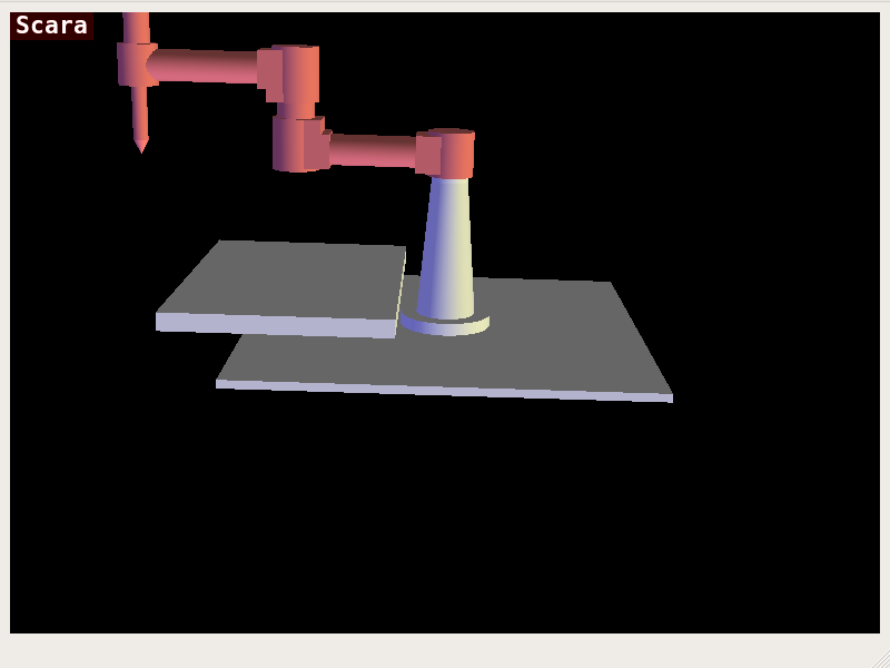

2.3. QtVCP vismach_scara
3D OpenGL view of a SCARA based milling machine.
loadusr qtvcp vismach_scara
QtVCP vismach_scara - SCARA Mill 3D View Panel

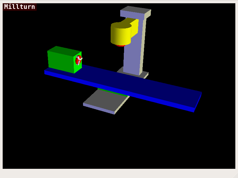

2.4. QtVCP vismach_millturn
3D OpenGL view of a 3-Axis milling machine with an A axis/spindle.
loadusr qtvcp vismach_millturn
QtVCP vismach_millturn - 4 Axis MillTurn 3D View Panel

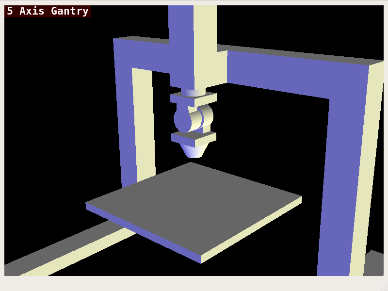

2.5. QtVCP vismach_mill_5axis_gantry
3D OpenGL view of a 5-Axis gantry type milling machine.
loadusr qtvcp vismach_mill_5axis_gantry
QtVCP vismach_mill_5axis_gantry - 5-Axis Gantry Mill 3D View Panel

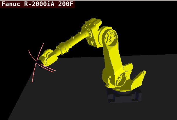

2.6. QtVCP vismach_fanuc_200f
3D openGL view of a 6 joint robotic arm.
loadusr qtvcp vismach_fanuc_200f
QtVCP vismach_fanuc_200f - 6 Joint Robotic Arm
