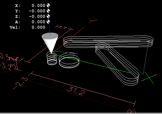

1. Mill Examples
1.1. Helical Hole Milling
File Name: useful-subroutines.ngc
Description: Subroutine for milling a hole using parameters.
1.2. Slotting
Description: Subroutine for milling a slot using parameters.

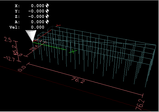

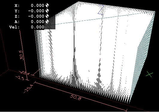

1.3. Grid Probe
File Name: gridprobe.ngc
Description: Rectangular Probing
This program repeatedly probes in a regular XY grid and writes the probed location to the file probe-results.txt in the same directory as the .ini file.
1.4. Smart Probe
File Name: smartprobe.ngc
This program repeatedly probes in a regular XY grid and writes the probed location to the file probe-results.txt in the same directory as the .ini file. This is improved from the grid probe file.
