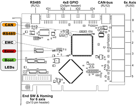

The following connectors can be found on the GM6-PCI card:
GM6-PCI card connectors and LEDs
1. I/O connectors
Pin numbering of GPIO connectors

2. Axis connectors
Pin numbering of axis connectors
1
Encoder A
2
+5 Volt (PC)
3
Encoder B
4
Encoder Index
5
Fault
6
Power Enabled
7
Step/CCW/B
8
Direction/CW/A
9
Ground (PC)
10
DAC serial line

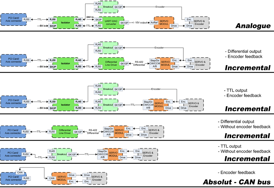

2.1. Axis interface modules
Small sized DIN rail mounted interface modules gives easy way of connecting different types of servo modules to the axis connectors. Seven different system configurations are presented in the System integration manual for evaluating typical applications. Also the detailed description of the Axis modules can be found in the System integration manual.
For evaluating the appropriate servo-drive structure the modules have to be connected as the following block diagram shows:
Servo axis interfaces

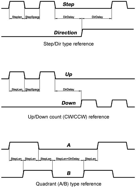

.steplen
(u32, R/W)
Length of step pulse in nano-seconds.
.stepspace
(u32, R/W)
Minimum time between two step pulses in nano-seconds.
.dirdelay
(u32, R/W)
Minimum time between step pulse and direction change in nanoseconds.
For evaluating the appropriate values see the timing diagrams below:
Reference signal timing diagrams
Setting StepGen module of axis 0 to generate 1000 step pulse per position unit
setp gm.0.stepgen.0.step-type 0         # 0:stepDir, 1:UpDown, 2:Quad
setp gm.0.stepgen.0.control-type 0      # 0:Pos. control, 1:Vel. Control
setp gm.0.stepgen.0.invert-step1 0
setp gm.0.stepgen.0.invert-step2 0
setp gm.0.stepgen.0.maxvel 0            # do not set maxvel for step
                                        # generator, let interpolator control it.
setp gm.0.stepgen.0.maxaccel 0          # do not set max acceleration for
                                        # step generator, let interpolator control it.
setp gm.0.stepgen.0.position-scale 1000 # 1000 step/position unit
setp gm.0.stepgen.0.steplen 1000        # 1000 ns = 1 µs
setp gm.0.stepgen.0.stepspace1000       # 1000 ns = 1 µs
setp gm.0.stepgen.0.dirdelay 2000       # 2000 ns = 2 µs
Connect StepGen to axis 0 position reference and enable pins

5. End-, homing- and E-stop switches
Pin numbering of homing and end switch connector
25 23 21 19 17 15 13 11 9 7 5 3 1
GND
1/End-
2/End+
2/Hom-ing
3/End-
4/End+
4/Hom-ing
5/End-
6/End+
6/Hom-ing
E-Stop 2
V+ (Ext.)
26 24 22 20 18 16 14 12 10 8 6 4 2
GND
1/End+
1/Hom-ing
2/End-
3/End+
3/Hom-ing
4/End-
5/End+
5/Hom-ing
6/End-
E-Stop 1
V+ (Ext.)

6. Status LEDs
6.1. CAN
Color: Orange
  • Blink, during data communication.
  • On, when any of the buffers are full - communication error.
  • Off, when no data communication.
6.2. RS485
Color: Orange
  • Blink, during initialization of modules on the bus
  • On, when the data communication is up between all initialized modules.
  • Off, when any of the initialized modules dropped off because of an error.
6.3. EMC
Color: White
  • Blink, when LinuxCNC is running.
  • Otherwise off.
6.4. Boot
Color: Green
  • On, when system booted successfully.
  • Otherwise off.
6.5. Error
Color: Red
  • Off, when there is no fault in the system.
  • Blink, when PCI communication error.
  • On, when watchdog timer overflowed.

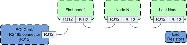

Connecting the nodes
The modules on the bus have to be connected in serial topology, with termination resistors on the end. The start of the topology is the PCI card, and the end is the last module.
Connecting the RS485 nodes to the GM6-PCI card
