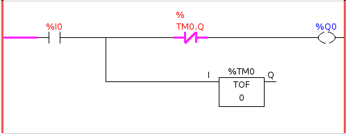

2. Reject Extra Pulses
This example shows you how to reject extra pulses from an input. Suppose the input pulse %I0 has an annoying habit of giving an extra pulse that spoils our logic. The TOF (Timer Off Delay) prevents the extra pulse from reaching our cleaned up output %Q0. How this works is when the timer gets an input the output of the timer is on for the duration of the time setting. Using a normally closed contact %TM0.Q the output of the timer blocks any further inputs from reaching our output until it times out.
Reject Extra Pulse
Figur 2. Reject Extra Pulse

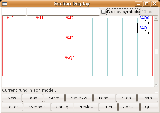

3. External E-Stop
The External E-Stop example is in the /config/classicladder/cl-estop folder. It uses a PyVCP panel to simulate the external components.
To interface an external E-Stop to LinuxCNC and have the external E-Stop work together with the internal E-Stop requires a couple of connections through ClassicLadder.
First we have to open the E-Stop loop in the main HAL file by commenting out by adding the pound sign as shown or removing the following lines.
# net estop-out <= iocontrol.0.user-enable-out
# net estop-out => iocontrol.0.emc-enable-in
Next we add ClassicLadder to our custom.hal file by adding these two lines:
loadrt classicladder_rt
Next we run our config and build the ladder as shown here.
E-Stop Section Display
Figur 3. E-Stop Section Display
After building the ladder select Save As and save the ladder as estop.clp
Now add the following line to your custom.hal file.
# Load the ladder
loadusr classicladder --nogui estop.clp
I/O assignments
  • %I0 = Input from the PyVCP panel simulated E-Stop (the checkbox)
  • %I1 = Input from LinuxCNC’s E-Stop
  • %I2 = Input from LinuxCNC’s E-Stop Reset Pulse
  • %I3 = Input from the PyVCP panel reset button
  • %Q0 = Output to LinuxCNC to enable
  • %Q1 = Output to external driver board enable pin (use a N/C output if your board had a disable pin)

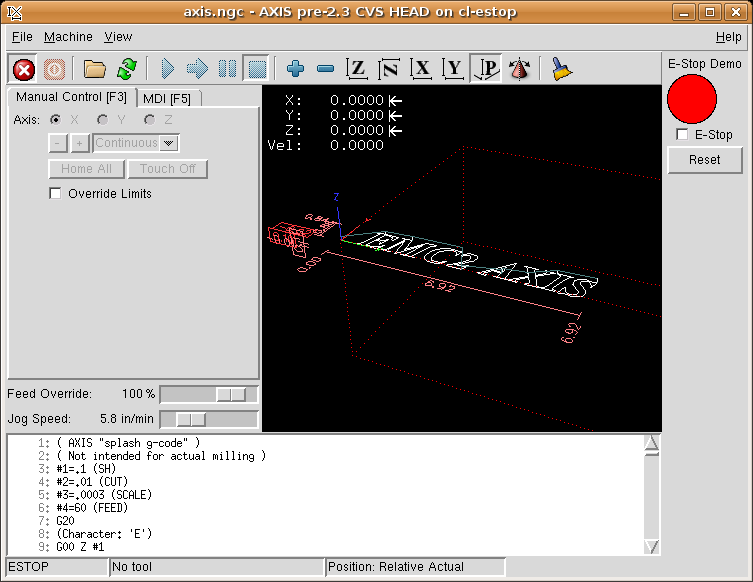

Now start up your config and it should look like this.
AXIS E-Stop
Figur 4. AXIS E-Stop
Note that in this example like in real life you must clear the remote E-Stop (simulated by the checkbox) before the AXIS E-Stop or the external Reset will put you in OFF mode. If the E-Stop in the AXIS screen was pressed, you must press it again to clear it. You cannot reset from the external after you do an E-Stop in AXIS.

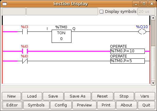

4. Timer/Operate Example
In this example we are using the Operate block to assign a value to the timer preset based on if an input is on or off.
Figur 5. Timer/Operate Example
In this case %I0 is true so the timer preset value is 10. If %I0 was false the timer preset would be 5.
