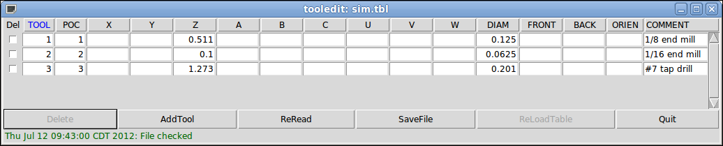

1. Overview
Not
The tooledit elements described here are available since version 2.5.1 and later. In version 2.5.0, the graphical interface interface does not allow these adjustments.
Tool Edit GUI - Overview
Figur 1. Tool Edit GUI - Overview
The tooledit program can update the tool table file with edited changes by using the SaveFile button. The SaveFile button updates the system file but a separate action is required to update the tool table data used by a running LinuxCNC instance. With the AXIS GUI, both the file and the current tool table data used by LinuxCNC can be updated with the ReloadTable button. This button is enabled only when the machine is ON and IDLE.

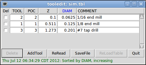

2. Column Sorting
The tool table display can be sorted on any column in ascending order by clicking on the column header. A second click sorts in descending order. Column sorting requires that the machine is configured with the default Tcl version >= 8.5.
Tool Edit GUI - Column Sorting
Figur 2. Tool Edit GUI - Column Sorting

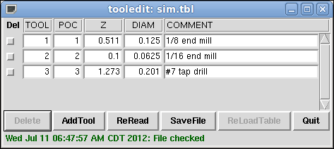

3. Columns Selection
By default, the tooledit program will display all possible tool table parameter columns. Since few machines use all parameters, the columns displayed can be limited with the following INI file setting:
Syntax of INI file
[DISPLAY]
TOOL_EDITOR = tooledit column_name column_name ...
Example for Z and DIAM columns
[DISPLAY]
TOOL_EDITOR = tooledit Z DIAM
Tool Edit GUI - Columns Selection Example
Figur 3. Tool Edit GUI - Columns Selection Example
