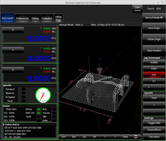

Gscreen Spartan Screen
Figur 3. Gscreen Spartan Screen

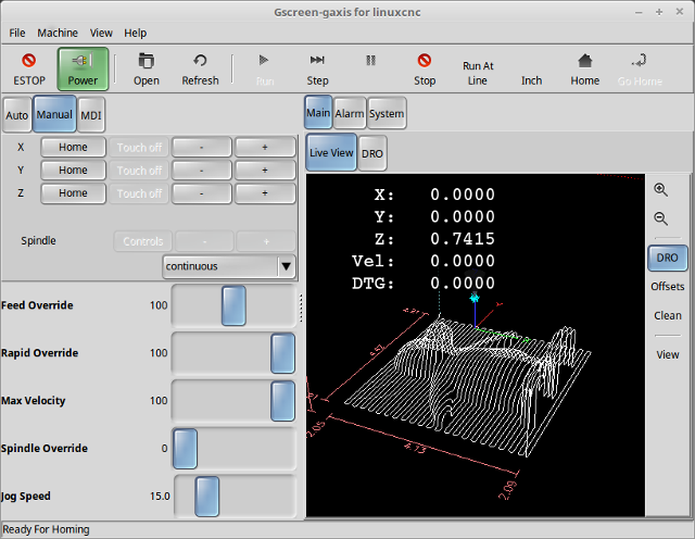

Gscreen Gaxis Screen
Figur 4. Gscreen Gaxis Screen

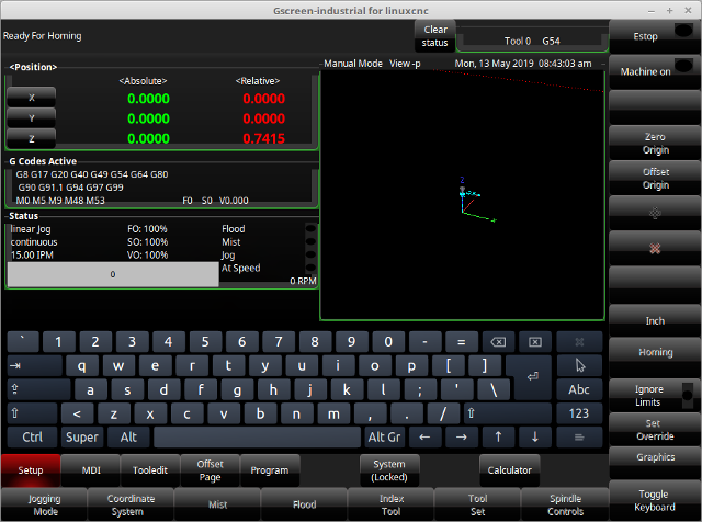

Gscreen Industrial Screen
Figur 5. Gscreen Industrial Screen

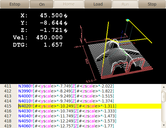

3. Building a simple clean-sheet custom screen
Gscreen simple usable screen

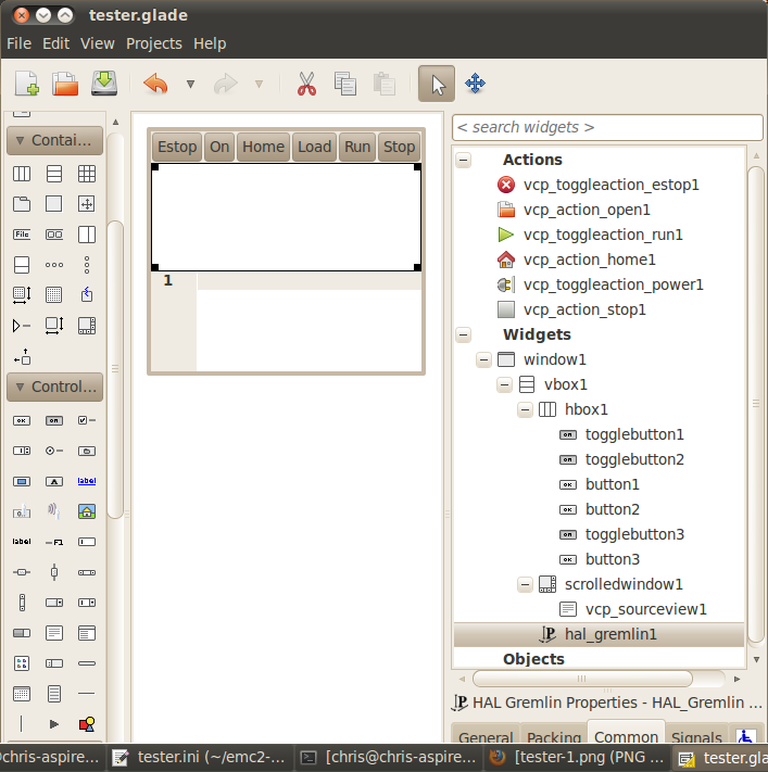

Lets build a simple usable screen. Build this in the Glade editor (if using a RIP package run it from a terminal after using . scripts/rip-environment ).
Things to note:
  • The top level window must be called the default name, window1 - Gscreen relies on this.
  • Add actions by right clicking, and selecting add as toplevel widget they don’t add anything visual to the window but are added to the right most action list. Add all the ones you see on the top right.
  • After adding the actions we must link the buttons to the actions for them to work (see below).
  • The gremlin widget doesn’t have a default size so setting a requested size is helpful (see below).
  • The sourceview widget will try to use the whole window so adding it to a scrolled window will cover this. (This is already done in the example.)
  • The buttons will expand as the window is made larger which is ugly so we will set the box they are in, to not expand (see below).
  • The button types to use depend on the VCP_action used -eg vcp_toggle_action usually require toggle buttons (Follow the example for now).
  • The buttons in this example are regular buttons not HAL buttons. We don’t need the HAL pins.
Glade editor tester.glade
In this screen we are using VCP_actions to communicate to LinuxCNC the actions we want. This allows us standard functions without adding Python code in the handler file. Let’s link the estop toggle button to the estop action Select the estop toggle button and under the general tab look for Related Action and click the button beside it. Now select the toggle estop action. Now the button will toggle estop on and off when clicked. Under the general tab you can change the text of the button’s label to describe its function. Do this for all the buttons.
Select the gremlin widget click the common tab and set the requested height to 100 and click the checkbox beside it.
Click the horizontal box that holds the buttons. Click the packing tab and click expand to No.
Save it as tester.glade and save it in sim/gscreen/gscreen_custom/ folder. Now launch LinuxCNC and click to sim/gscreen/gscreen_custom/tester and start it. If all goes well our screen will pop up and the buttons will do their job. This works because the tester.ini tells gscreen to look for and load tester.glade and tester_handler.py. The tester_handler.py file is included in that folder and is coded just show the screen and not much else. Since the special widgets directly communicate with LinuxCNC you can still do useful things. If your screen needs are covered by the available special widgets then this is as far as you need to go to build a screen. If you want something more there are still many tricks available from just adding function calls to get canned behaviour. To coding your own Python code to customize exactly what you want. But that means learning about handler files.
